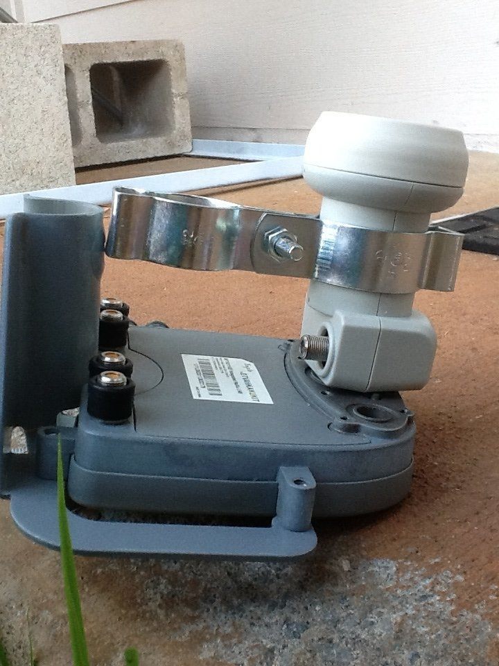

I took off the DTV three LNBs front housing. The DTV LNB housing is the same length as the GeoSat Pro LNB. So my target is to build a bracket to keep the GeoSat in this position. Just below the GeoLNB in this pic is a bolt which I can create the conduit hanger clamps to keep this lined up with the middle hole behind it.

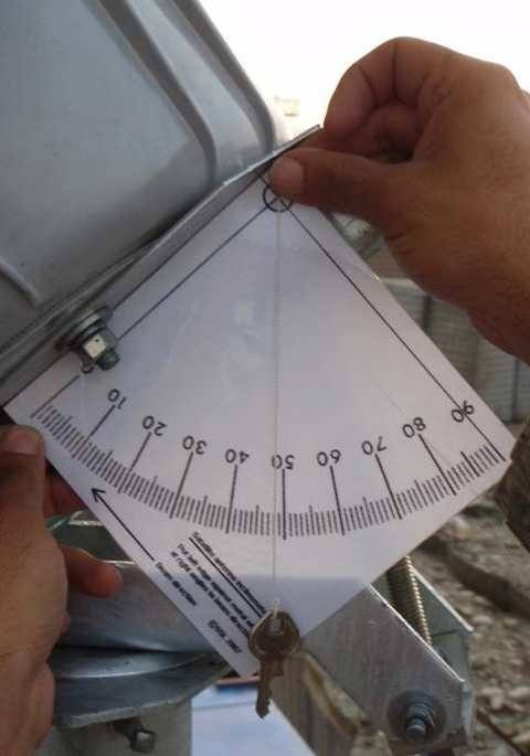

I finally got everything set up to receive Galaxy 19 -97west. I skewed the dish rather than LNB since it has a measure on the back -66. The elevation (18.6) was done with a sears protractor placed on the back (plastic hump with skew numbers on it see picture below). Used android phone compass (104) and satellite finder. I added a satellite meter in the line to receiver. Moving dish around, the meter found a satellite. After doing fine adjustments for strongest signal, took meter out. Sadly, MicroHD did not get a signal except that the LNB is attached and working. I got creative and added neighboring satellites. Just in case I got a different satellite. When clicked through the satellites, a momentary signal (about 2seconds) came through for Galaxy 16 -99west.
I think my problem is complicated by LNB holder may not be best placement, since this is a modified DT dish. Did I use correct way to measure elevation? Why is cheap meter so sensitive but MicroHD not?
Any suggestions? Thank you

Wow! Sounds like success to me. ;)
Show us a few pictures of your LNBF mounting.
Like to see what you came up with.
If your LNBF is at the same place and angle like I mentioned before, you should be good.
Now if you want to choose a poor channel (low Q), then try moving the LNBF slightly toward or away from the dish, you might squeeze out a little more.
Same for skew by twisting the LNBF.
On a channel with a high Quality reading, you probably won't see any improvement.
Yes, twisting the dish for skew was probably best - just talking about fine tuning.

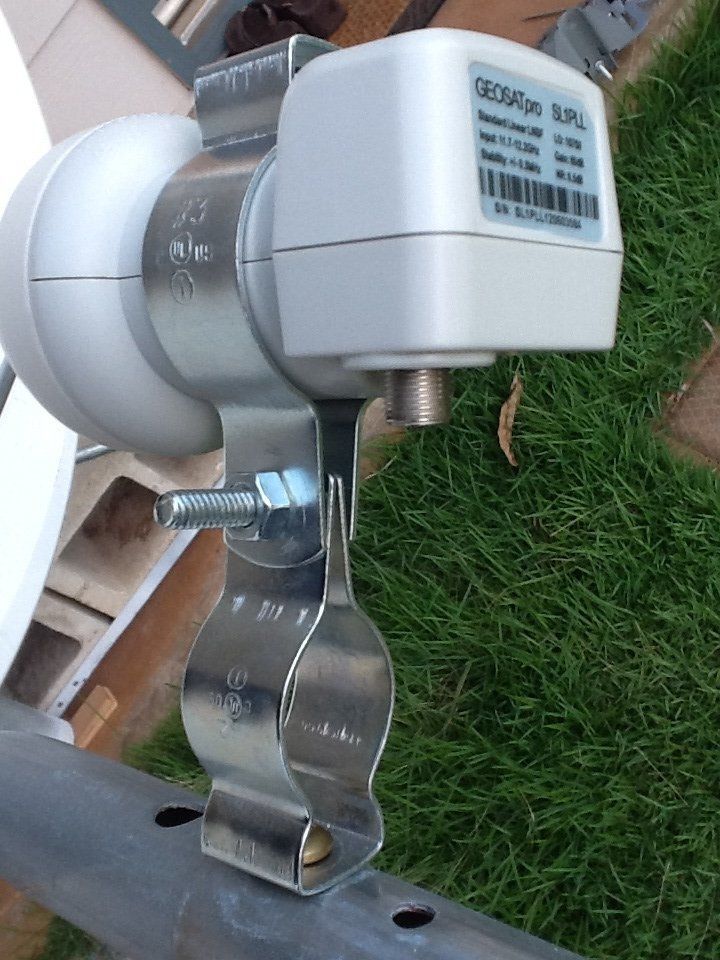

Thank you for swift response and encouragement Anole. LNB is attached with #2 and #3 (Home Depot) since it allowed movement without having to cut or grind edge. I do need to add a spacer. It is very solid - thx for steering in that direction.
Those conduit hanger brackets may not suit everyone, every time, but they ARE easy to get locally and experiment with.
You can adjust LNBF height by using larger or smaller bottom bracket, and fine tune by squeezing or spreading it! :)
Double check that the LNBF looks at the same spot on the dish as original feedhorn.
(had a feeling yours might be aimed a little low)
If you do change it, ya might need to adjust the dish to restore your signal.
Use the weak signal (low Q) trick described above.
