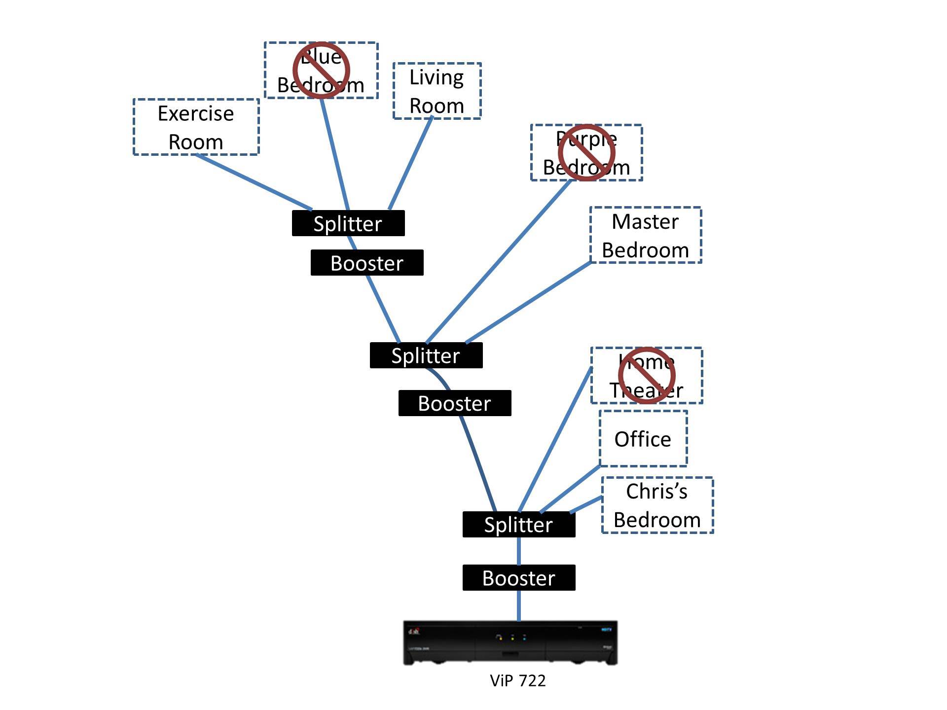

Would this diagram of the wiring in my house make sense to a Dish installer?
Two cables from the dish to the node. One cable off the node to a tap. One line off tap to the hopper. Other line off the tap to a splitter to feed the other rooms(joeys)
That's a lot of boosters. Are you sure they're needed? Distro amps?

Your wiring will have to be reconfigured. Each Hopper will need a direct line to the node, the second one can't be fed off the first like your diagram shows. Also I have no idea how the boosters will affect the MOCA, they may all need to be removed.
