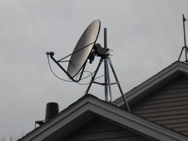

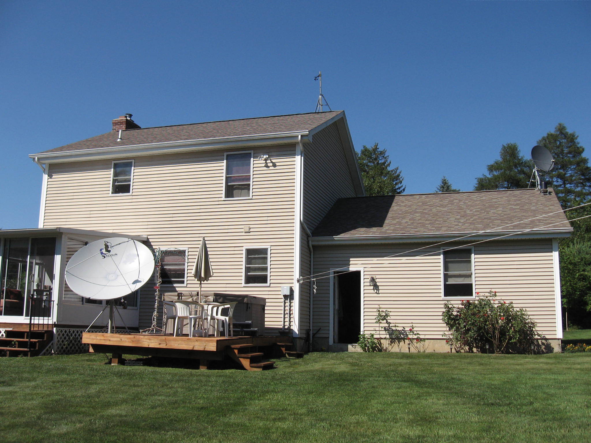

Sounds like your doing ok! I was in the same boat that your in now about 4 yrs ago.I started out with a motorized ku package deal from Sadoun and did mount mine on my garage roof! see Pic.If your doing this alone be prepared for frequent trips to the roof until dish and motor are correctly aligned :(..When you get that first satellite station it will seem well worth it!i know it was for me :clapping.I got hooked quick and shortly expanded to a 6ft cband motorized system for my back deck !Im one of those who couldn't go with a larger dish without breaking the peace;). Dont let those who say you should have a 10 footer or bigger scare you off! With a 6 footer you will get plenty of c band stations.DO your homework on FTA system setups and what you don't understand a great crowd here will be most happy to help.View attachment 98242

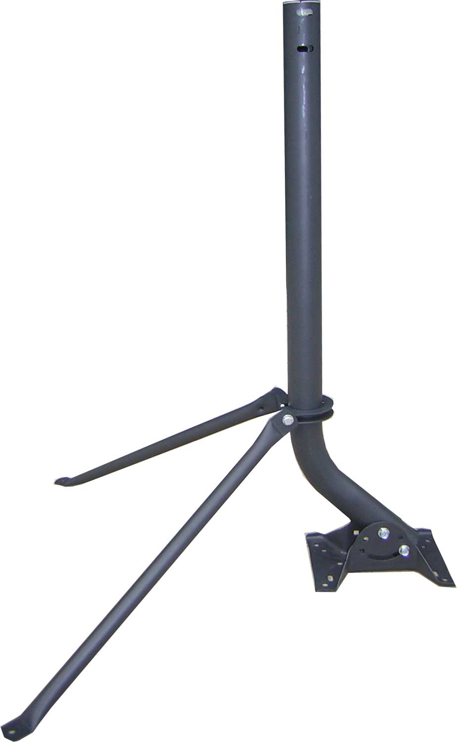

The tall J-post and support legs that are provided with the GEOSATpro 90cm should be fine for mounting the motor and 90cm. I have mount dozens of motors on included the GEOSATpro mount. No need to buy a tripod mount.

The GEOSATpro 90cm has a potential vertical tube height of 27" if assembling for height and 24" if assembling for reach. This is assembled for vertical reach with the "J" angle at the bottom.

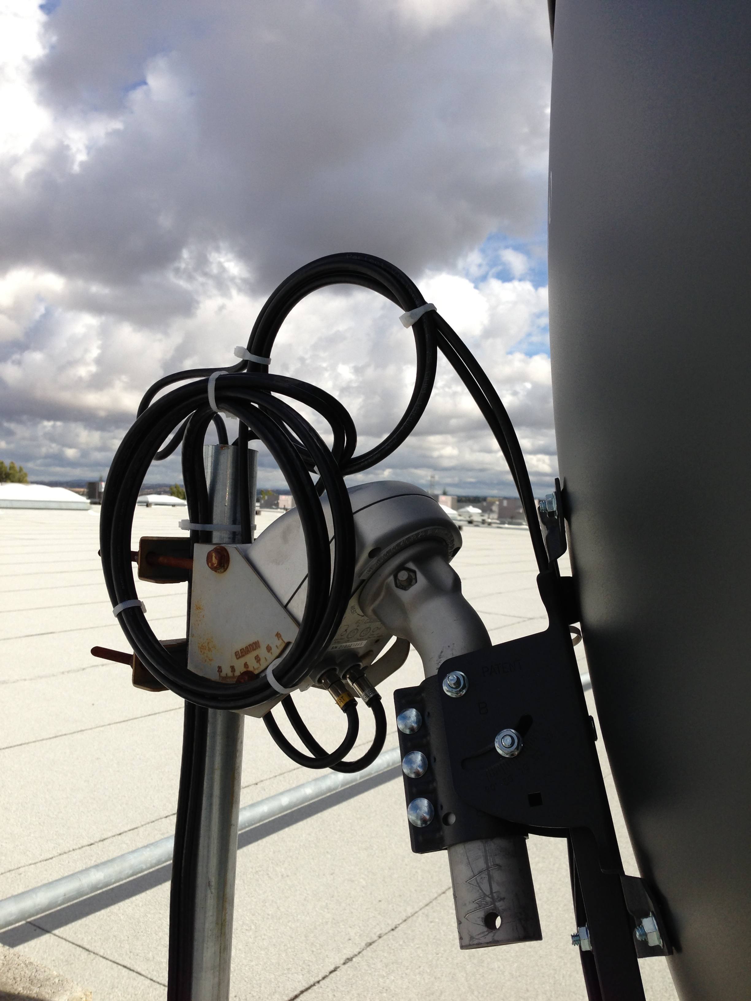

This image shows how much drop a typical HH motor creates to the dish height.

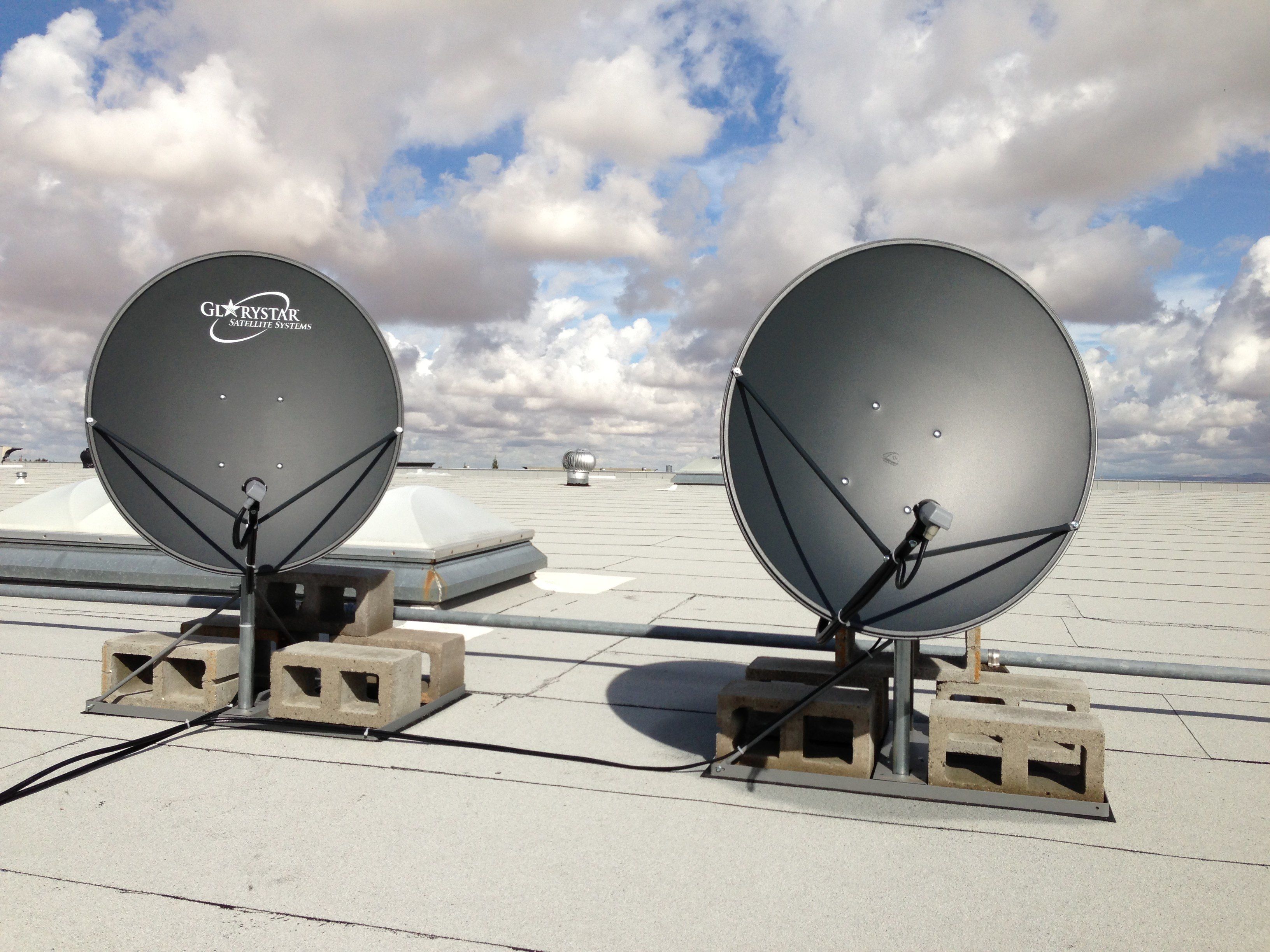

Both dishes are GEOSATpro 90cm. The dish on the left is fixed mounted on a 36" post, the dish on the right is motorized on a 36" post (4" from top of post).

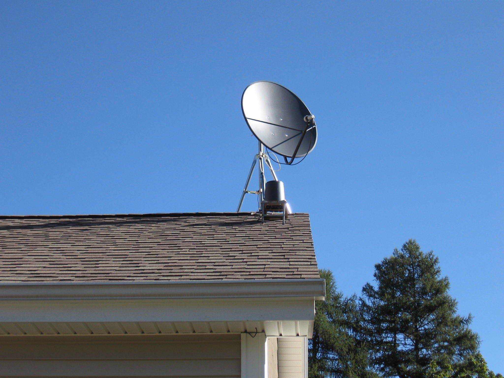

Sorry I was incorrect in my last post! My dish didn't bottom out unto the roof but did hit the lower tripod legs when I moved my dish to the extreme left and right lower satellites. I did put my dish and motor higher on the pole to solve that problem.The j pole may still be ok with your set up but make sure of clearance to the bottom when motor drives dish to left and right extremes.Heres a pic of mine when I had it to low on the pole and after correction.PS My dish is same size as the one your getting.
