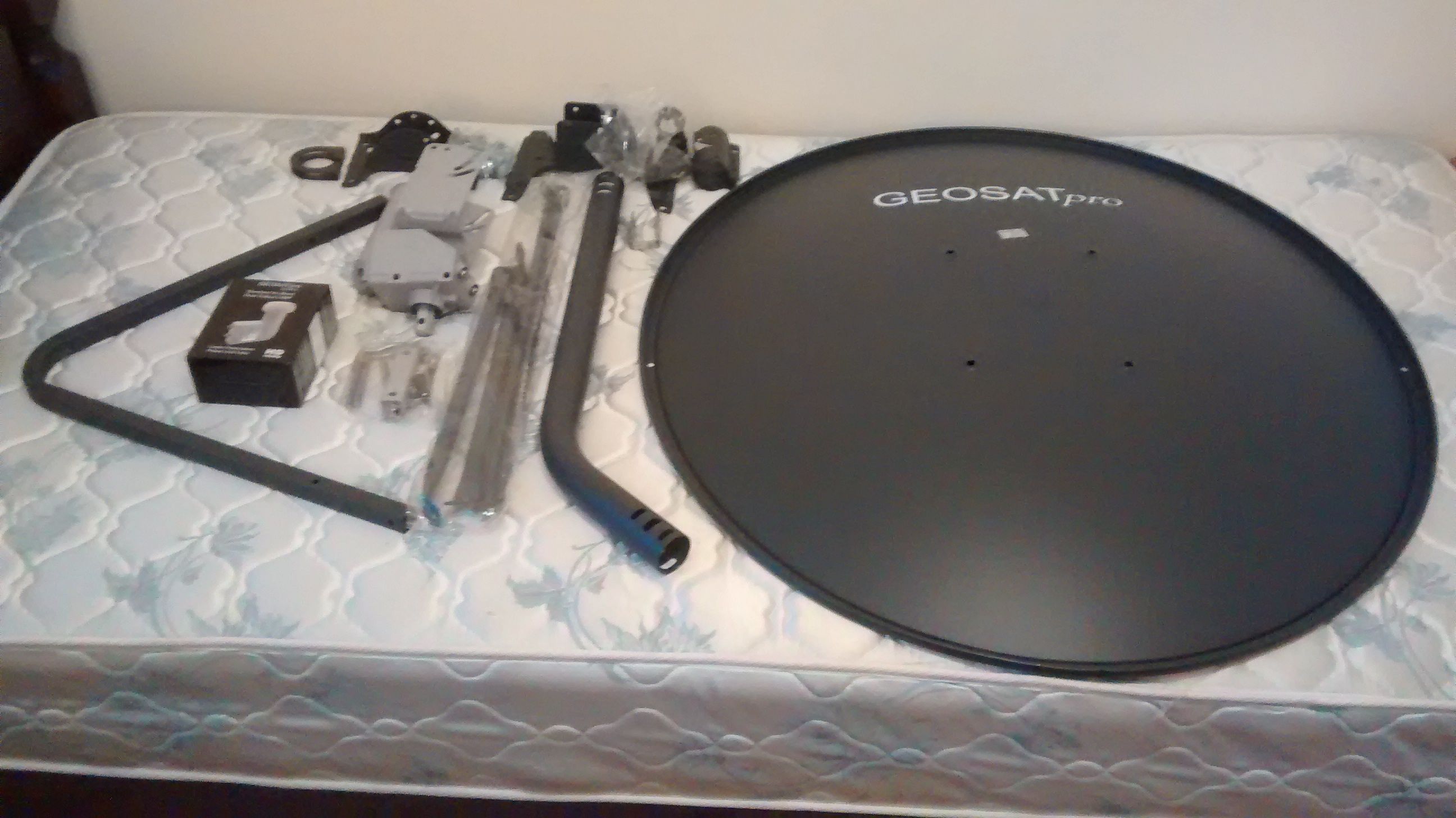

I just remembered that the last STAB model HH90 that I saw did not have a centering hole in the tube. Mounting a GEOSATpro 90cm will be a challenge if there is not centering hole as the dish mast clamp requires a pass-through bolt.
I don't have a Stab HH90 on hand. Does anyone know if the current shipped model is shipping with the centering hole? If not, is the tube magnesium cast? Need to know before trying to drill! :eeek
Interesting about the centering hole is that its on my Stab 90HH yet the install manual and all the ads do not show the hole.
My HH90 should be arriving this week. Hopefully it has a centering hole on the tube. *crosses fingers* :)
My Stab HH90 was purchased in March of this year, if my memory serves correctly. It had the hole in the tube, so the OP should be OK. The only thing is that you have amend the assembly procedure and put the tube into the dish mount first and then put the dish and tube onto the Stab HH90 motor. Nothing is heavy, so it is really easy to accomplish.

The last one I purchased, last fall has the hole.
Very good point bpalone. I'm sure he would have figured that out on his own, but it is nice to have a heads up. For sure yes, put the tube in the dish first and then lift the whole assembly up and slide it in.

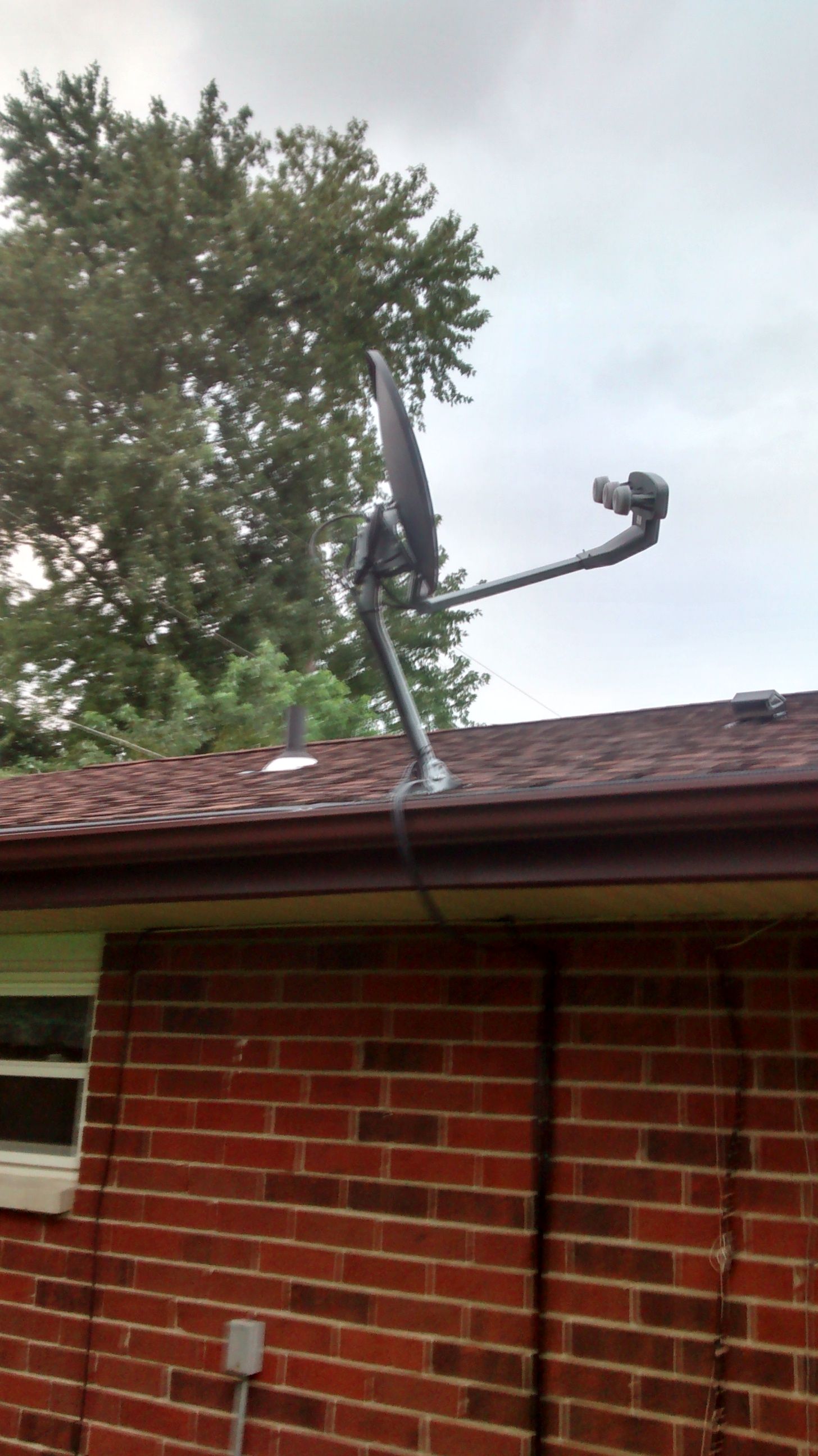

Okay, so it's been quite a while since I've posted on here. I have all my equipment now (at least I hope so). :) I have a question regarding mounting the Geosatpro 36" dish on my roof and have attached a couple of photos. Will I be able to use the mount to attach both the rotor and the dish? And the other question is, will I be able to take out my old dish setup and put the new dish setup in its place? That way I can just use the existing RG6 cables.

The existing J-pole (post) may not tall enough to allow the motor mounting and the dish to clear the roof pitch (angle). This depends on what direction is South and the pitch of the roof. You probably will need to use the mast assembly that was provided with the dish. It is taller than a Dish Network post.
Also must install the 2 support legs and lag them into into a solid backing. Roof sheeting is not a good mounting surface. Either lag into the rafters or place 2x4/2x6 backing plates underneath the sheeting. This is critical for stability and reliable tracking.
The new mast assembly should be tall enough if the "J" is at the bottom, mounted in the footer plate. This post install configures the pole to reach vertical rather than horizontal. The Stab HH90 will drop the height 6 or 8", so watch the ends of the dish does not contact the roof.
The existing RG6 cabling should be able to be used if it is in good condition and no inline switches.
Is there no way to place the dish on the ground using a 2 3/8" galvanized fence post set in cement? You may wear out the shingles and your legs climbing the ladder getting this motorized system installed and serviced.
Well, I think I've finally decided to do a ground installation. According to the SatelliteAR app on my phone, I am unable to do it in the backyard because the dish would face the house and no clear the roof (unless it is about 10 feet or more away) which is too far into the yard. So I will need to install it on the side or front of the house. Is there a tool you would recommend in order to make sure there is a clear line of sight to all of the FTA satellites?
