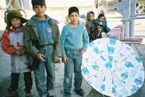

Have a look below these guys have built their own dish!

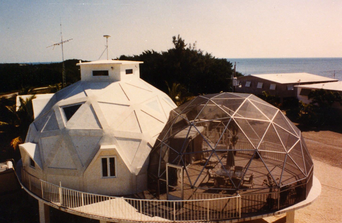

Imagine a dome house made of satellite dishes...
Each of the angles of the dome aimed at different satellites... That'd be freaking cool.

man those kids are smart

Pete,
Would you happen to have a link for the fist picture that you posted?
(The one with the boy looking out of the window.)
Thanks if you do! (Or don't.) :)

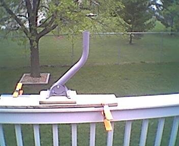

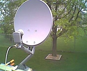

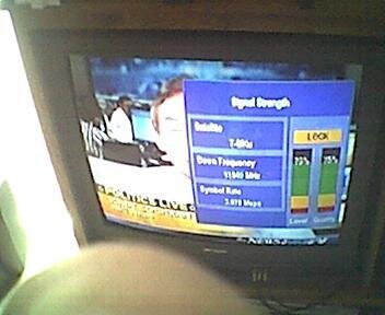

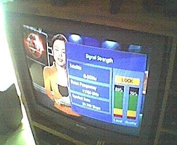

Any one know what the smallest possible ku dish is?
I've experimented with a 24" dish and even a 18" for KU. It does get the REALLY strong transponders and your skew has to be 110% bang on. Since G11, IA6, G3, IA5 are all at same elvation and almost all at 0 skew I was able to see what I could get
Best was CCTV at 70 (nornmally 90)
Doc Scott worked as did ABCNewsNow (when it was on IA6)

Will see if I can find it tonight :)

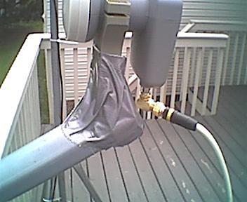

Here are a few pictures of an 18" setup I had on G3 for the Chinese Channels (4th) and ABCNewsNow (5th picture)
