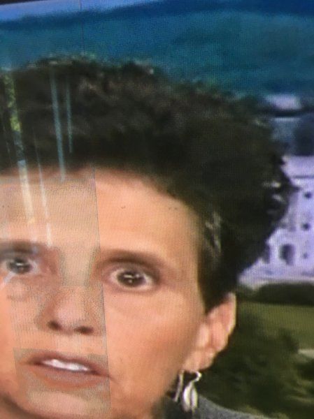

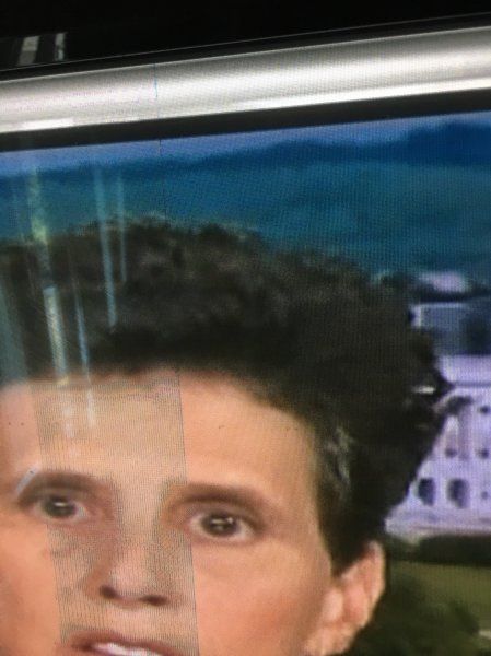

What network is the blue stripe on? It's that simple. Is it on ABC NBC CBS CBC PBS? If you can't tell us the network, then we can't help you. Your question is way to vague.
[mATTACH=full]134968[/ATTACH]
Blue line
I'm betting that band doesn't show up on other televisions.
That is indeed peculiar and somewhat reminiscent of multipath in NTSC broadcasts. DTV multipath doesn't manifest like that. I'm at a loss.
Your right,couse I hooked up a different antenna and the blue line was gone

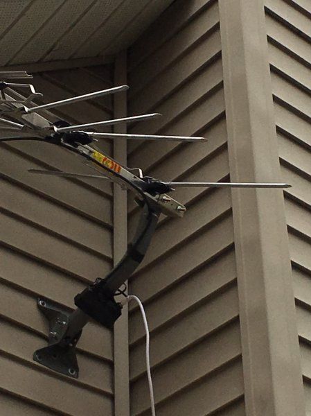

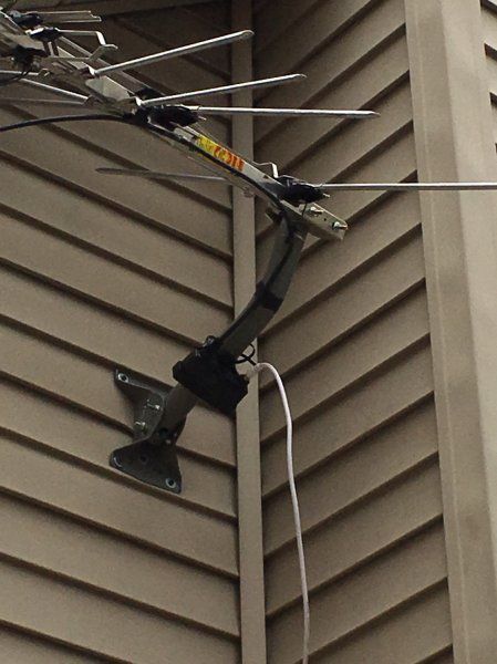

Well big change of plans
It got colder,so last night in the cold
I held a vary shakey ladder my roomate chimbed to the top and we put my antenna up[emoji3][emoji3],useing
Wood screws and washers it is up
and working first scan 65 channels
So proud, my roomate was scared
Sent from my iPhone usView attachment 135903ing Tapatalk
Antennas typically work better when level and the elements aren't all bent out of shape. Since you're currently happy, I wouldn't worry about it unless heavy weather creates a problem.
BTW, the 751 is also sold by Walmart in a smaller box> Dont get it! Its not the same and will pull stations weaker than the original 751.
The OP got the good one in the longer box. It has a better UHF element and 1 more VHF element than the new one. Another difference is the mast attachment is at the end of the antenna, its in front of the first VHF element on the new one making it harder or impossible to aim if the mast is close against a wall.
