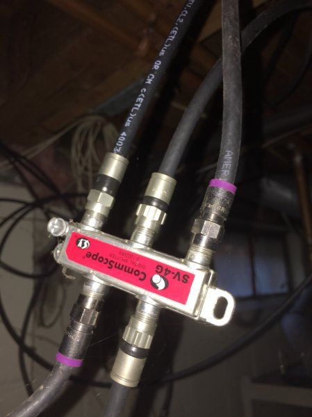

Are you sure it's RG58? Could you be confusing it with RG59? Maybe taking a picture of the label on the cable could help.
Reactions: FTA4PA
Ok everyone I went to the basement just now took a few pictures
Here is the wireing
This is all TV cable (one might even be RG6 quad shield). You should be good to go but for the fact that the signal is being split four ways.
The connector on the upper left wasn't done right as the sleeve isn't swaged all the way on (it may not have been crimped at all).
The middle port in the upper row of three is the splitter input. It is also important to know that this splitter is not power-passing so if you find that you need a pre-amp, you'll have to swap the splitter out for one that passes DC power.
