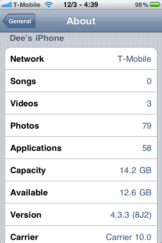

So I got on ebay and I bought a brand new AT&T SIM for $2 + $2 postage. When it came in I put it in the 3GS.
I ran an app that made a modified version of the iPhone OS then saved it to disk. I plugged it into iTunes and then you go to do a restore. I think you hold down the shift key and click restore and it asked for the file to restore. You point it to the modified file the app created and click start. It takes awhile to load.
After it told me it was done I shut it all off, swapped the SIMs and put my Centennial SIM back in.
On my home screen there was an app called Cydia. I went into that and found another app that was for unlocking, I forget the name of it.
I ran that app to unlock it and rebooted the phone, it came right up on Centennial. Centennial towers were still operational at that time even though they had just been bought by AT&T. Now everything was working as it should.
I upgraded it over the next few months to 3.1.3 and it worked fine, still with my Centennial SIM.

I then went to Walgreens and I bought a throw away T-Mobile phone. I also bought a minutes card, it was 1,000 minutes for $100 and I have 1 year to use the minutes up.
I put the T-Mobile SIM in my iPhone and BOOM. Instantly worked. I did not have to do anything at all to my phone.
Now I still do not have internet on it but I really do not care. It's not a big deal to me.
I would like to have it so when I go shopping I can scan bar codes in the store and find the best price on things. I could use it as an extreme money saving shopping tool. But I don't want to get tangled up in an expensive monthly phone bill. So I just use it as a cell phone away from the house. At home I have WIFI and then I can do anything I want with it. Or anywhere there is free WIFI. Sadly, stores do not have free WIFI.. :(
Anyway.. So all this year I ran on that old iOS, 3.1.3 and I kept getting told I couldn't install many apps because I needed a newer iOS. :(
So about a month ago I decided it was time and I found another app that would bring me up to iOS 4.3.3
Because the original owner got the baseband (I still don't know what a baseband is) stuck at a certain number, I can not upgrade it to any newer version, it is now permanently stuck at or below 4.3.3 :(
I can not upgrade to 4.4.x or 5.x, at all. Well, I can but then it would revert back to being 100% locked to AT&T and I would not ever be able to unlock it for use on any carrier. It would be a pure AT&T only phone from then on. And baby, that ain't happenin.... :mad:
So, I'll just leave it on 4.3.3 and use T-Mobile for $100 a year until next fall when the new VERIZON iPhones come out.

Well, it was running fine for him on T-mobile.
Not sure if he's the one who screwed it up or if his "friend" did it for him.
Not even sure it is screwed up. ;)
