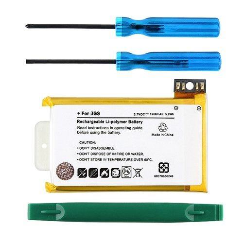

Last night, I installed a new lithium battery.
It's 1600 mah compared to stock 1200 mah (5.92 w/h vs 4.51 w/h)
I've heard that non-standard batteries were rejected by the iOS, and was upset when this one arrived.
But, I didn't have a lot of options, so I put it in (maybe an hour, for a first-timer).
After I get a few charge-discharge cycles under the belt, I hope to put the phone into service with one of several 3rd party sims, already on hand. :)

The battery change wasn't that bad.
I spent about an hour doing it, and it was kinda relaxing (as opposed to nail-biting)
If you've changed out your screen, this is really just more of the same.
Eight (?) more little screws, several more fiddly connectors, and some wiggling to get things seated properly.
I did a youtube search with "3gs battery", and watched a dozen videos.
I'll recommend specific ones if you're about to dive in. :)
If you aren't careful what you're buying on Amazon, you could get the same (?) product from any of half-a-dozen vendors.
Are they identical? Not likely, based on reviews.
So far I haven't seen any rejection of this non-standard battery by the phone.
I went with this one from Eforcity @ $3.89 + 2.98 shipping.
It has tools similar to the ones shown (two screwdrivers, plastic pry tool), and that's all I used.
Ordered Monday, and it arrived Friday, even in the midst of holiday mail.
I'm still in the middle of the first discharge cycle, so I really can't say much about the battery life.
I have about eight documented runs on the old battery, so give me a week to collect some data on this one.
