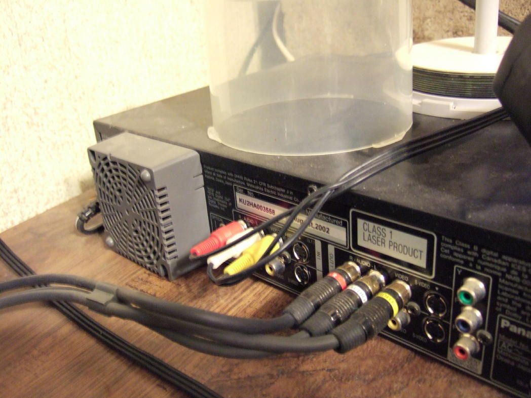

as you noticed most big boxes will run a bit hot. if you can place them in a entertainment type of center that has a closable front ( to knock down noise) you can place a small fan ( 5 inch 7inch type) in the enclosure to provide ventalation. you can also rig up a computer fan and attach it to the unit ( back or top). my stand alone dvd recorder musta had the same problems cause it shipped from the factory with this type of addition.
if these are not an option for you always remember to try to space your electronics out placing something between units (i use pvc connectors or small blocks of wood) so these hot units can disapate heat.
sounds like your problem might have been two sided with the modual problem but the rebooting sounds like a heat problem.
