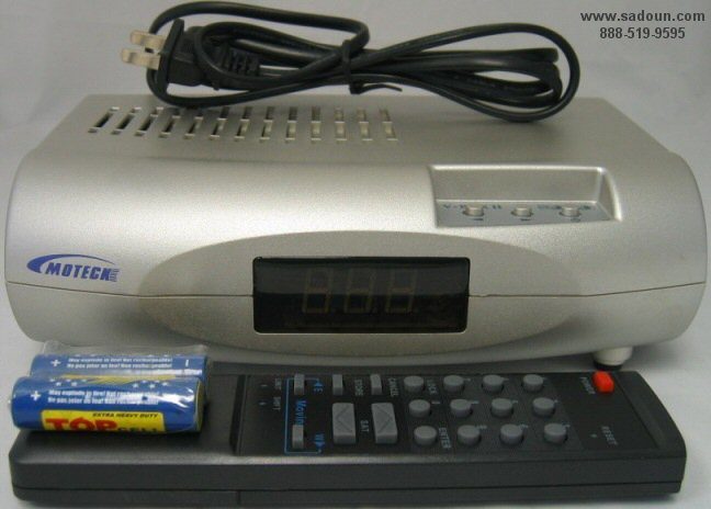

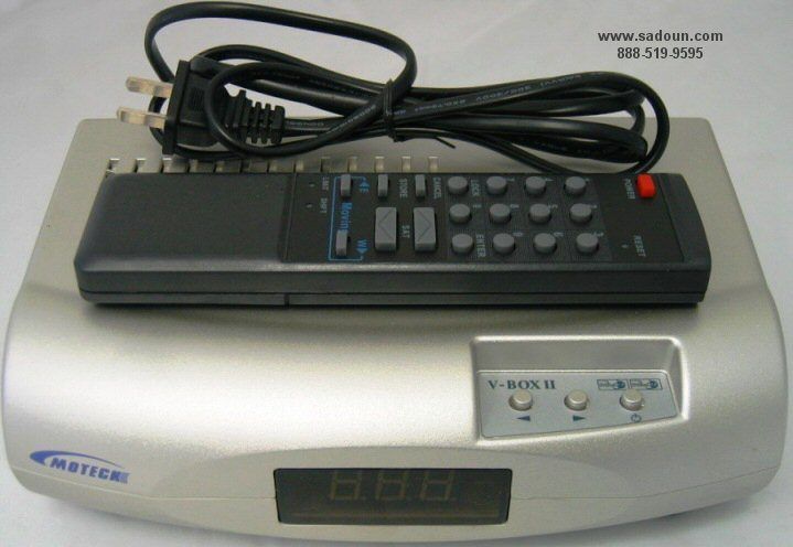

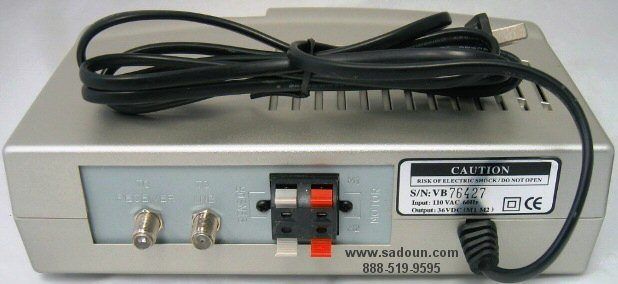

Glad you liked the Moteck VBOX II positioner. It is an excellent device for thos who want to control their C-Band BUD dishes with their MPEG2 DVB receivers.
The detailed specs on this positioner are located here:
http://sadoun.com/Sat/Products/Moteck/V-Box-II-control.htm
