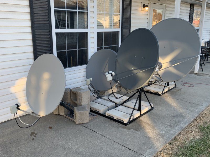

The looks you must get from passers by. :D
Yeah, I had to decide I didn't care what people think about it. I tell my friends, some guys like beer, some guys like football, I like both... and free TV. Then they are interested. My next door neighbor thinks of me as a "TV guy" because I set up her DirecTV. It's not who you know, it's what you know ;)
You must certainly have a very understanding wife to be able to place all those dishes where they are.
I'd probably have better luck planting a Boeing 707 in my yard ;)
Actually my wife is understanding and tolerates my one C-band dish as she knows its my hobby.

Gee maybe your wife can speak to my wife so I can have ONE C-Band dish as well...She let me have ONE 76cm KU dish and nothing larger. I keep telling her the bigger the better but she won't bite. However, as married guys know, it's easier to get forgiveness than permission so one day she will see a larger KU dish -

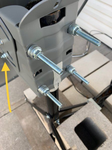

Titanium 2 of the 4 bolts on the adjustable portion of the mast snapped off and broke yesterday. Do you know what size they are? I went to the hardware store and had a difficult time matching them

Sorry, don't recall the metric size on those carriage bolts. Should be printed on the assemble sheet.
I would replace the elevation bolts with similarly sized SAE or metric carriage bolts/nuts and add flat and star/split washers to help deal with the repeated torque when reaiming.

if you still have the broken bits, it should be easy to measure the nuts size. M8 bolts usually mean a 13mm wrench size (so just a bit too big for a 1/2"wrench), and M6 usually means 10 mm wrench size (fits very loosely in a 7/16 wrench). Those bolts can usually be swapped for 5/16 and 1/4" respectively.

Put it on a polar mount after you get some new bolts that aren't cheap snappers. It'll be a little more work, but MUCH cheaper than a Stab HH120 drive, if you can get a dish donor. Though you could use one of those, if you have $200: STABHH120
