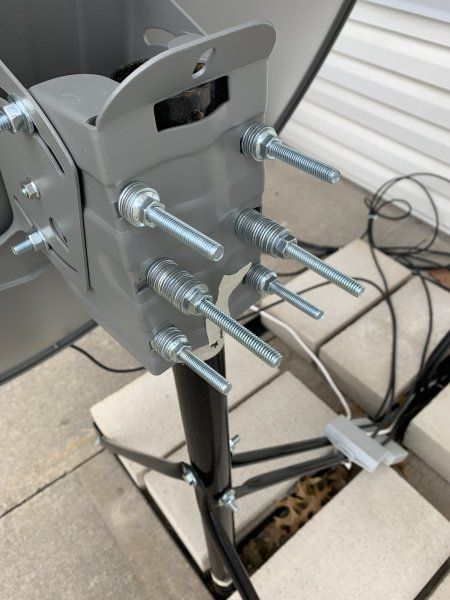

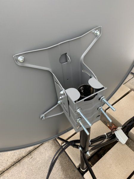

Added a third U-bolt today. Now the dish is almost 100% locked down and won't move left or right :)
I'm becoming a regular fixture down at the hardware store :p

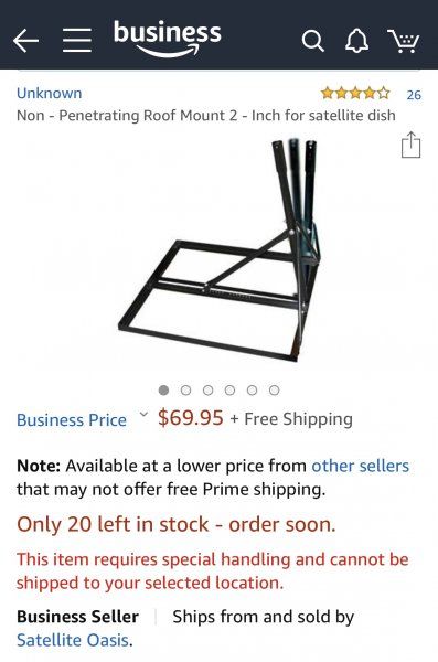

Where did you buy the non-penetrating mount?

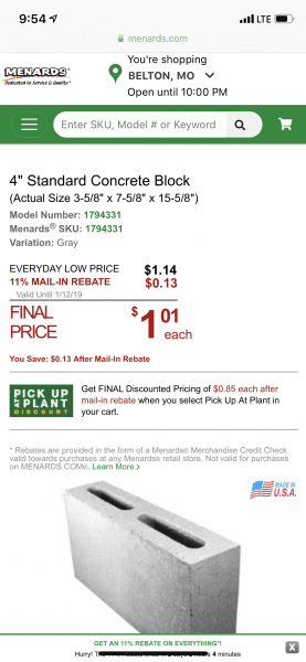

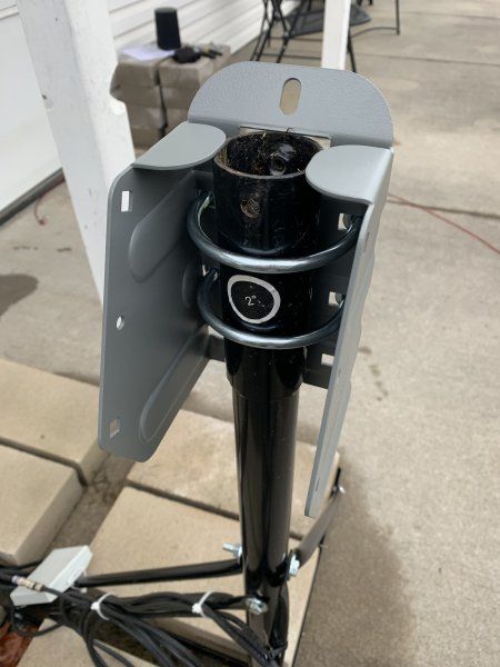

I got it on Amazon; its the Perfectvision NPR6B. I got 8 blocks from Menards to load it down. Its great for a patio; I have 2 on mine :)
Can't say how well it would work on TOP of a patio; its heavy. But sits well on concrete.

No problem. And you won't have to worry about it moving in the wind, its a big beefy mount.
Tunder For your 1.2m motorized project, I suggest a NPRM with the larger post. A 2 3/8" post will work better with the HH motor.
Here is an example: www.amazon.com/Perfect-Vision-NPR4A-Non-Penetrating-Antenna/dp/B0083KIZGK
Used to sell a lot of these for motorized installs. A neoprene "pitch pad" placed underneath the NPRM will keep it from moving/rotating. :)
Use the non-centered pole as they can be rotated to an angle that prevents the rotating dish from hitting the stack of blocks.

Ah, if using a 1.2m then you are right. My 2" pole on the NPR6B is just slightly too small; that's why I have all the washers on the U-bolts.

Now you need to go back to the hardware store and buy a tap and die set and get rid of all washers
The real (and surely cheaper) solution is to order the appropriate bolts from said hardware store. Most have overnight access to fastener distributors if not sooner.
Threading the shoulders off of bolts weakens them and makes them much more prone to rust.
When snapping the bolts is an issue, ask for grade 5. The default grade for carriage bolts and all-thread is grade 2 that is only half as strong as grade 5. Grade 5 has three raised marks on the head of the bolt while grade 2 has none.

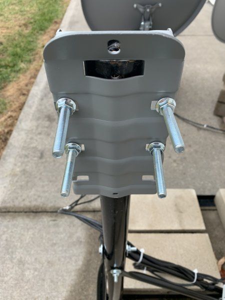

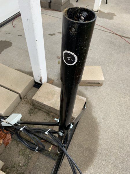

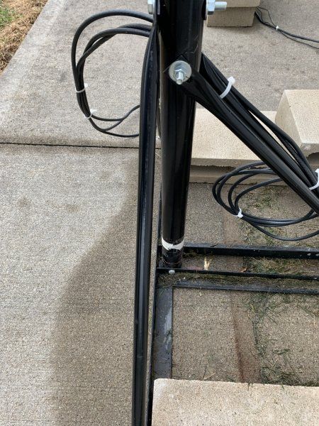

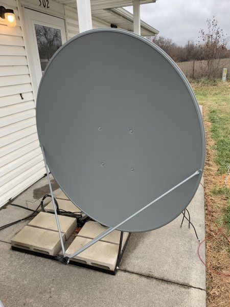

Moved the reversible pole on the non-penetrating mount to the 2" side, then installed the mount and dish. It's a bit unwieldy doing it alone, but I finally got it on there.
View attachment 136154 View attachment 136155 View attachment 136156 View attachment 136157 View attachment 136158 View attachment 136159

Instead of the U-bolts. I have use muffler clamps in the past and they work really well, I removed the u-bolt from the clamp and purchased 2 long screws long enough so they will stick out about 1 or 1.5 inches at the other side of the dish mount, I found out it secured it really well and never had a problem, I am planning on using these clamps on my next dish.

What is the size of the cement blocks you are using on the dish mounts?
