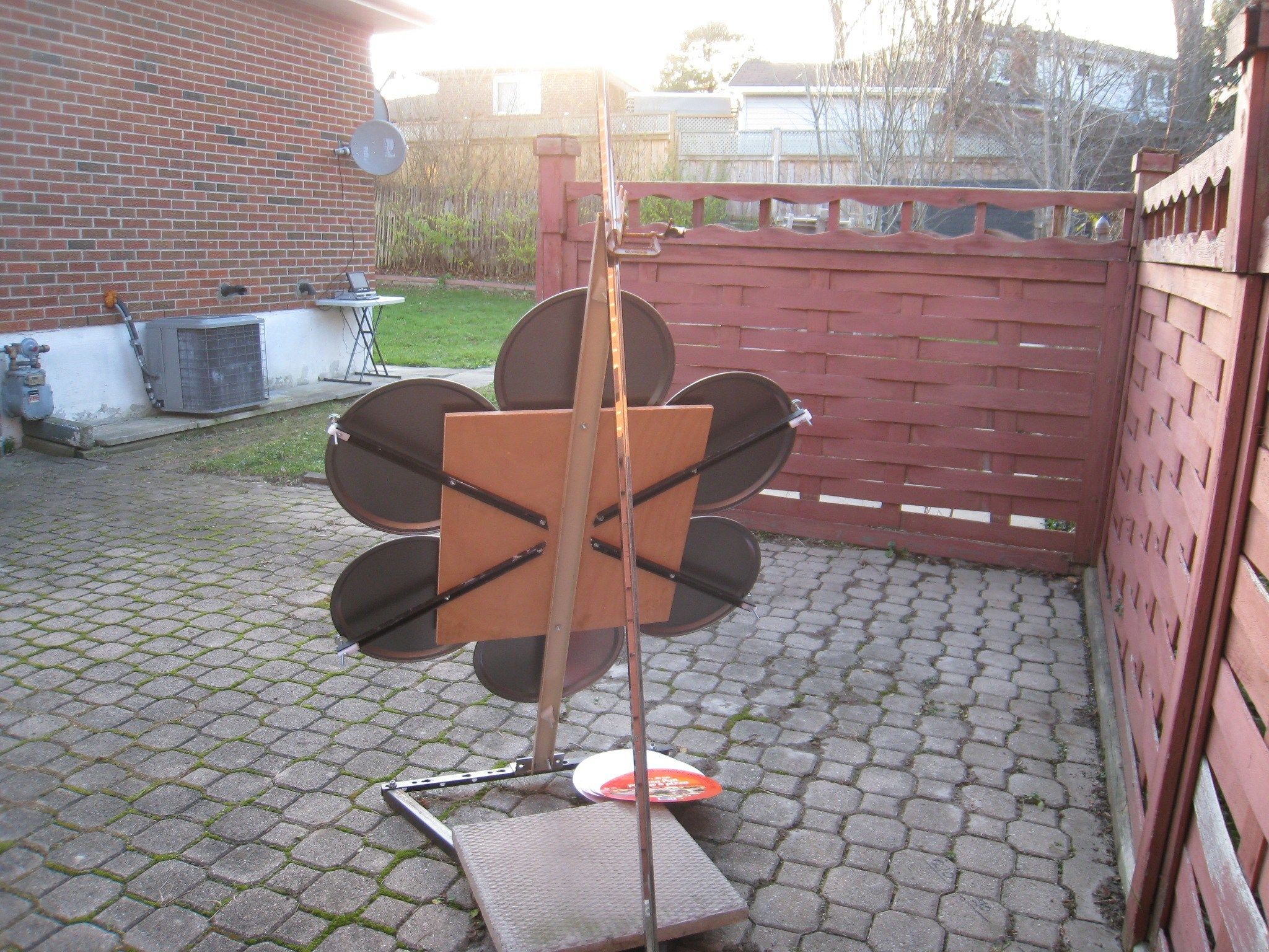

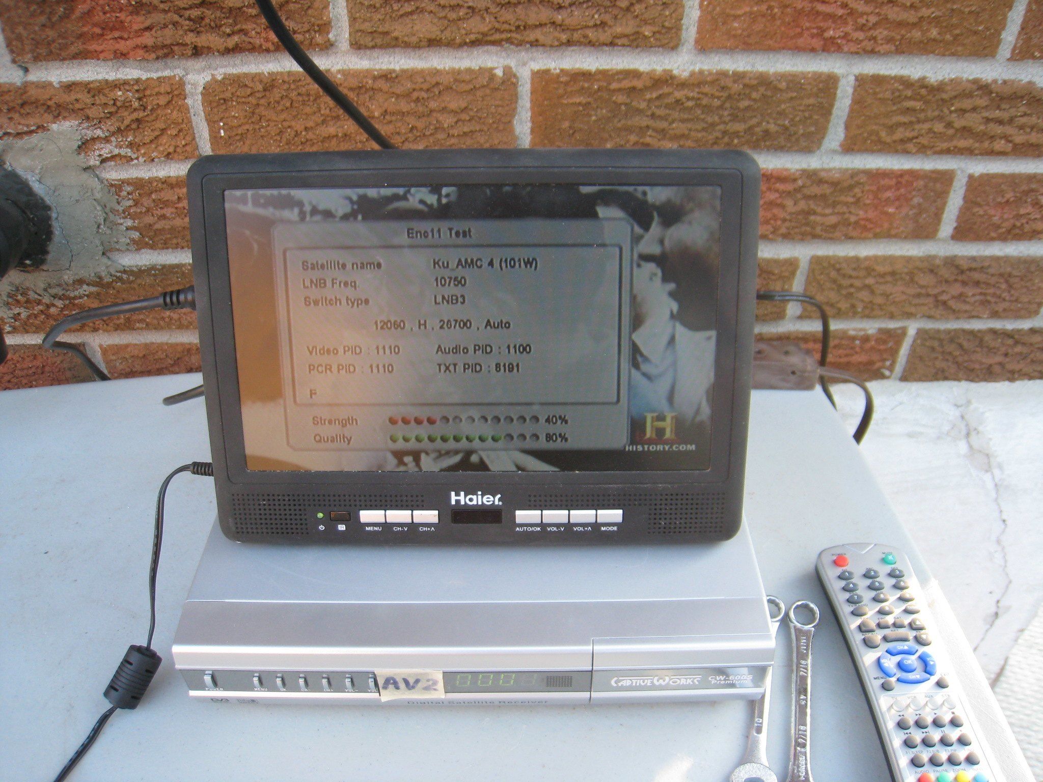

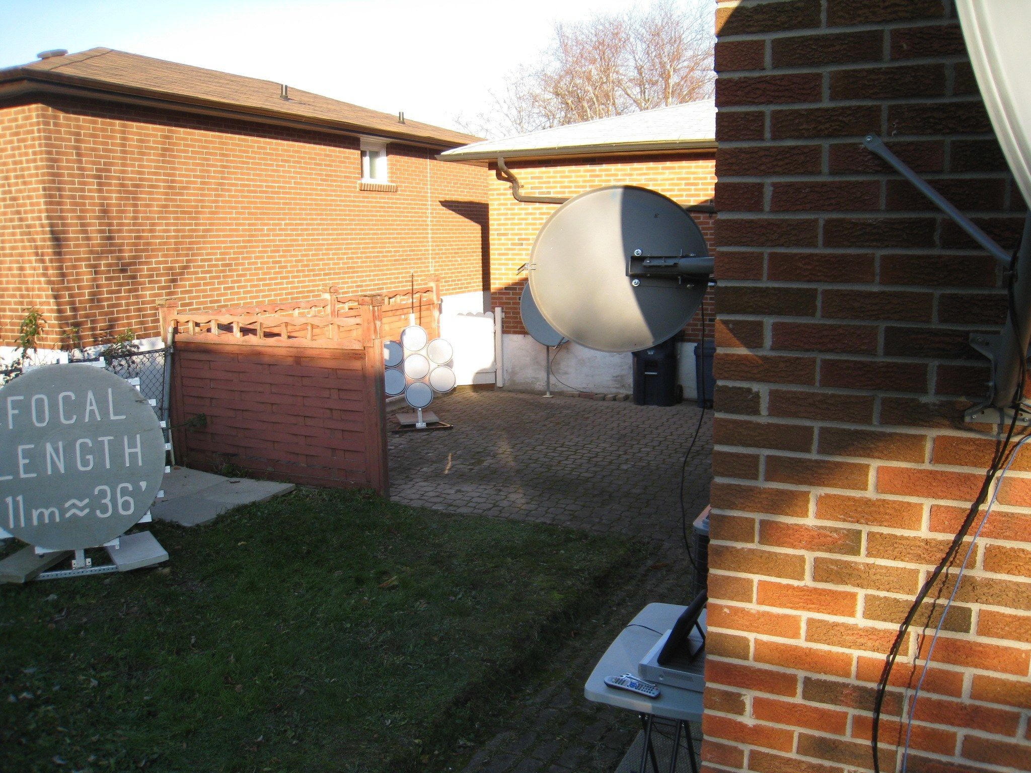

Finally, I completed this project with 7 pizza plates. However, probably due to the gaps between plates, the strength is only 40, and quality is 80. Overall the reflecting surface of primary cluster is much smaller than the surface of one-piece "dish" used earlier. The secondary 18" dish had to be mounted horizontally, as it had to be directed downward. The small channel attached to the 18" dish helped me to aim it at the cluster. IMG_0324.JPGIMG_0313.JPGIMG_0315.JPGIMG_0310.JPG
