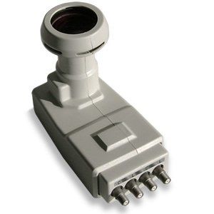

The LNB that covers most all the bases, is the Invacom QPH-031.
It has a built-in feedhorn, and has two outputs for circular, and two for linear.
It's a Standard LNB, so that precludes reception of any birds needing Universal LNBs, but you can discuss whether that impacts you or not.

This LNB is suitable for any round offset dish, but not the right choice for an elliptical dish.

The best linear/circular KU lnb on the market today I still say is the Invacom QPH-031.

Ditto on the Invacom QPH-031, it's a proven performer, will allow you to get linear and circular with one unit (you'll need circular to get NASA on 119 for your Dad) and you can also feed multiple receivers, if desired.

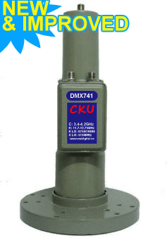

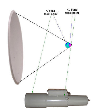

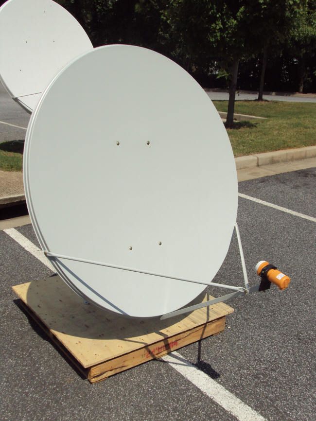

1. Buy your folks a Ku-band set, based on 1.2 m (4 ') dish (WSI advertises one heavily right now) with a suitable motor and strong post, HD Receiver (probably AZBox Elite, since its quite advanced, and going to offer Blind Scan and extra US specific tuners a bit later, if your folks ever need those). Invacom QPH-031 is your 1st choice LNB. Later, when your folks are better appointed with their system, and will inevitably ask for more channel variety, you can upgrade their setup to a 1.2 m mini-BUD for some extra C-band reception with an extra C-band LNB and scalar ring & bracket to mount and adjust it properly. One Chieta DiSEqC switch in a weather box, a coax cable roll and connector tools, good inclinometer and compass, and some smaller parts like tapcon screws, cable ties, etc. will complete your list. A serious bonus would be an inexpensive modern A/V Home Theather Receiver like one of Onkyo models with its speaker set, and extra speaker wire, audio & video cables to connect them all.

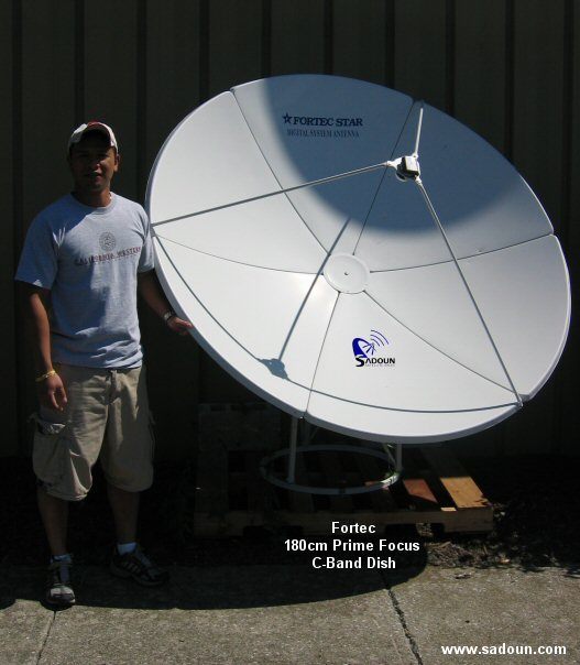

2. For yourself consider a motorized C-band BUD with 1.8 m (6') dish. You already mostly exploited, what you can get in SD in Ku-band - not that much. Don't touch your setup for now. Install a motorized BUD, and learn everything with it about C-band, and enjoy a lot more channels than you have now. Later you can upgrade your Ku-band farm to a single 1 m motorized Ku-band dish, in particular when you decide to get a large HDTV. On top, your gained experience with the BUD will make converting later your folks' setup to a mini-BUD a snap. In exchange, they may agree to sponsor your future Ku-band motorized dish project with an HD Receiver (good for C-and-Ku band), so all you'll need later to buy is a new flat panel HDTV. Or, you can setup from the start a motorized 1.8 m C/Ku-band BUD by adding a C/Ku band LNBF like DMX741 from WSI, specifically designed for a Prime Focus Dish. Look through the thread Best C-band 6' Dish Setup for more ideas.
