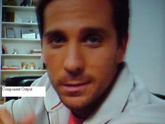

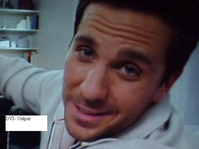

I have connected both component and DVI to my Sony GWII. I have noticed that although the quality seem to be almost the same, there is a red-push on component. I have been trying to capture almost similar pictures of both and have not been succesful at getting them. Here are two pictures that I took.
Note: When I use my 6000 receiver on the same output there is no red-push. Also, do not concentrate on the picture quality because my intention here was to capture the red-push comparison between the two video output.

Have both inputs been tweaked with user-level controls using a calibration disc like AVIA or DVE prior to this test?

The red-push I am seeing is not due to the TV component input. I have connected my 6000 receiver to the same component input and the 6000 receiver does not show any red-push. It is only with the VOOM receiver using component output that I have seen this red-push. On the other hand, DVI is fantastic as it is.

I'll post this to the benefit of everyone regarding the red push. This is what Wilt say:
That's why I said I'll post it to Moto to take a look--can't do that with every individual issue, to be sure, but if there's evidence of more than one or two, it's worth a shot.
So, if you want to hold off a little on the call, and aren't too troubled by what you're seeing, let me see what Moto has to say and go from there.
Whatever you prefer.
Thanks again,
If you have have seen a red push on your box, it may be a defective box. I'll wait until Wilt touch basis with Motorola.
