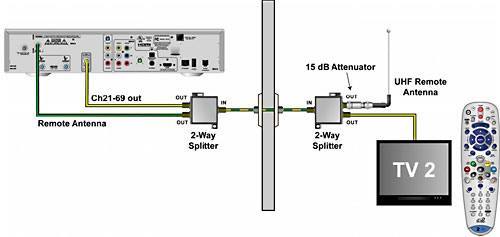

Thanks upsss but I guess I was not clear. I have three separate locations I want to service, family room with the receiver, kitchen, bedroom.
If I follow your solution I would be moving the antenna closer to one location but much further away from the second location. In fact I had tried your solution and basically lost the signal from the other location. Currently the receiver and antenna is midway between the two other locations. Therefore it would seem the best solution is an antenna with a better receiving capability.
No problem, you add to each TV2 its own antenna and a splitter.
BTW, a "better" (higher gain) antenna than the original Dish UHF antenna or a "rabbit ears" (Dipole type) would have to be much larger (Yagi type, Google it) which would be very directional and it will not solve your problem. My original suggestion is your solution.

If extending your UHF antenna with a piece of coax doesn't help then see my #6 post. This is the most reliable and cost effective solution (< $5.00) and it will practically work at any distance.
Would definitely recommend setting you remote address to mid range number I use 24 usually this sets it to Band B and will reach further you can also try upsss's suggestion only place a splitter with an antenna at each tv location should fix your problem. I had to do that at a 6 rm customer had tv in the garage with tv in br on the complete opposite side of the house. Band B may fix your problem by itself though.
