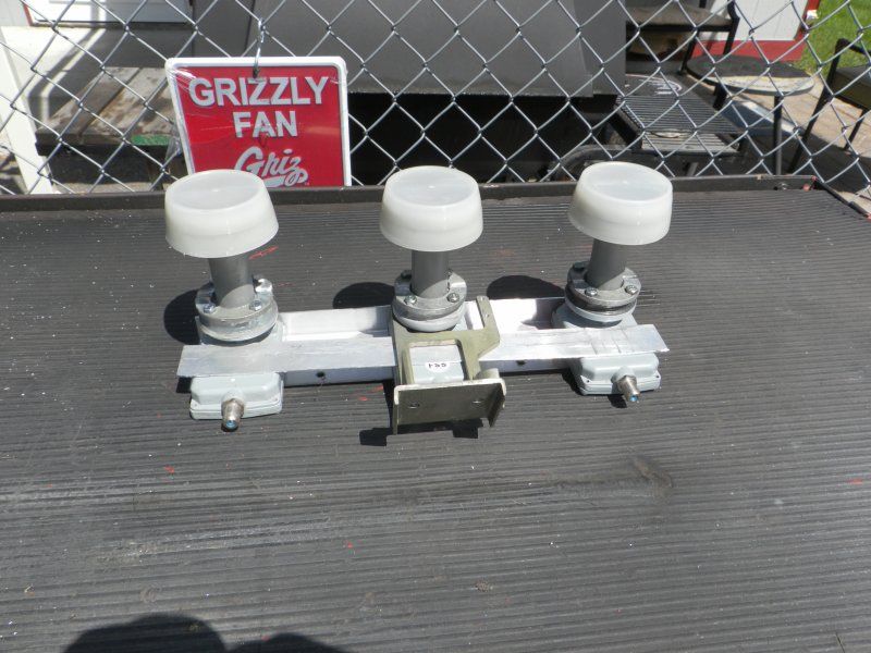

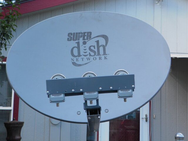

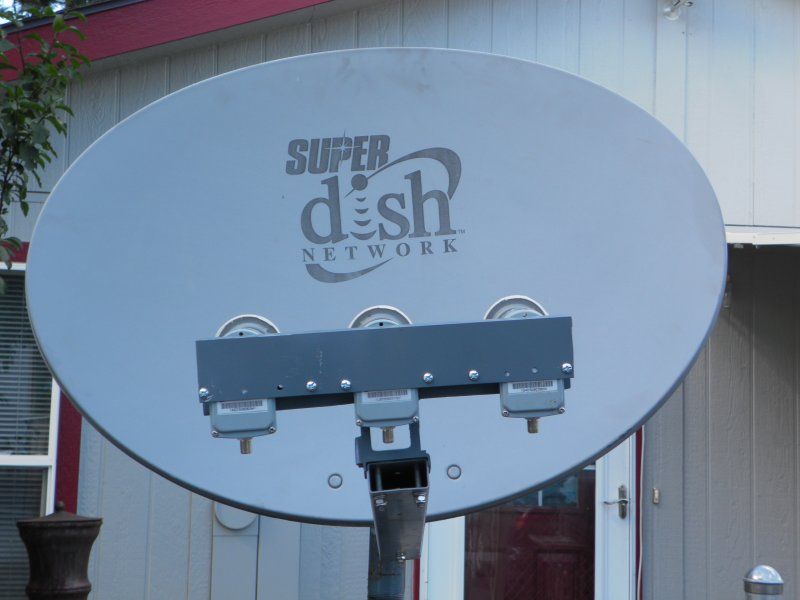

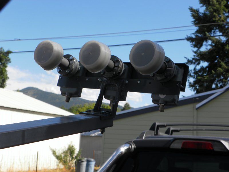

I played with a SuperDish a bit. Tore apart some LNBFs and put the feedhorns on some of those FSS LNBs. I found that most of those FSS LNBs are so old they have all drifted way out of frequency spec. :( But you compensate for the drift and it wasn't too bad.

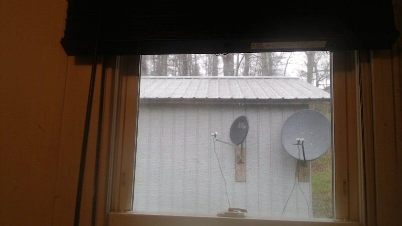

Ill add a picture tomorrow! On my 76cm dish I was getting around 63% and with my Dish network dish I am getting about 58%. I am happy making use of something they wanted to throw away! :) Hey thanks for the post on the lnb! It is raining Today so all I can say is that my numbers will go up! :) I am laughing seeing my 90cm next to the dnetwork dish! :D

I had a turbo dish on 121 with a linear ku lnb got it just fine it was real easy to get in even through the trees. Mos can you take a better pic of that lnb holder how is it placed on your dish arm?
I just bolted the lnbf bracket to one of the holes on arm, I know their is a better way! Its a cobby job but it does work! lol nothing better then to convert what they left behind to usable! :)
