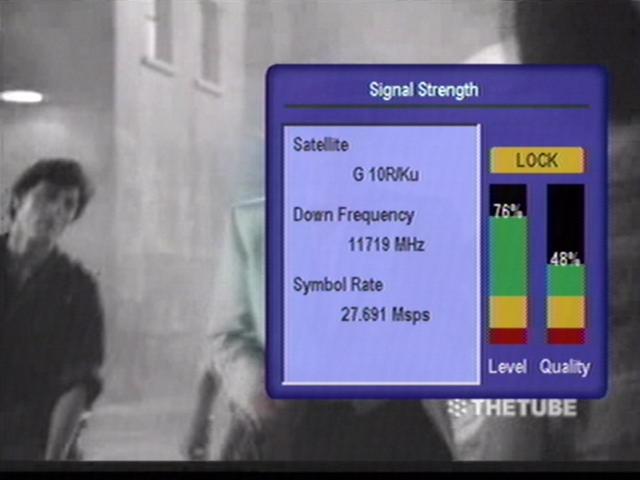

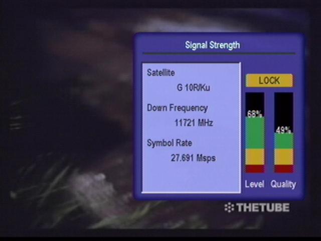

And signal level went down....quality stayed the same.
Spent several hours tweaking... and bottom line, I get lower signal levels from the invacom.
Ironically, it gives me a higher signal level if I am right at the dish, but it drops more over the long cable run to my bedroom where the receiver is located than the old dway one does.
DWAY Signal Level 76% at the dish, 76% in my bedroom
Invacom Signal Level 80% at the dish, 68% in my bedroom (as shown)
Before and after shots are attached.
I took many other shots of the upgrade process, with anticipation of posting a glowing review, but right now I just feel like I threw away $50 on this LNB. It may work fine, but across the arc it has provided little, if any, improvement over the LNB I already had.
The pictures are reversed looking at the post... the picture on the right is "Before" the picture on the left is with the Invacom.

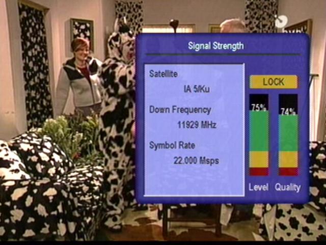

Jealous much? IA5 is my true south and I pull most of the transponders in great.
