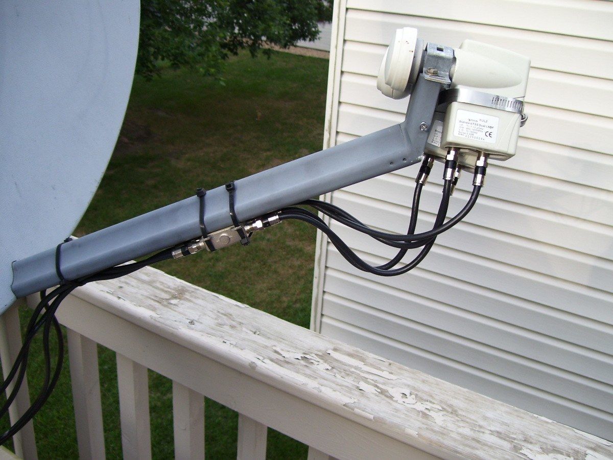

most LNB's if you cut right behind the eye will have a 25mm neck that fits just fine on them
What LNB do you have? Here is how I did it with some Sadoun duals
