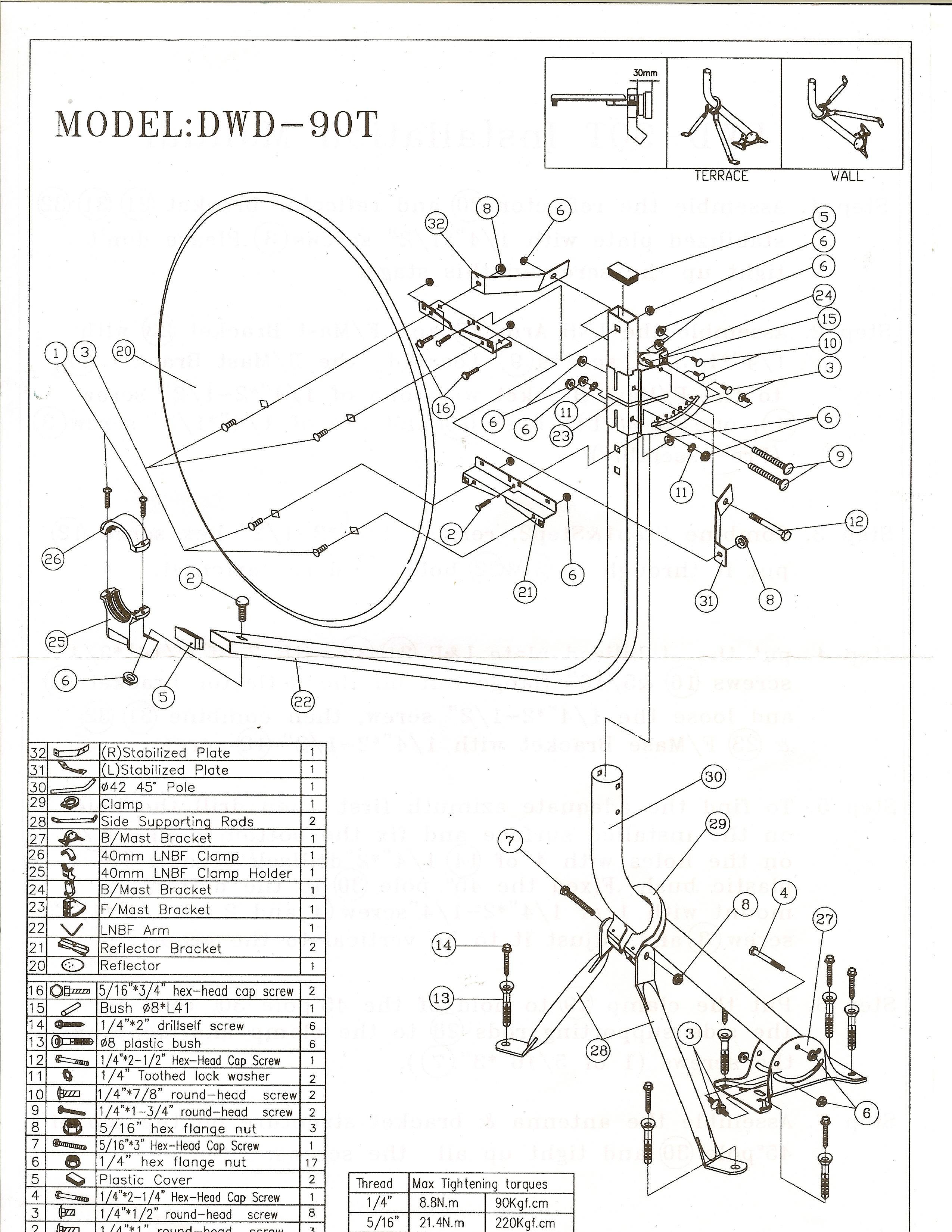

jmc98 Supporting Founder Original poster Supporting Founder Jan 11, 2005 822 43 32.750N 97.488W Fort worth Tx Nov 6, 2010 #2 jmc98 said: I Click to expand... Sorry for not being clear if I don't sell my 90 cm motorized system and decide to reassemble the dish with new parts what type of bolts and what size do I need?
brentb636 SatelliteGuys Pro Jun 24, 2006 4,278 6 5 miles N of Saugatuck, Mi Nov 6, 2010 #3 That's a big question, not knowing how far disassembled is the dish. Here's a view of the parts list for the Fortec 80CM, I'd expect a lot of similarity. http://www.satelliteguys.us/attachment.php?attachmentid=25435&d=1212528297 . Attached is a breakout of the Fortec 90, current version. Attachments Fortec 90CM-Dish.jpg 758.1 KB · Views: 286 Last edited: Nov 6, 2010
jmc98 Supporting Founder Original poster Supporting Founder Jan 11, 2005 822 43 32.750N 97.488W Fort worth Tx Nov 6, 2010 #4 Well the lnb arm has been disassembled as are the pole mount and the back brackets
