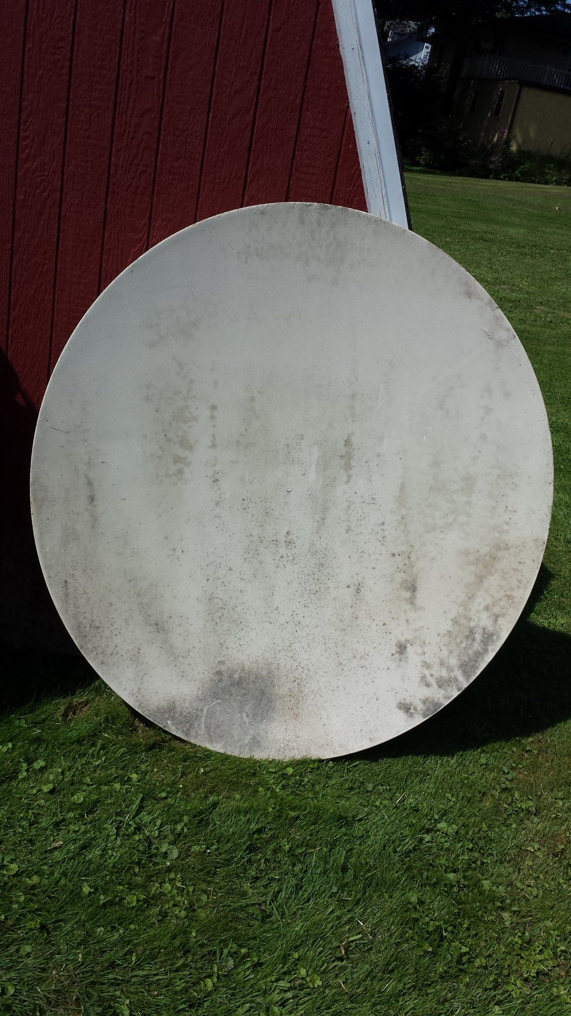

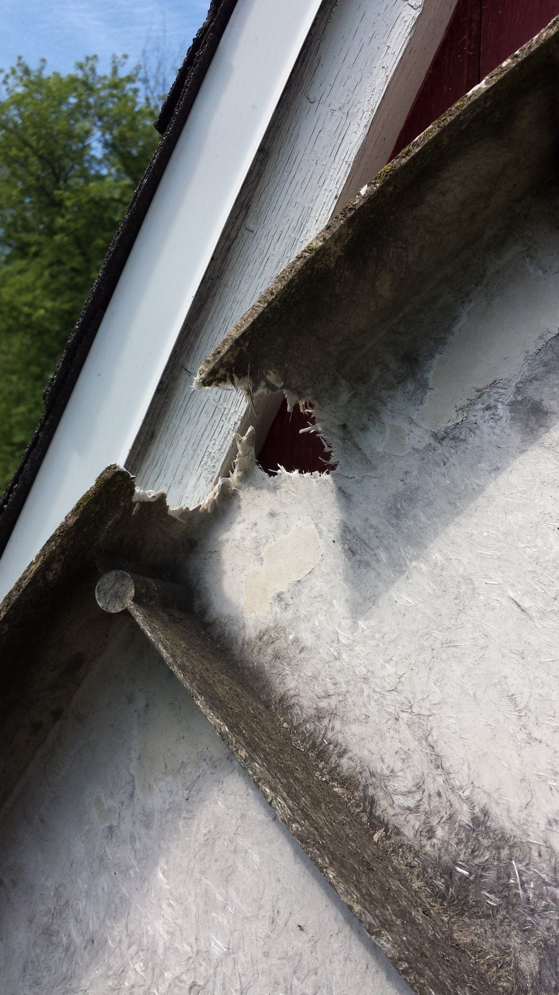

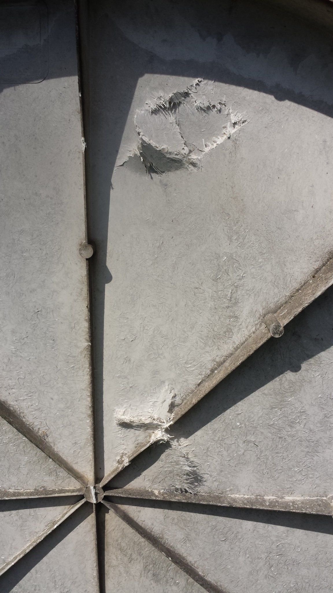

Alright then, here we are!

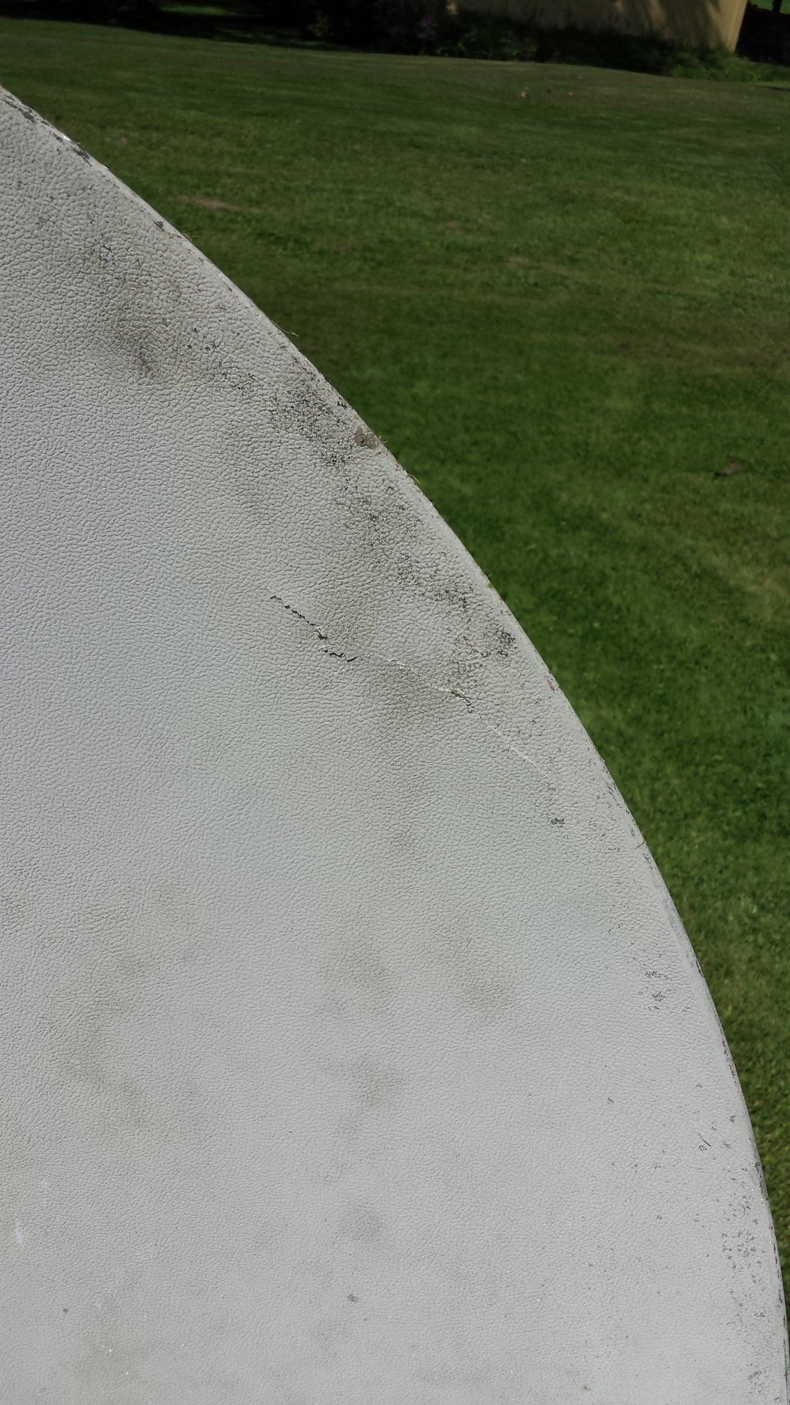

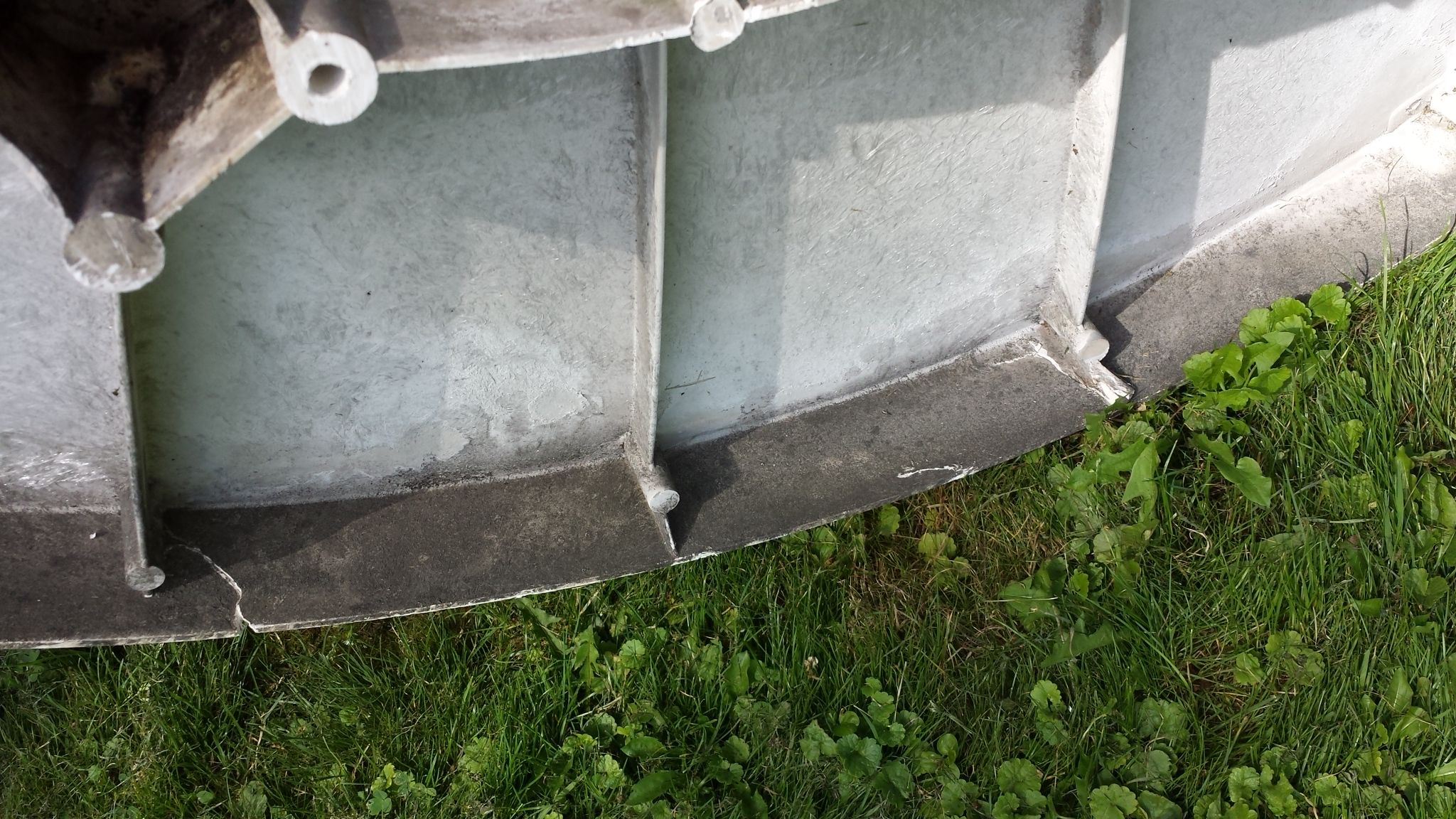

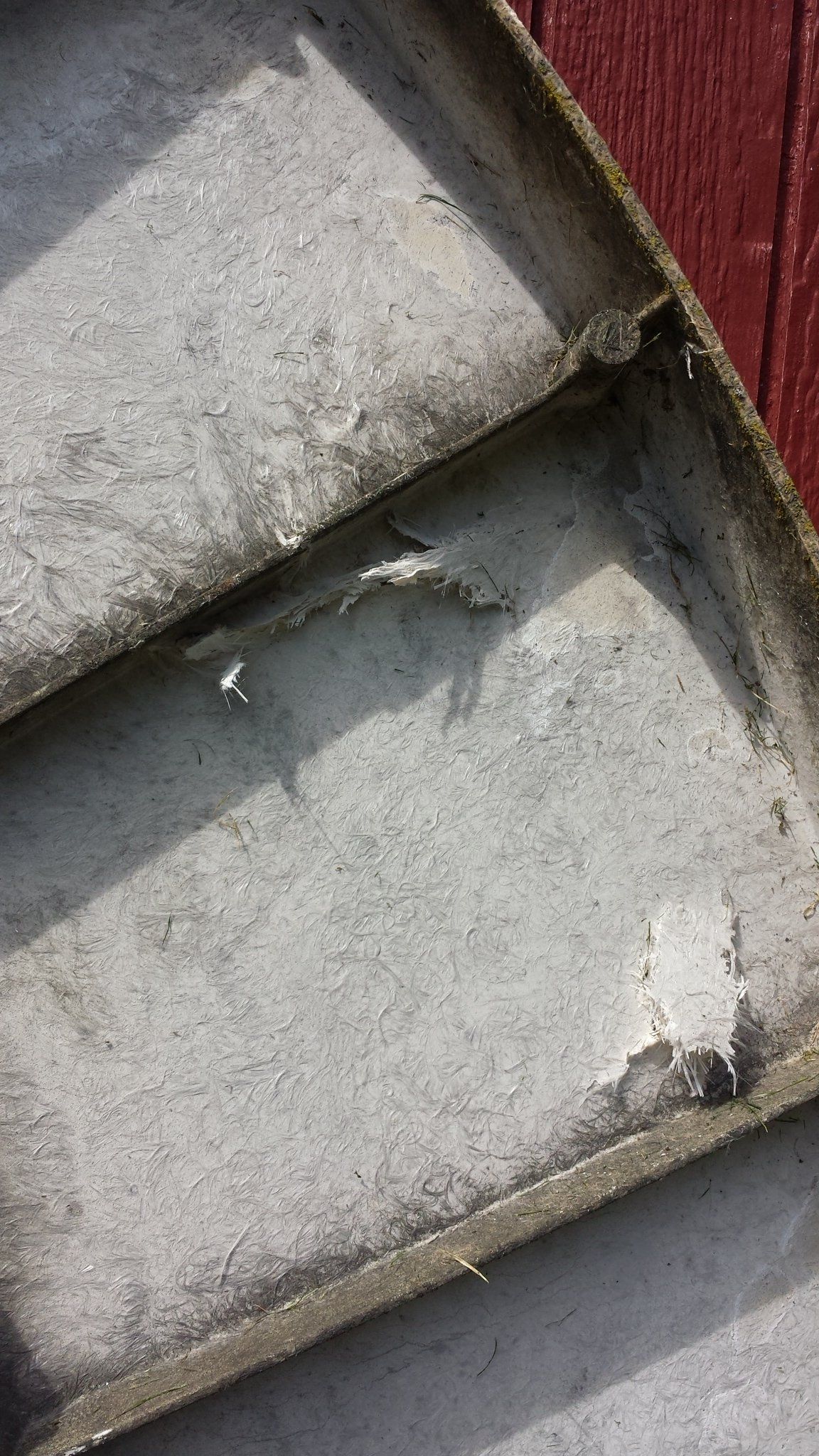

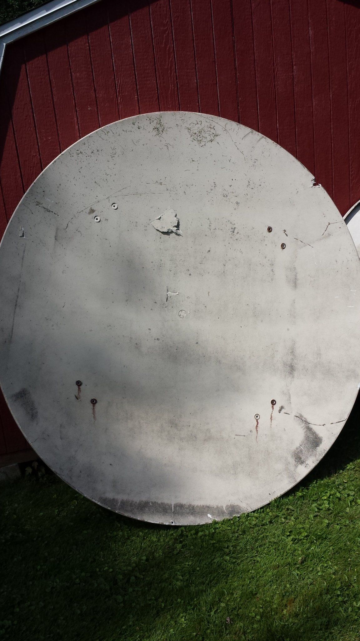

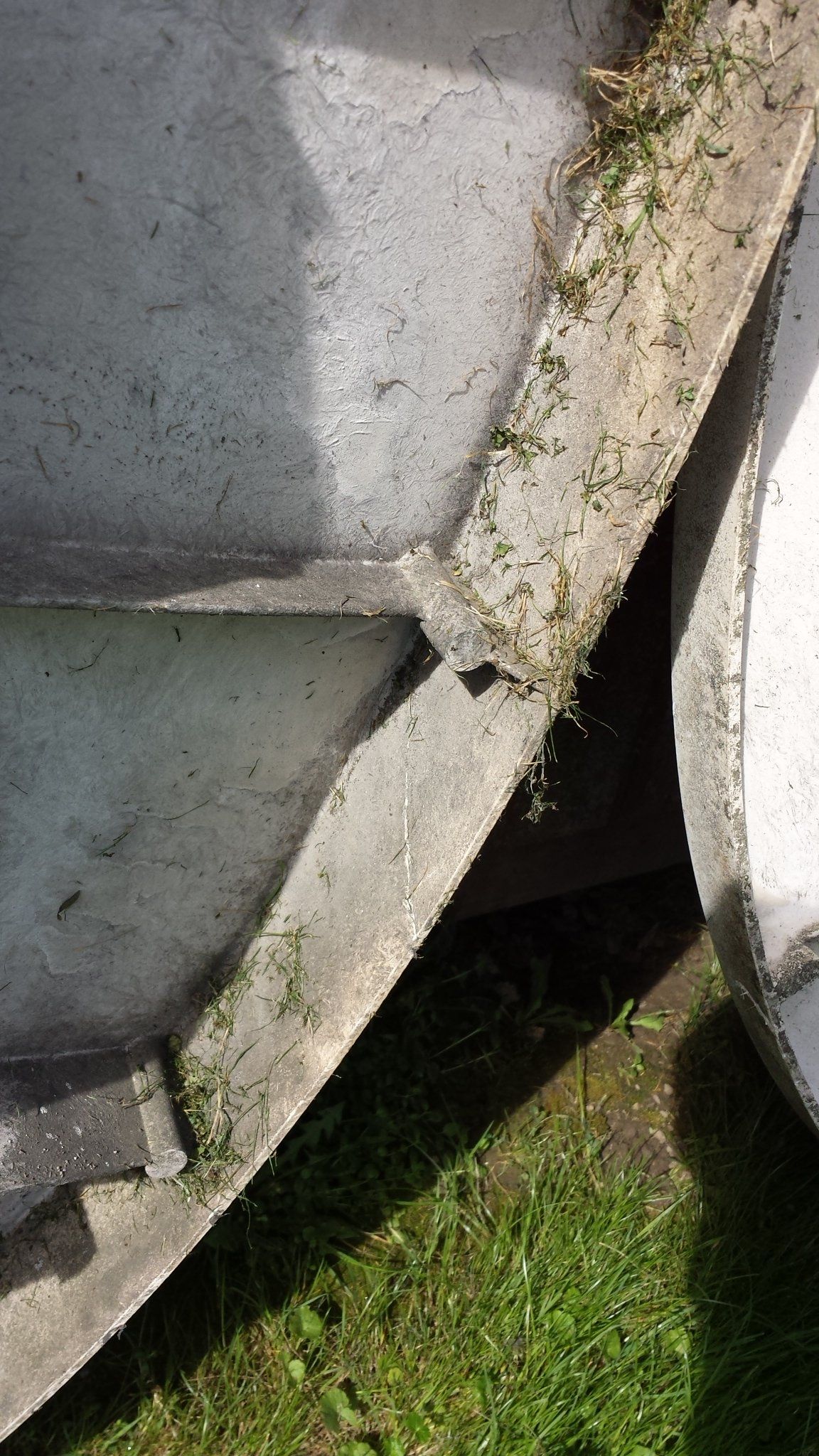

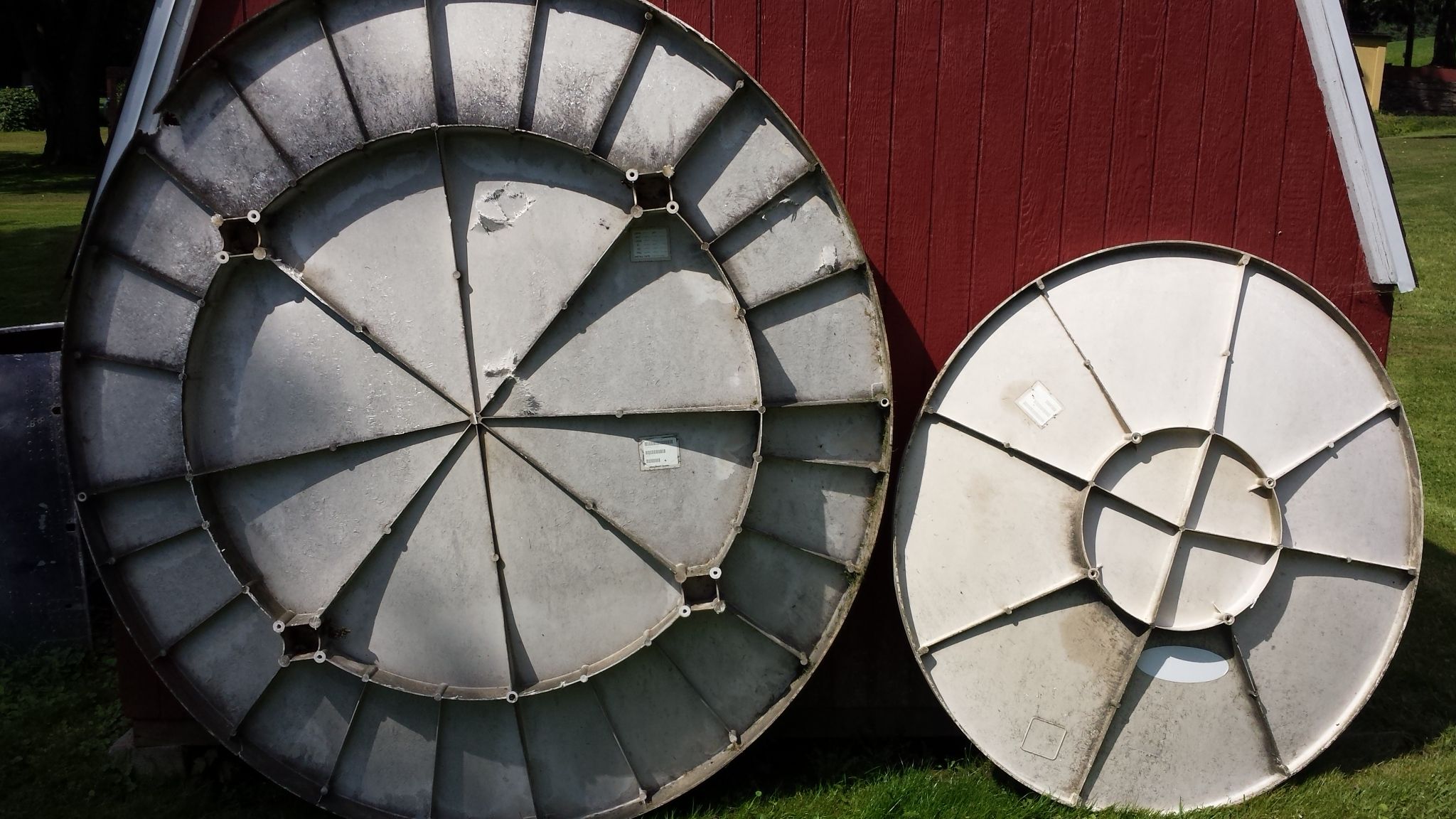

Here's both of them. Hopefully I can fix the bigger one. The smaller one isn't near as bad.
Any thoughts? What's the best way to repair these? 1437835270183.jpg1437835098705.jpg1437835448785.jpg1437835511275.jpg1437835571346.jpg1437835633456.jpg1437835730147.jpg1437835805471.jpg1437835859741.jpg1437835270183.jpg1437835098705.jpg1437835448785.jpg1437835511275.jpg1437835571346.jpg1437835633456.jpg1437835730147.jpg1437835805471.jpg1437835859741.jpg1437835270183.jpg1437835098705.jpg1437835448785.jpg1437835511275.jpg1437835571346.jpg1437835633456.jpg1437835730147.jpg1437835805471.jpg1437835859741.jpg
Hopefully someone with more experience than me will chime in, too. The big dish is probably salvagable, but will require good patching to fix the broken area in the reflecting surface. It isn't all that big, so probably wouldn't cause to much signal loss. The smaller one, looks ready to go after get a mount made, including a holder for the LNBF. I am assuming it was an offset. I think I would build a fixed mount first, just to be sure I liked what it gave me, then maybe upgrade it to a polar. You have a lot of work ahead of you and assuming you enjoy fabricating things you will have fun.
Do search for finding the focal point on an offset dish, both here and google. You will find how to measure and calculate it. It is pretty much just a good starting point, but gives close enough to build to with adjustments for fine tuning. If you could get the mounts out of the scrap container, it would sure make life easier.
Good luck and have fun.
Reactions: ThisBUDs4U
I do not like way how 1,8m dish was treated ad damage is not looking good. And it is not just glue some plastic to the surface, there is mesh inside and it is broken and not repairable. But, how it already said by bpalone overall loss of working area is not so great and dish, if managed to make mount for it, will, most likely perform less than 5% worse than undamaged. That will not be easy task to make AZ/EL mount for this antenna and Polar-mount even much more difficult.
1,2m antenna after washing can go directly on any polar-mount (after some adaptation of course).
Feedarms for both antennas is not a big deal- manageable.
I have both such an antennas and know very well positions of their Focal points, offset angles, opening angles, all dimensions, so, when author is ready to start fabricating LNB holders, just ask me.
Just out of curiosity, would I be able to repair the structure and surface, and overlay new mesh on top of the repairs and get away with it? I have to put a new finish on the front of both dishes since they are weathered and the mesh is exposed on them anyway.
The container belongs to Sutty's, up here close within the vicinity of the now-defunct Blue Swan airport. It's a game of beat the clock with them. When I see that container is no longer there, it's back at Sutty's, and who knows how quickly they process their material as soon as it is offloaded there. I won't be able to try to do anything at least until the following day. I've never been there personally, so I have absolutely no idea how long the material sits around before they take care of it.
What should I use for a finish? I'm worried that the exposed mesh can lift up from the reflector substrate, meaning the dish itself may not be warped, but the mesh can warp if it lifts. Seeing that it is beginning to do so along the outer edge at the bottom and I don't want it to do so any further.
I'd just get it as smooth and flat as I could and then patch it up with fiberglass mat and resin,2 maybe 3 layers.Clean the rest of it up and throw a coat or two of paint on it,something outdoor/automotive type paint.
