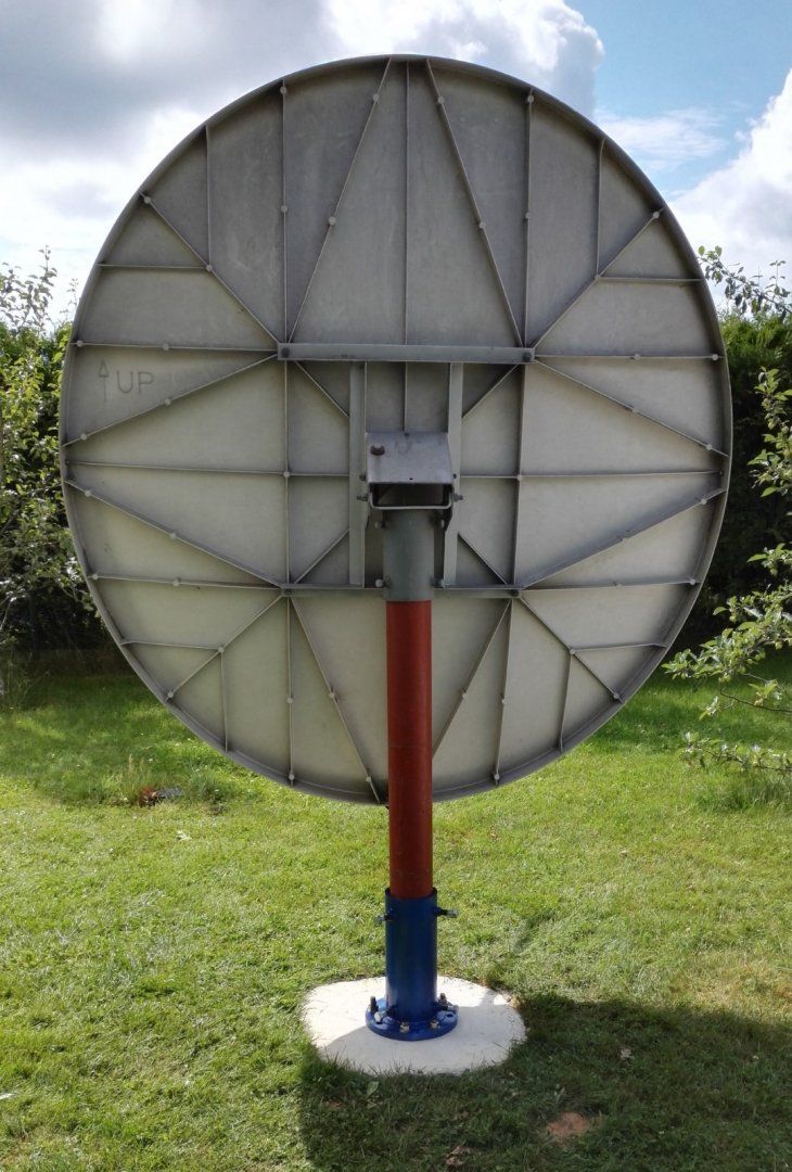

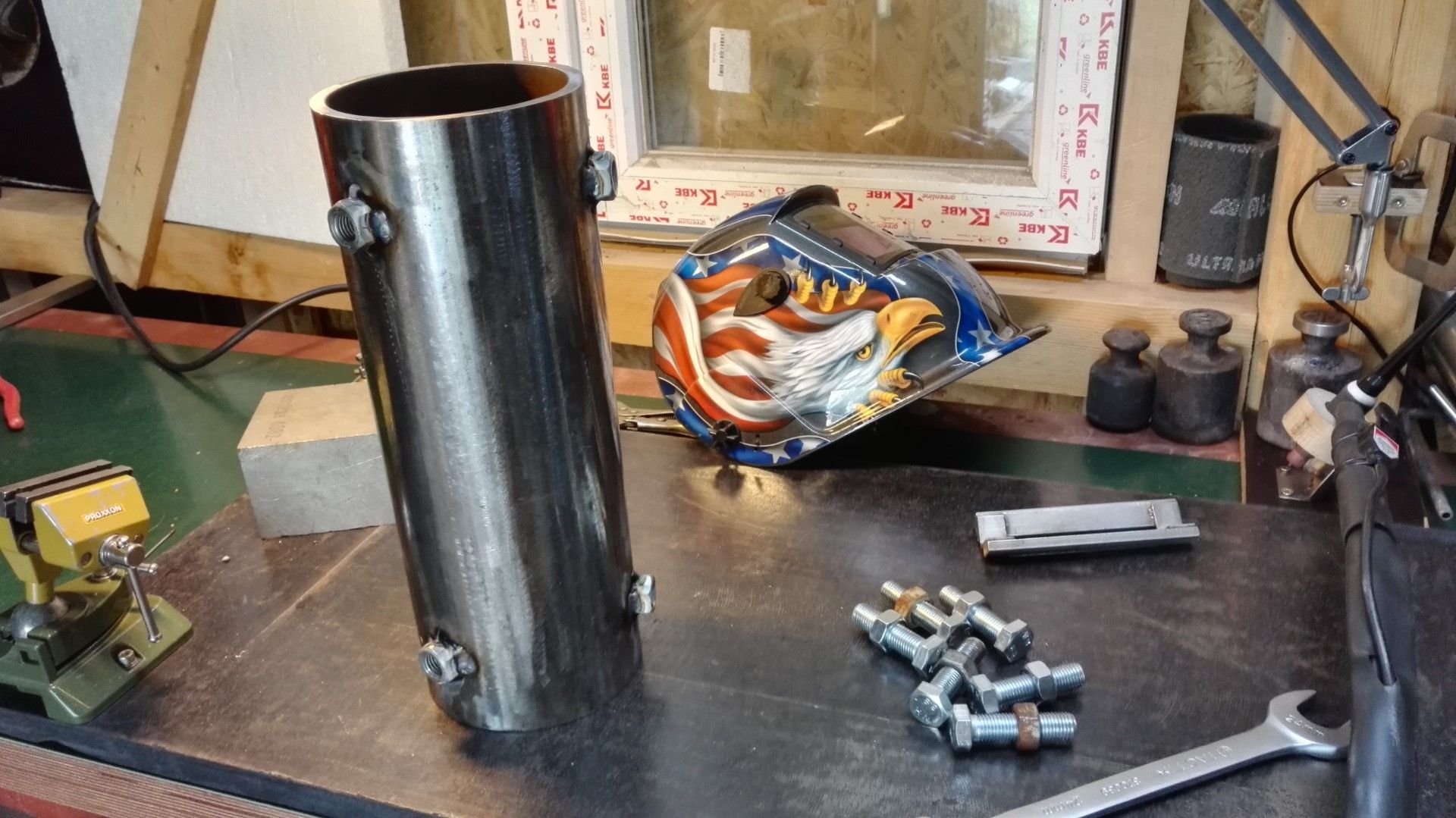

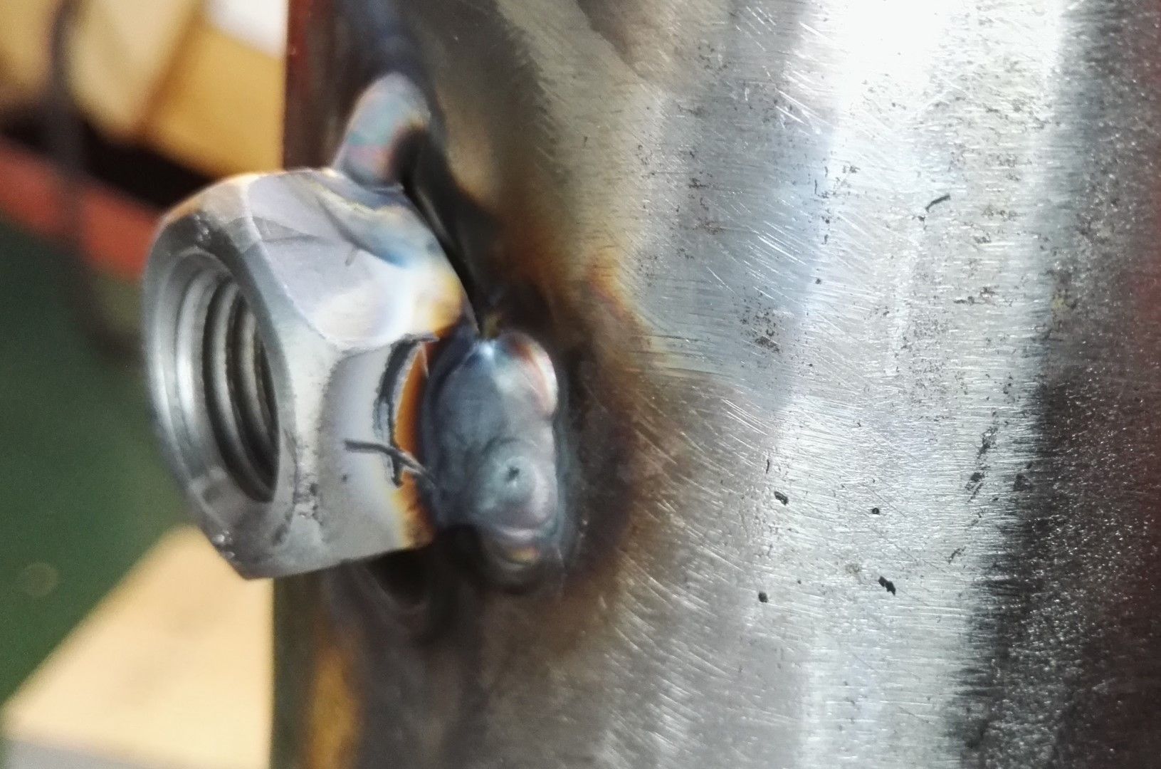

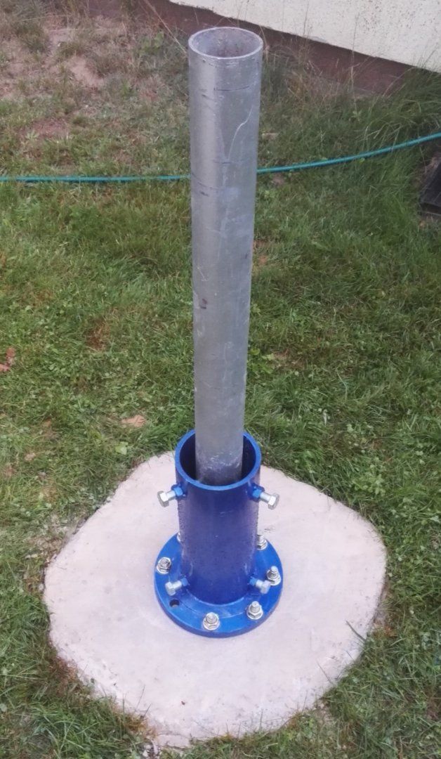

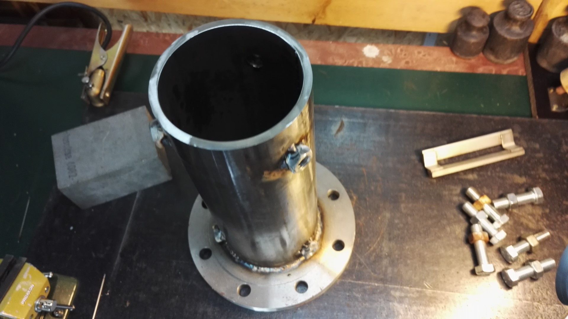

I prefer to do concrete block in the ground (about 50cm wide and 130cm deep) and then bolt piece of pipe on top of it. In this way you get system when it is always possible to insert any pipe inside and make plumb. Go to nearest metal workshop and ask them to make something like this. IMG_20160626_160228 (Large).jpg IMG_20160626_160238 (Large).jpg IMG_20160626_163143 (Large).jpg IMG_20160728_212222 (Large).jpg IMG_20160729_114032 (Large).jpg
