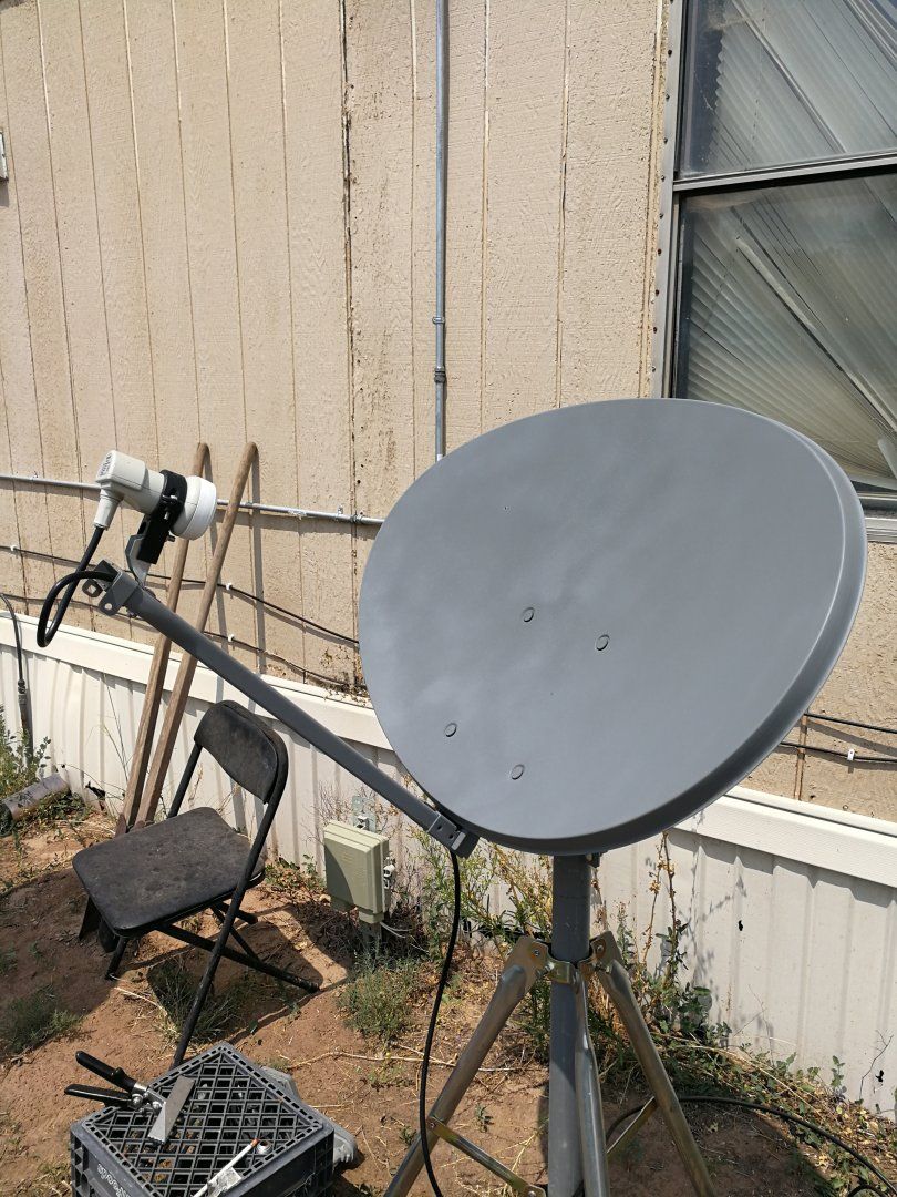

Very do-able, there's a few threads in the FTA section about re purposing old slimline dishes and Orby dishes are basically Ku band FTA dishes. I got a Maverick standard linear KU band LNBF and a bracket off ebay, just measured/marked everything with the old LNBF in place before I placed the bracket. I also rattle canned the DirecTV logo off this morning lol
Same here but still has the logo yet, needs a good paint job! :rolleyes
