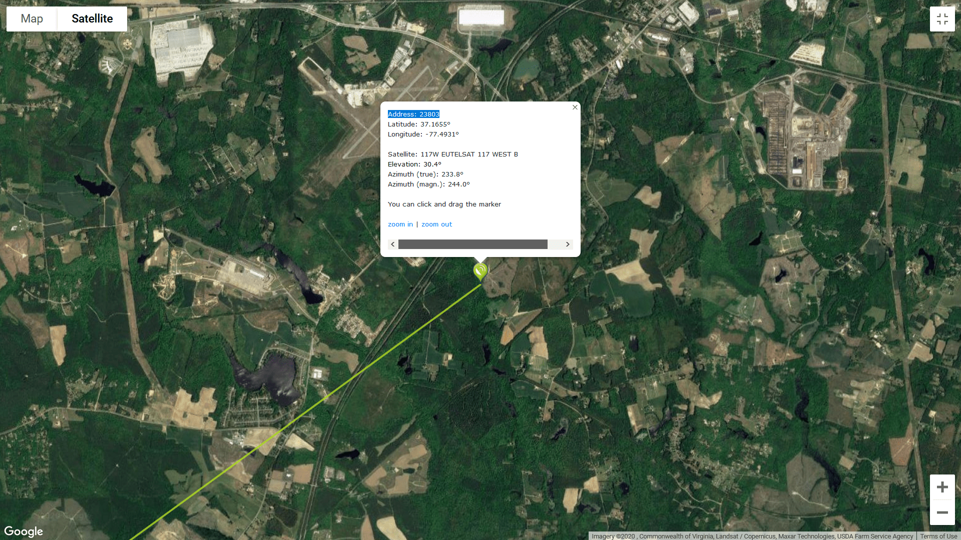

The dish is mounted, and according to orby's site, the zipcode indicates the elevation to be 30.5,skew 39.9 and the azimuth to be 243.8.
Unless I misunderstand, 243 is somewhere southwest. On this site, I read the satelite is located at 117 degrees, which seems to be a southeast direction.
I'm sure this is my ignorance of this subject, but am I wrong in assuming these two bits of information clash?
The numbers look correct for that Zip code in VA. The Satellite is at 117 degrees W Longitude. That places it over the equator lined up with cites west of you, like Boise ID or Las Vegas. To point at 117 W you need to aim your dish at compass vector 243.8 degrees (compass magnetic reading - not true). Elevation and skew look good. Make sure the mast is perfectly plumb!!!
