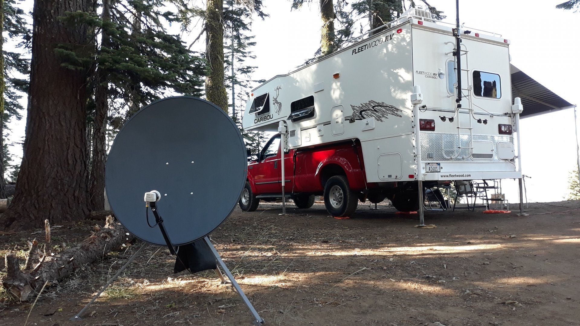

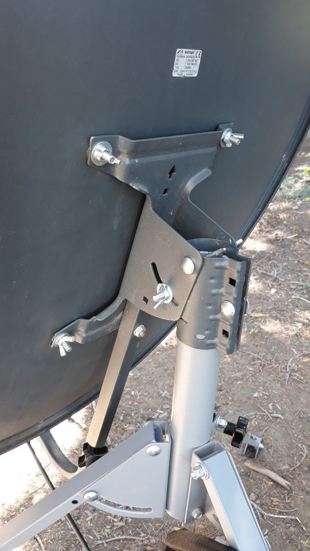

I use two screw in the ground "dog ties" to anchor our tripod mounted dish for longer RV park stays. For short stays, I hang a half full 5-gallon pail of water on it. The dog tie anchor setup has survived 60+ MPH winds with no loss of signal, and the water pail has survived 40+ MPH gusts. In 12 years of use, we've never had a "blow over"...

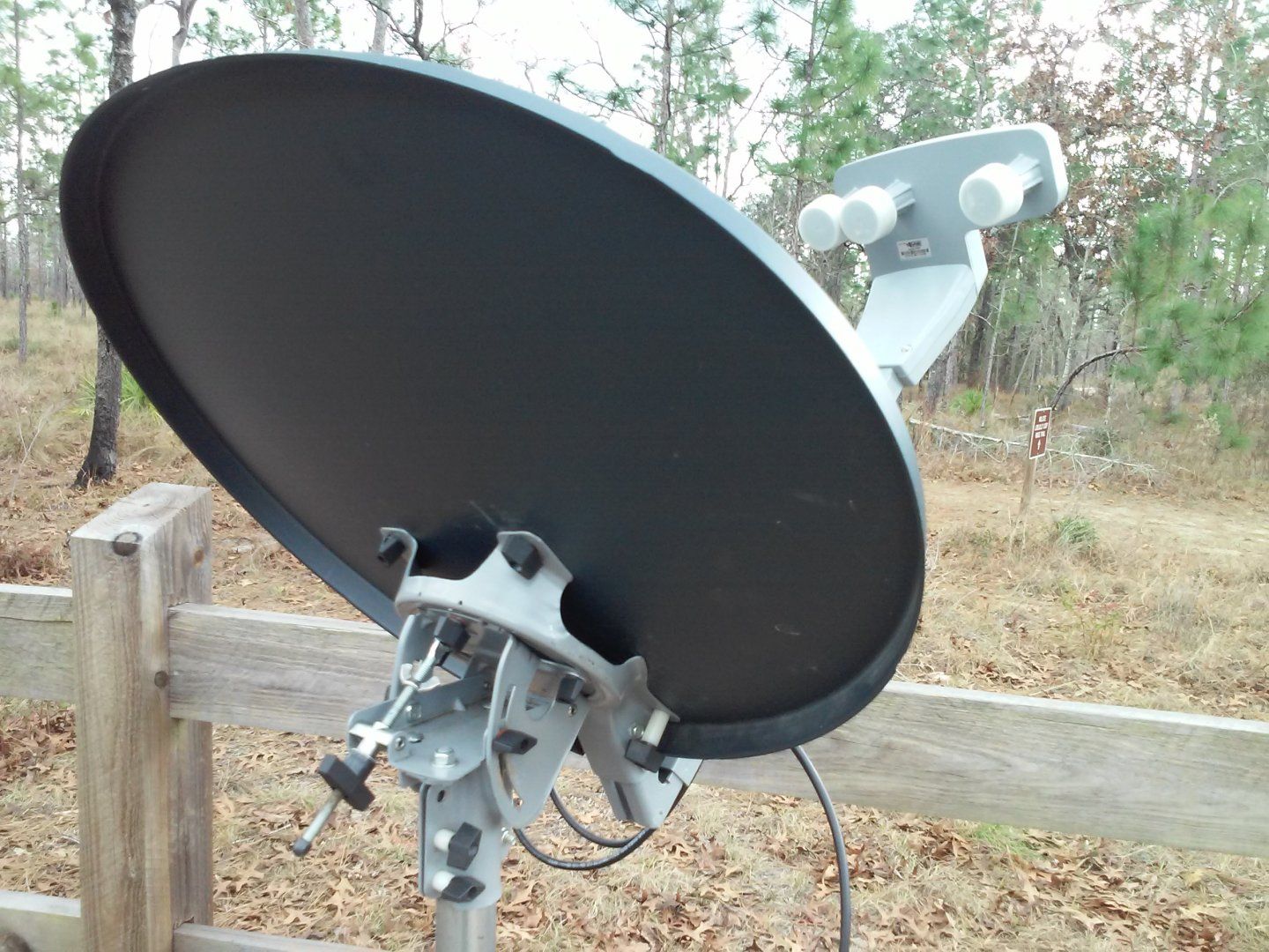

Yep, ~15 minutes is typical for me as well, setting up and dialing in three Dish satellites. My tripod is a standard roof mount that's been modified for easier use and has been modified with leveling feet. It looks like we had similar wingnut ideas. :)

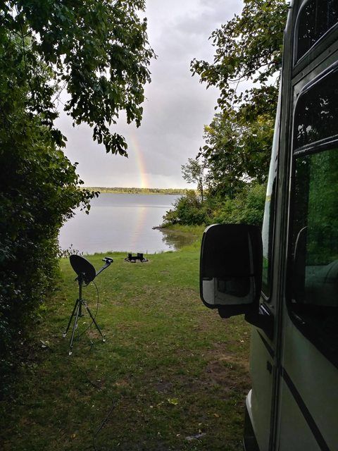

My Slimline hackjob dish is still on a tripod, I'm using some cinder blocks leaned on the legs to keep it from tipping in the wind lol. Been meaning to take it camping.......
