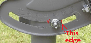

He used that edge I marked in red in the photo to set 39 elevation?
Pole is plumb and skew and elevation close and some patience should find the signal in the SW sky.

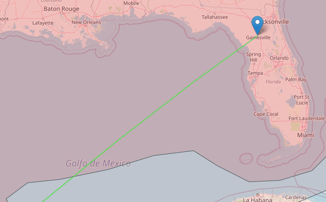

Yes to your ? and ty for that image, very helpful to get us in the general sat direction. We are in 32694 zip
We are set at the original settings that I had listed in earlier post, which he got from the orby sat finder app.

He said elevation is at 38.80. He will move it to 39 when rain lets up.
38.80 is so close to 39 on scale should be able to get signal.

The satellite is high in the sky close to where the sun is today at this time of day in florida.
