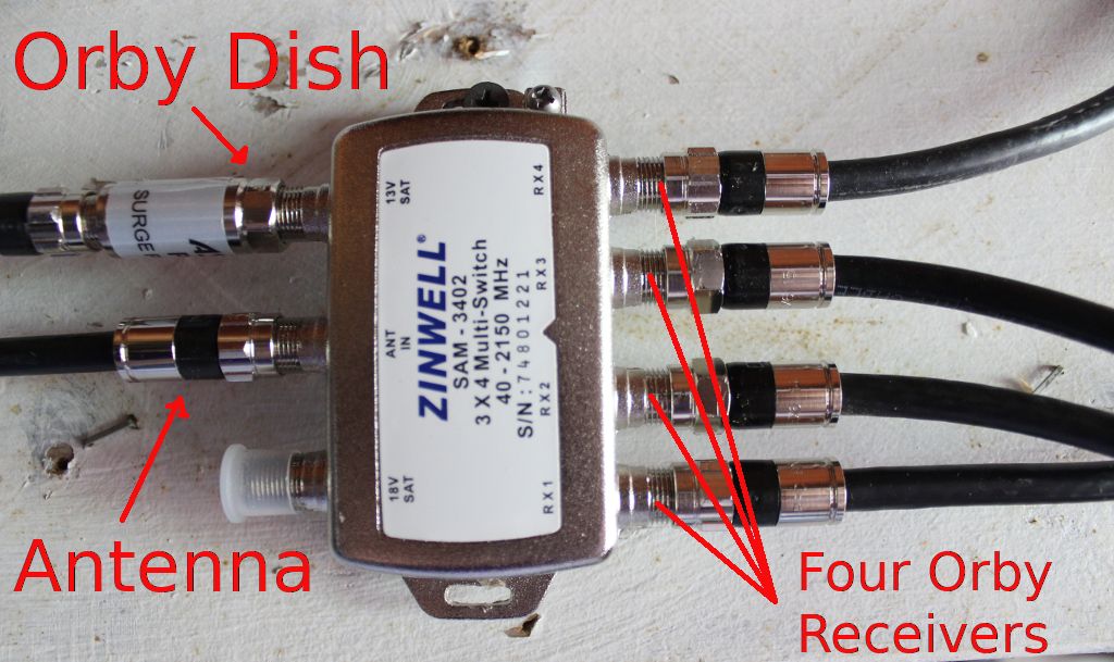

This is my setup that I installed myself. I have a mast-mounted amp for my antenna to boost the OTA signal before distribution. The OTA coax and the Orby coax are fed into a Zinwell SAM-3402 multiswitch which then feeds our four Orby receivers. I also have ASKA PT-1 surge supressors on both coax inputs. Here is a pic of my connections.

Looks like you know what you're doing....but that image is very helpful....thanks!

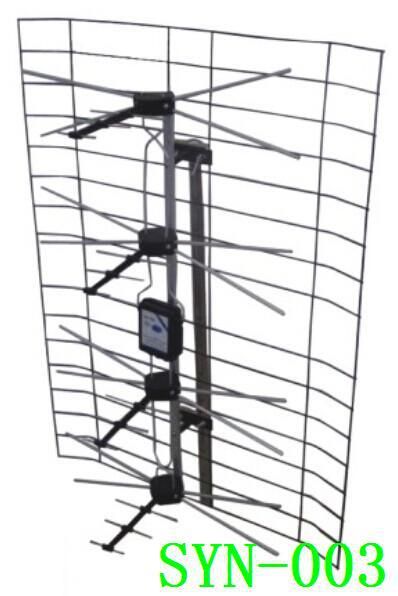

Definitely understand your frustration. Bad enough if you try something and it doesn't work but much worse when it did work and now it doesn't. What make/model of antenna you are currently using?
Wow....couldn't tell you to save my life....its an older one a friend gave me quite a few years back. Looks a lot like the image attached tho.
Looks like an old 4 bay antenna. Since that antenna worked for you before the 2nd box was installed it would be nice to not have to invest in anything new. Is there any kind of amplifier, either on the mast or in the house? If not it might be a good idea to try one before changing anything else. If you can bump up the signal before sending it out to the Orby receivers it may solve the problem. Maybe post up a few pics of how things are connected, at the antenna, where they made the changes to run coax out to the two receivers and any splitters/switches/equipment they connected to coax to.
