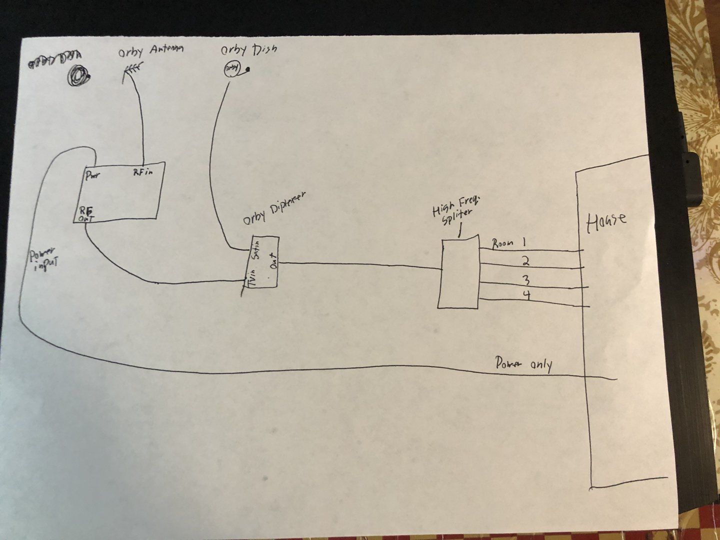

My OTA antenna signal only makes it to 2 rooms in my house (the 2 with the shortest cable runs) but the orby signal gets to all rooms just fine. So i thought about putting a booster on the antenna side to help with the long cable runs (before the diplexer). However it doesnt make any difference booster on or off the OTA signal still only gets to the same 2 rooms. Any thoughts on how to get the OTA to the rest of the rooms? I included a crude drawing of how its set up.

I bet you don't get every OTA channel even on the two rooms. I had the same problem with the splitter. What I did was use a DTV 3x4 mini max multi switch. It has the diplexer built in and 4 outputs.
I do get all the available channels, the little antenna works pretty good. Didnt have antenna or orby in the last 2 rooms before install so i cant comment on that
I bring the OTA antenna and OrbyTv into my house on separate cables. I use a 2x1 splitter to combine the Orby OTA and another antenna pointing in another direction. Finally I use a Zinwell 3 x 4 Multi-Switch https://www.amazon.com/dp/B000MLGNN0/ to distribute Orby/OTA thru the house. Works great.

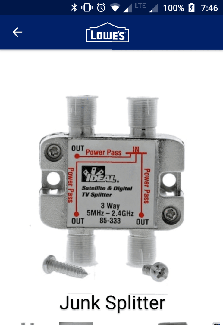

I have a similar problem with OTA signal loss also..I have my diplexer hooked up right at a channel master pre-amp then using a short cable to a 3way splitter I picked up at Lowe's... Splitter has a terrible loss in one port...2 receivers get 57 channels and third one only gets 32..I switched the ports around on the splitter and the one port is bad..Go to your signal meter and check it on the TV with good signal then switch your cable and check each port with the meter..mine was same on 2 ports and third dropped half of the others..I have a Zinwell ordered now..

If all local channels come in fine on one or two TVs, but not on additional TVs, you likely need a multi-switch with a terrestrial distribution amplifier and not a signal amplifier (booster). You need to minimize multi-port distribution loss, not necessarily boost signals at the antenna.

Run the OTA as a separate distribution system, using an amplifier and a regular splitter.
2 cables to every Tv and use a diplexer behind each Tv to combine into the orby box.
The issue is you loose 3 DB at the diplexer at the antenna. Another 8 DB at the high freq splitter and another 3DB in the orby box with the built in diplexer.
That's like 13 DB loss, plus another 3 DB per 100 feet of coax.
If you run a separate system for the antenna and use an AMP to cut through the loss of the splitter, your only loss is the diplexer behind the receiver.
I wish orby would just get rid of the diplexer Inside the receiver
