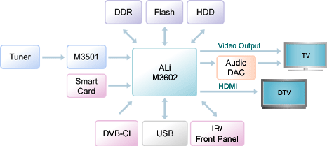

The ALi M3602 decoder supports S/PDIF and 5.1 channel digital audio interface, hence AC-3 out via analog seems to be a HW limitation - not supported.
Not showing the STB menu at 480i resolutions may be purely a FW issue, and needs to be communicated to DVBWorld, as its important. But again, the ALi decoder is for "High Definition Applications", so it may need fixes or feedback from ALi to resolve this if possible. It may be a marketing imposed limitation similar to AC3 via analog.
Stuttering at high bit rates seems to be performance limitation impossible to overcome in current HW configuration, and 4:2:2 playback feels like a similar challenge - not supported by the ALi decoder. It doesn't support SATA, and lists only Jpeg playback via USB or PATA as hardware accelerated, though playback of other file types like Flash may possibly be supported later via FW.
MPEG2 MP@HL decoding profile is 1080i 4:2:0 with max bitrate 80 Mbits/sec (theoretical)
H.264 HP@L4.1 is 1,920×1,080@64 f/sec
Most of the remaining reported issues are lapses easily fixable in next FW releases, except of course improving tuner & demod sensitivity, though it wasn't much of a concern in most reports.

The Dolby compliant sign doesn't mean the ALi chipset supports Dolby digital audio conversion to 2 channel analog audio - or it does? The decoder supports 5.1 digital audio out, on its Diagram Audio DAC is show as an external device. But the Audio DAC (Digital-to-Analog Converter) chipset may be soldered on the main board - you can check it. If its there - then its a fixable FW issue. ;)
