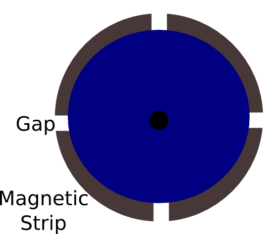

What has bothered me is the actuator.
1. It is an "East-coast" style mount while the dish is located on the West-coast.
2. It looks like the "rotation counter disc" has a magnetic strip around the edge and is clipped at every 90 degrees for a total of 4 notches.
