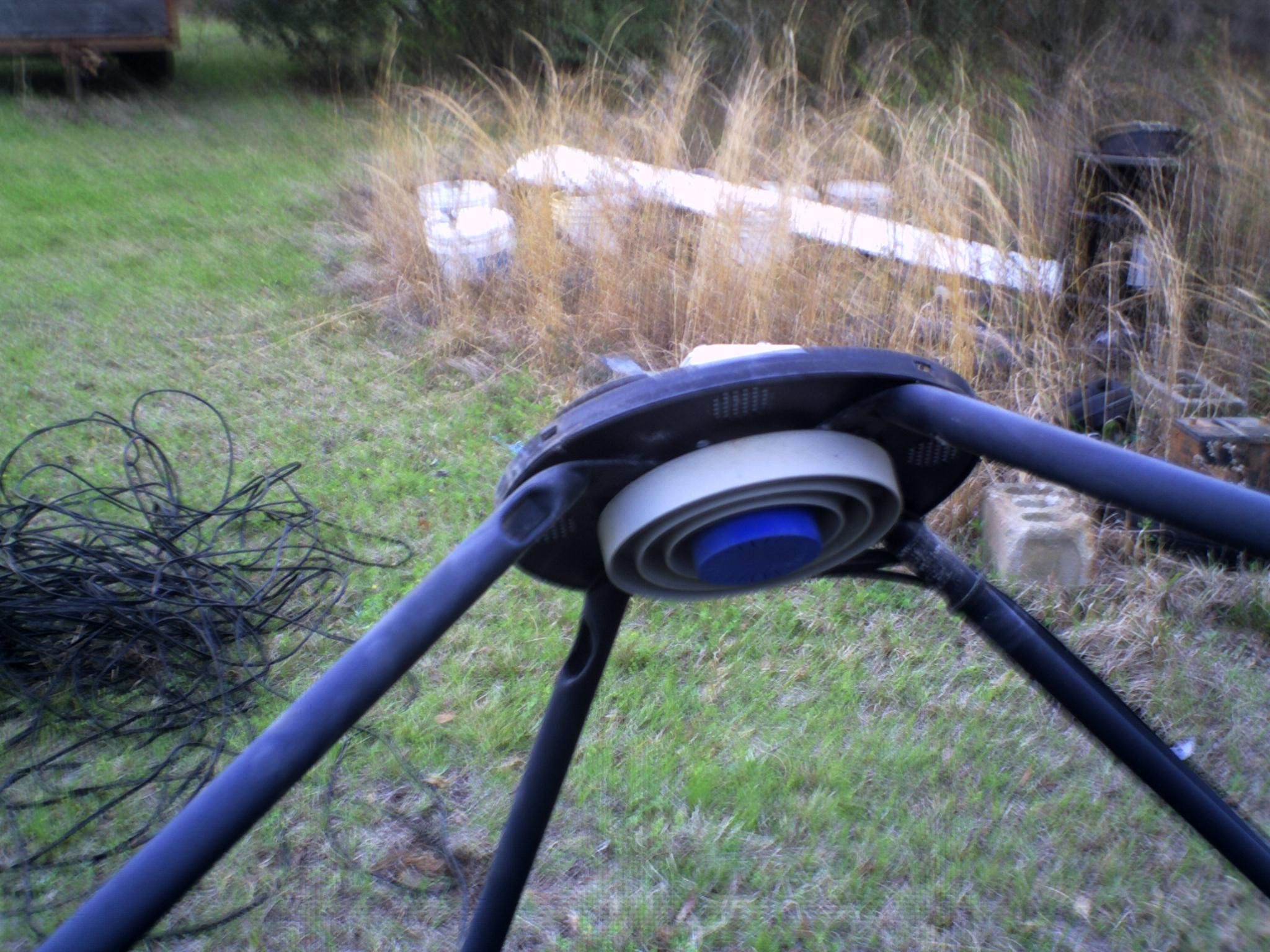

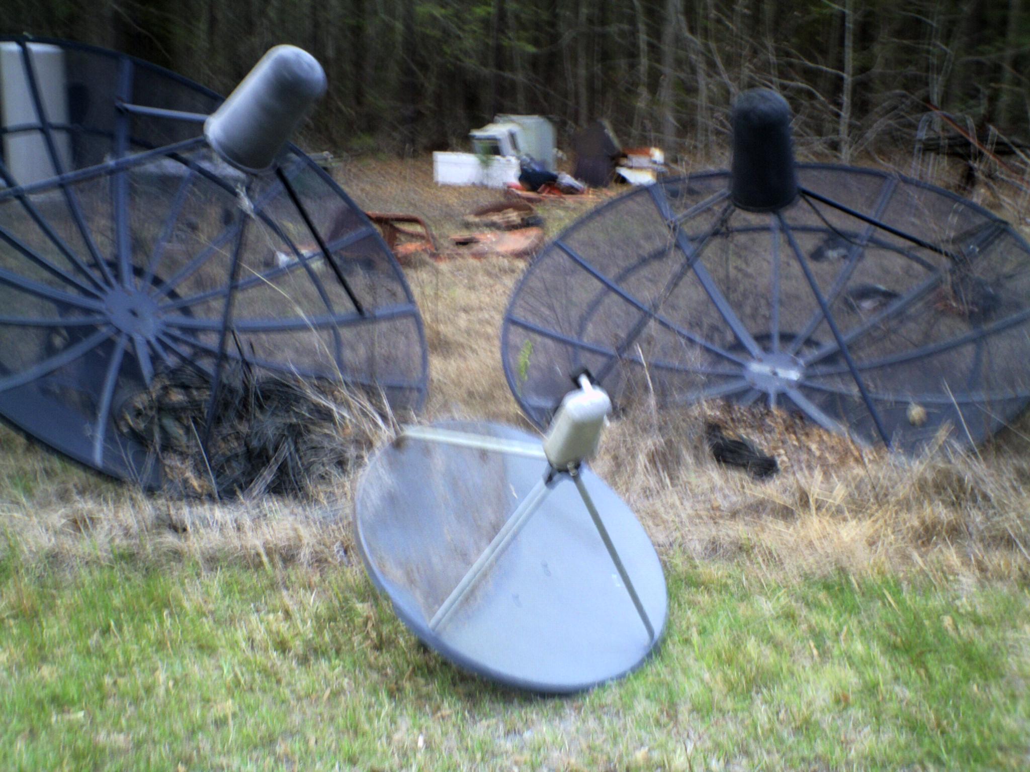

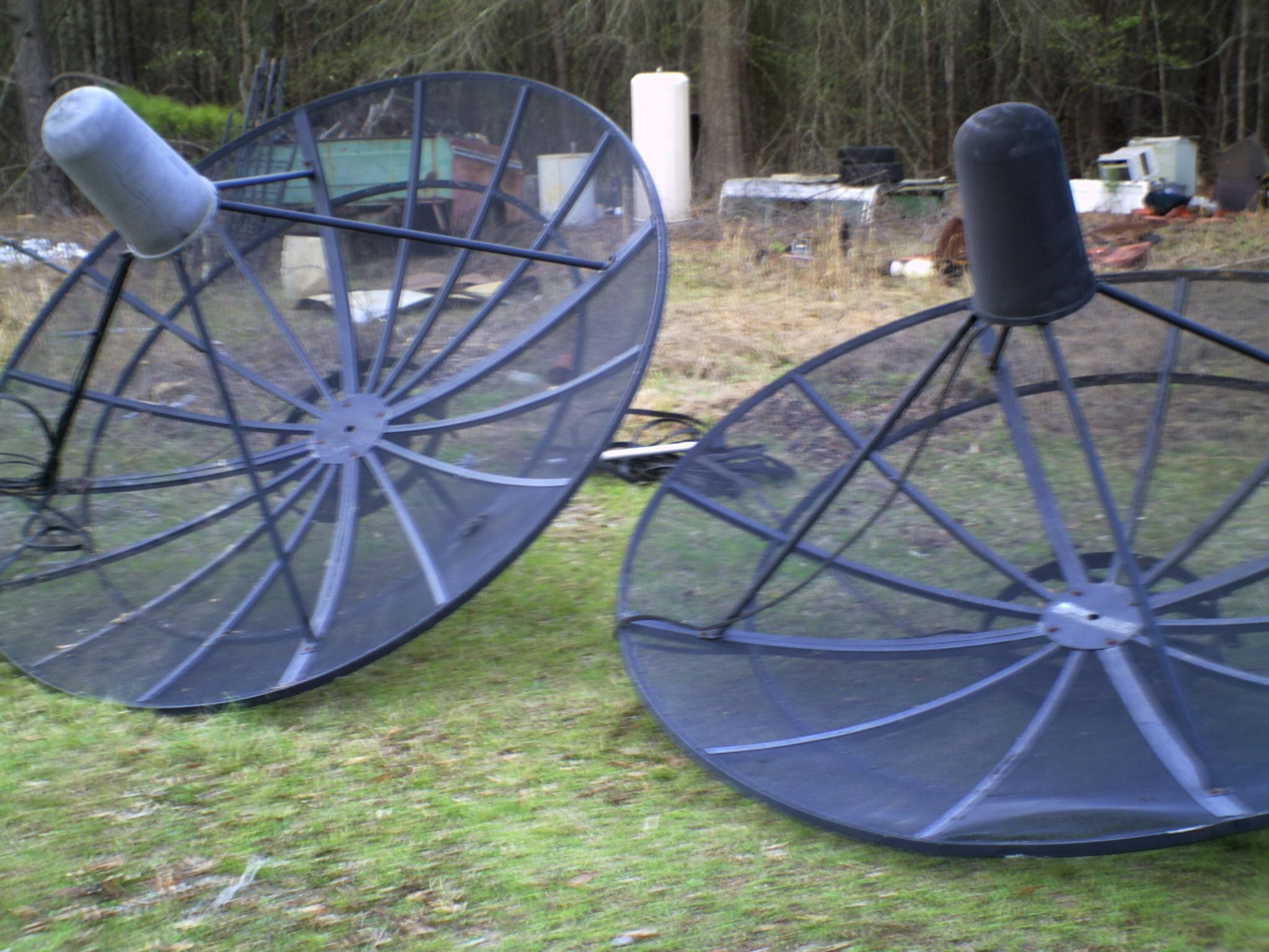

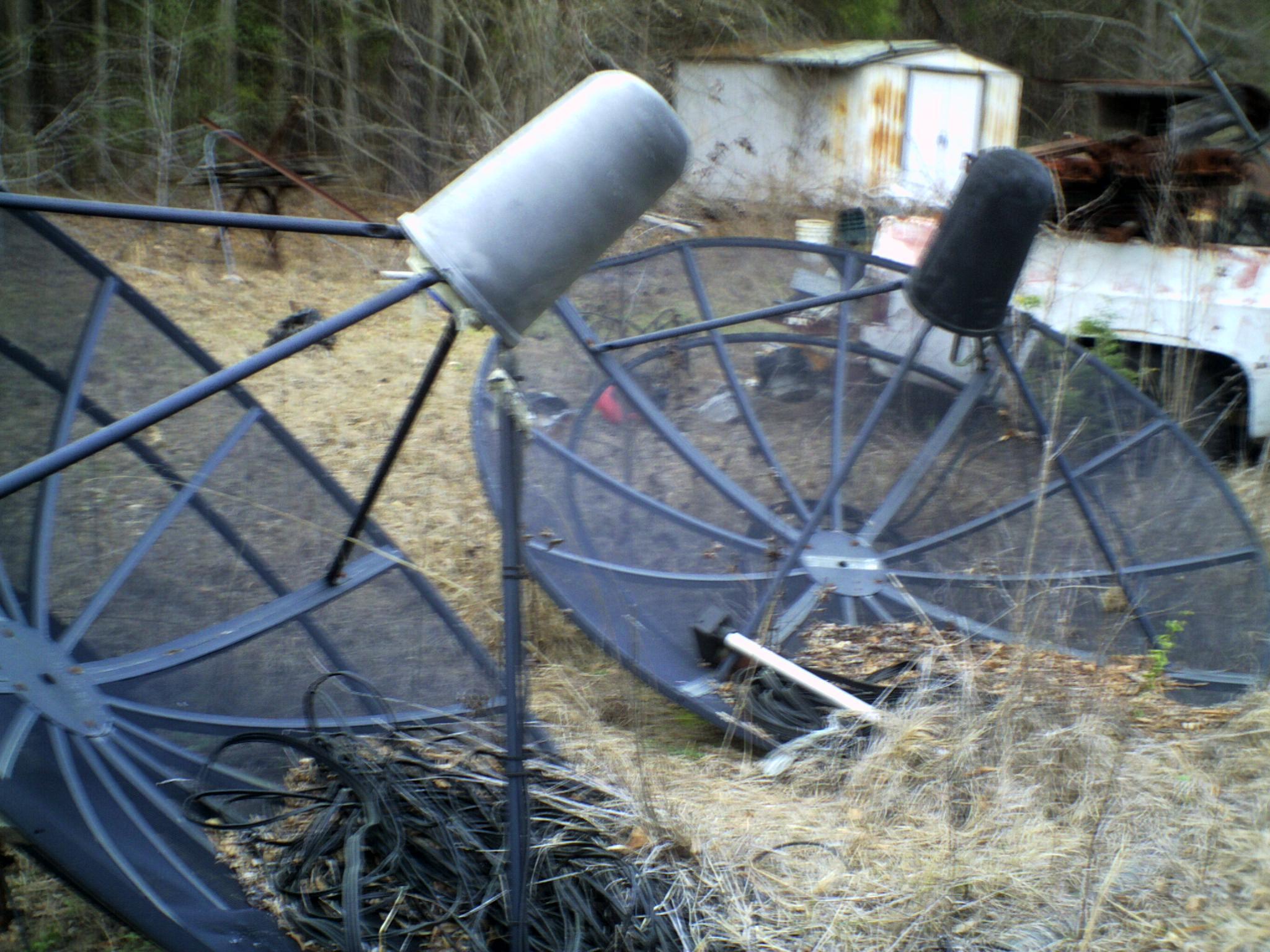

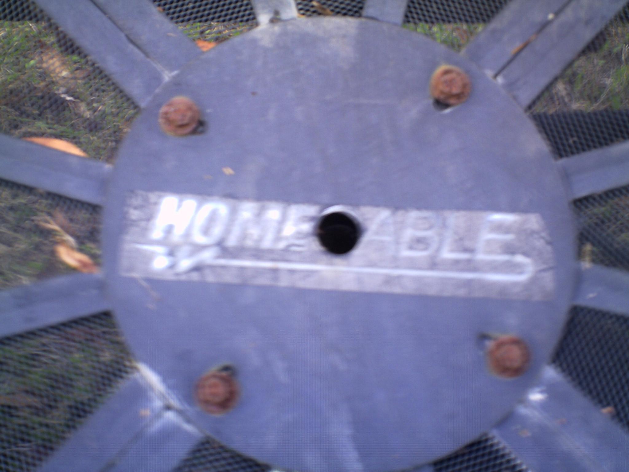

Here is what I have so far.

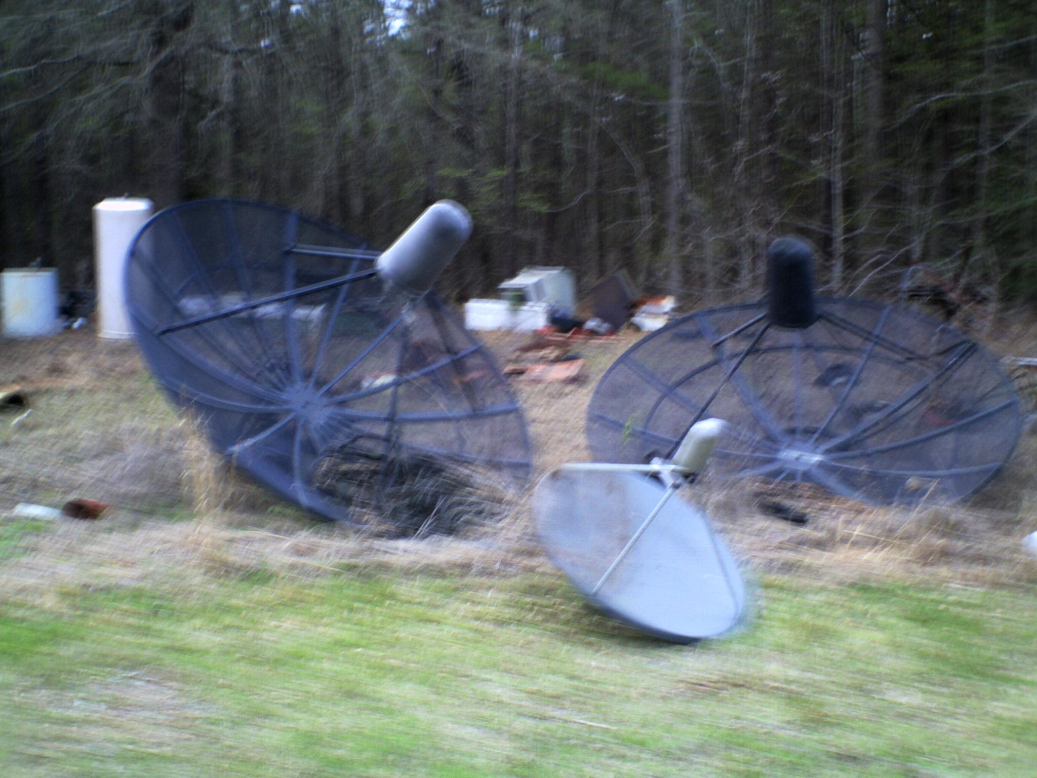

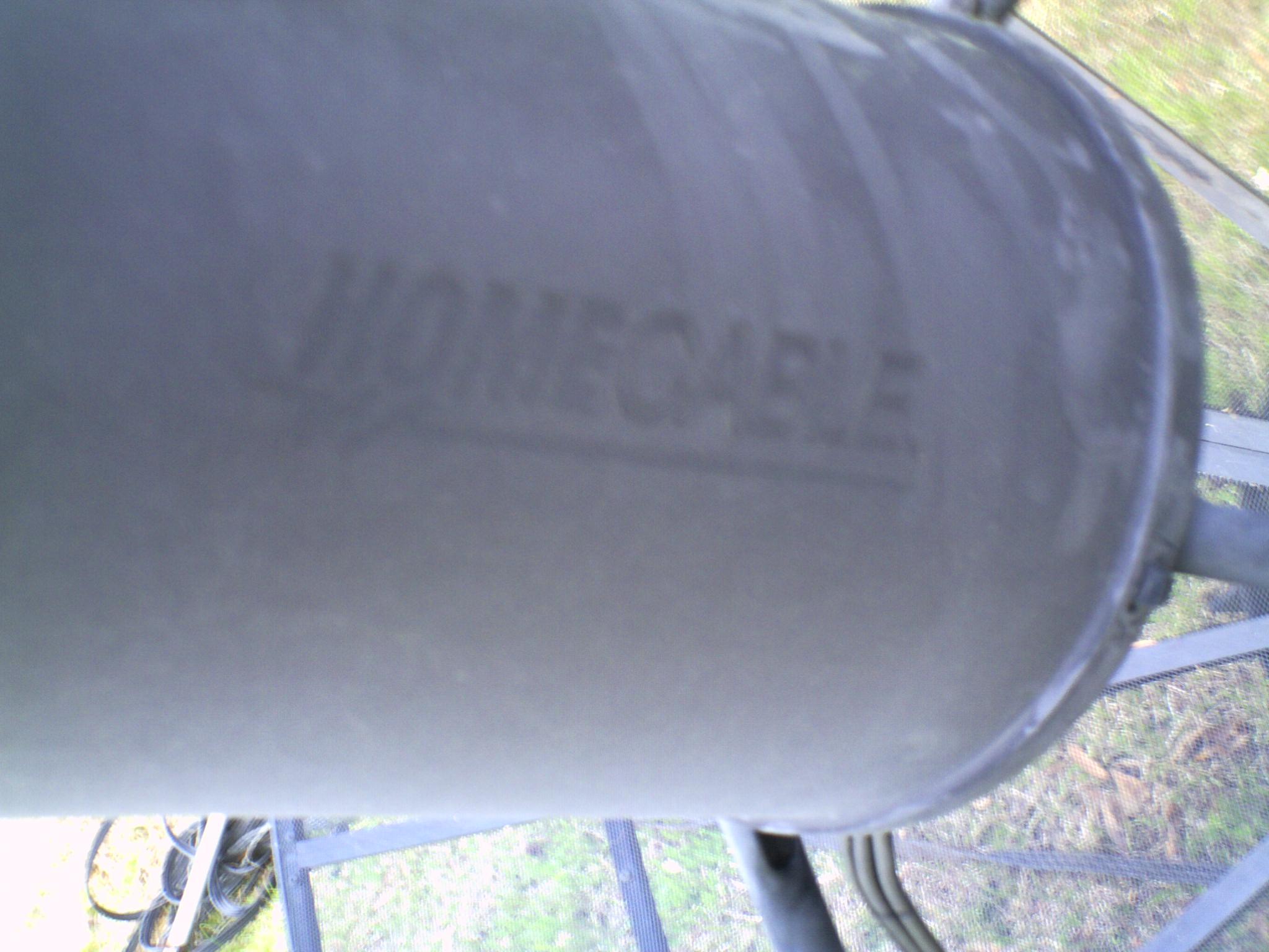

Two Old Buds- Home Cable [tm]
Both are about 7ft 5ins.
I measured them twice and that is what I came up with both
times, not sure how exact that is.
Mesh type dishes.

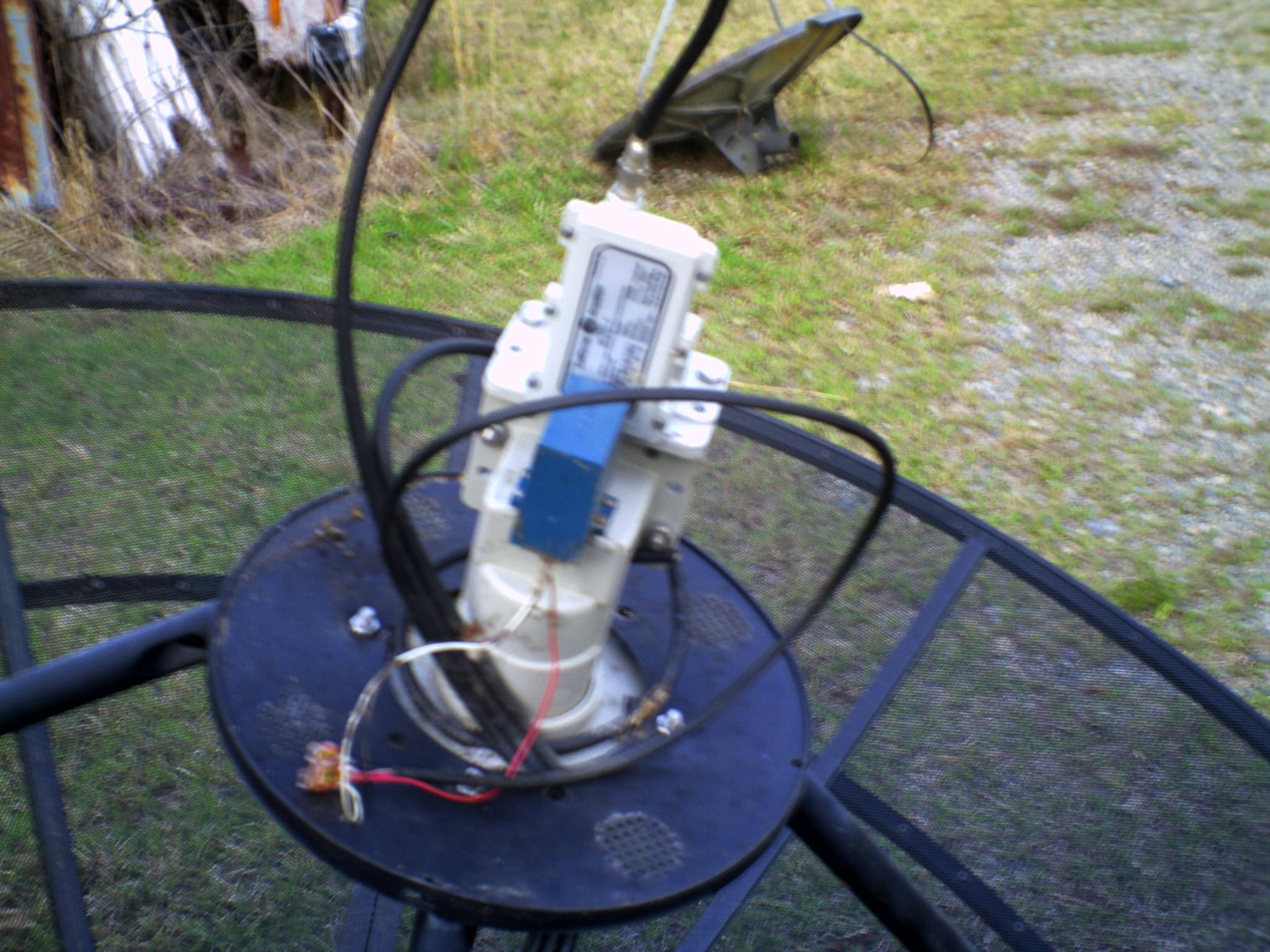

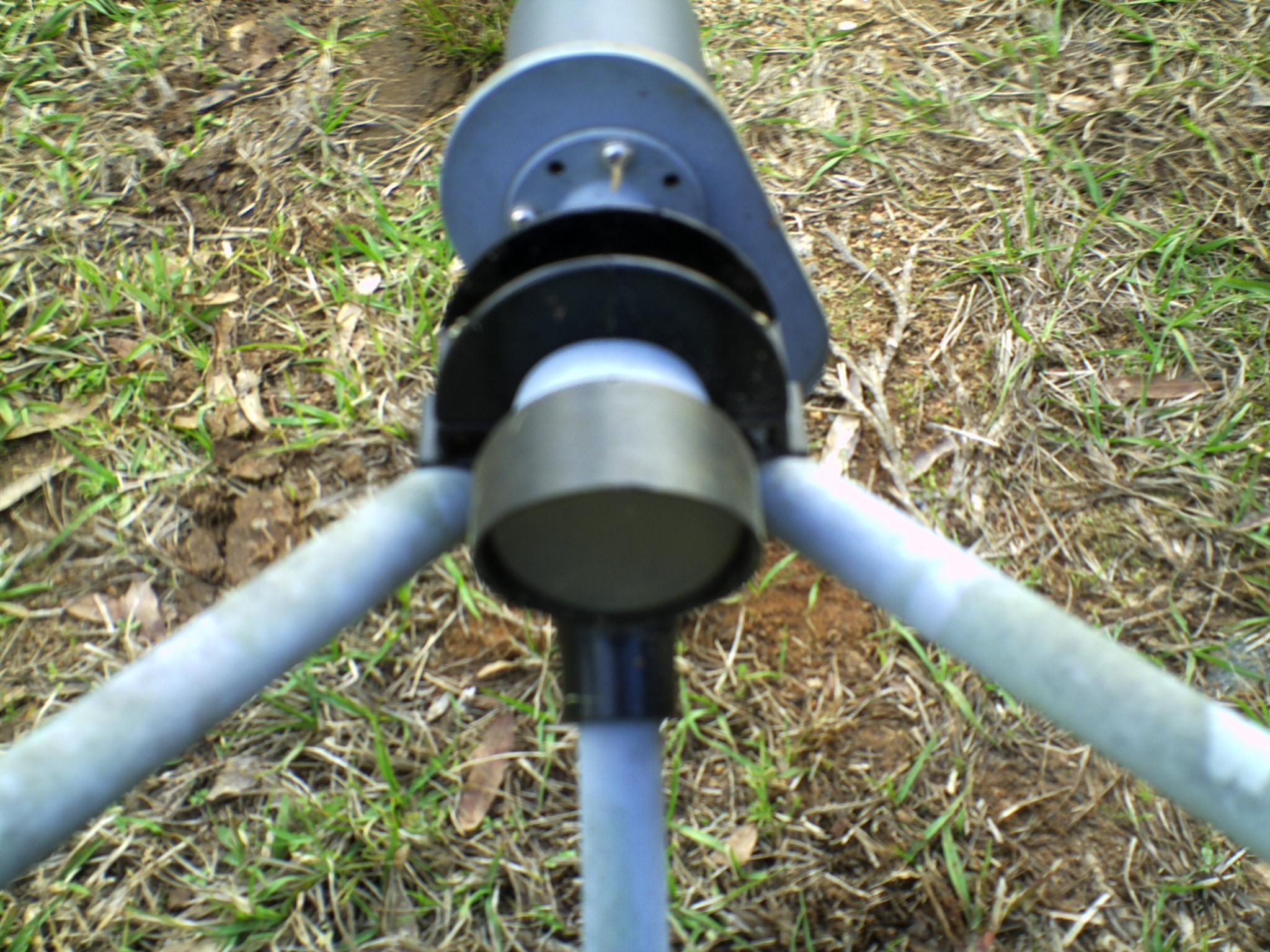

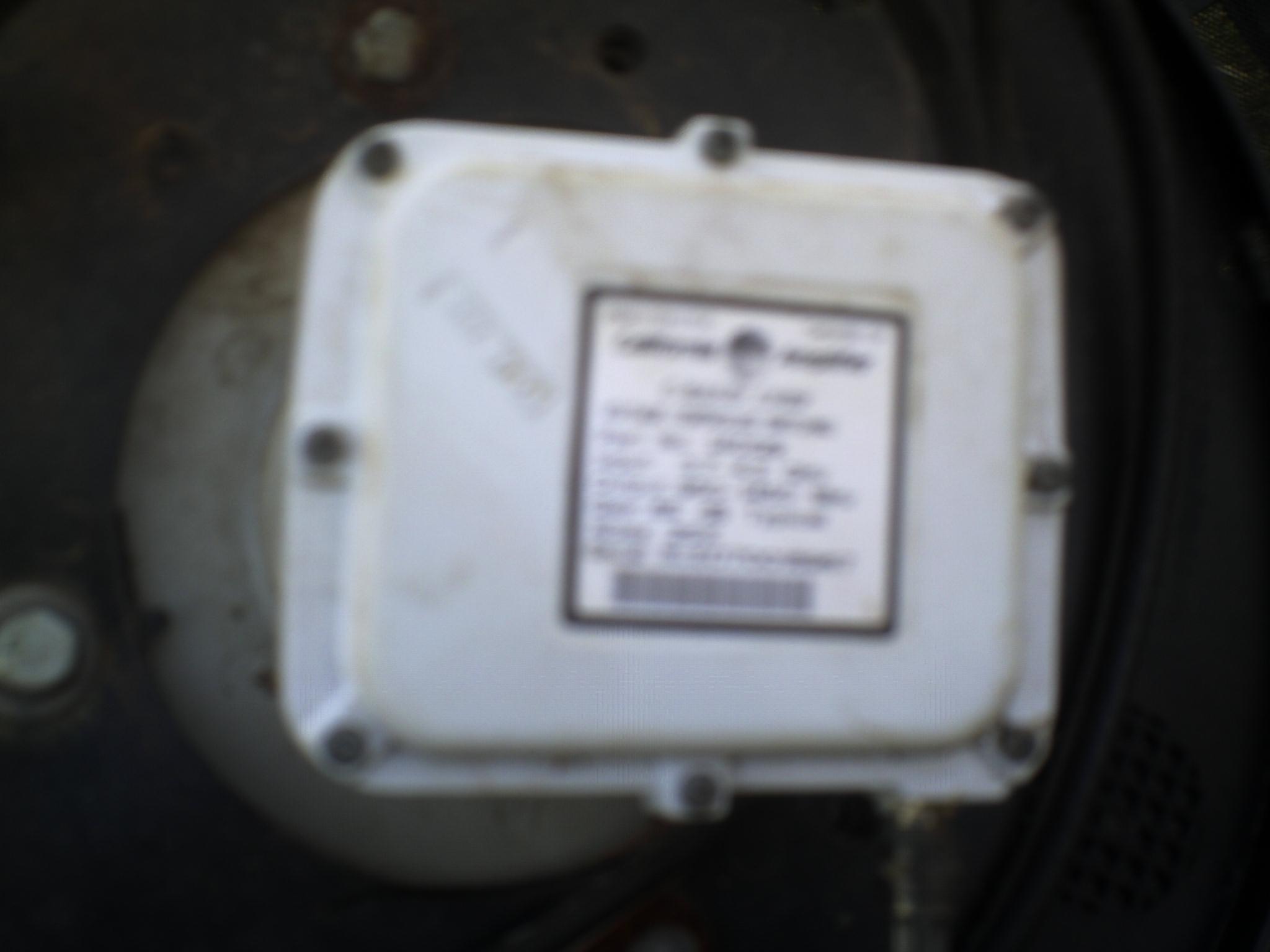

Bud 1
has a California Amplifier,Camarilo,Ca.
C-Band LNBF
Voltage Controlled Switch
Part No.140129
Input:3.7-4.2 GHz
Output:950-1450MHz
Noise:25k
Gain:65DB Typical

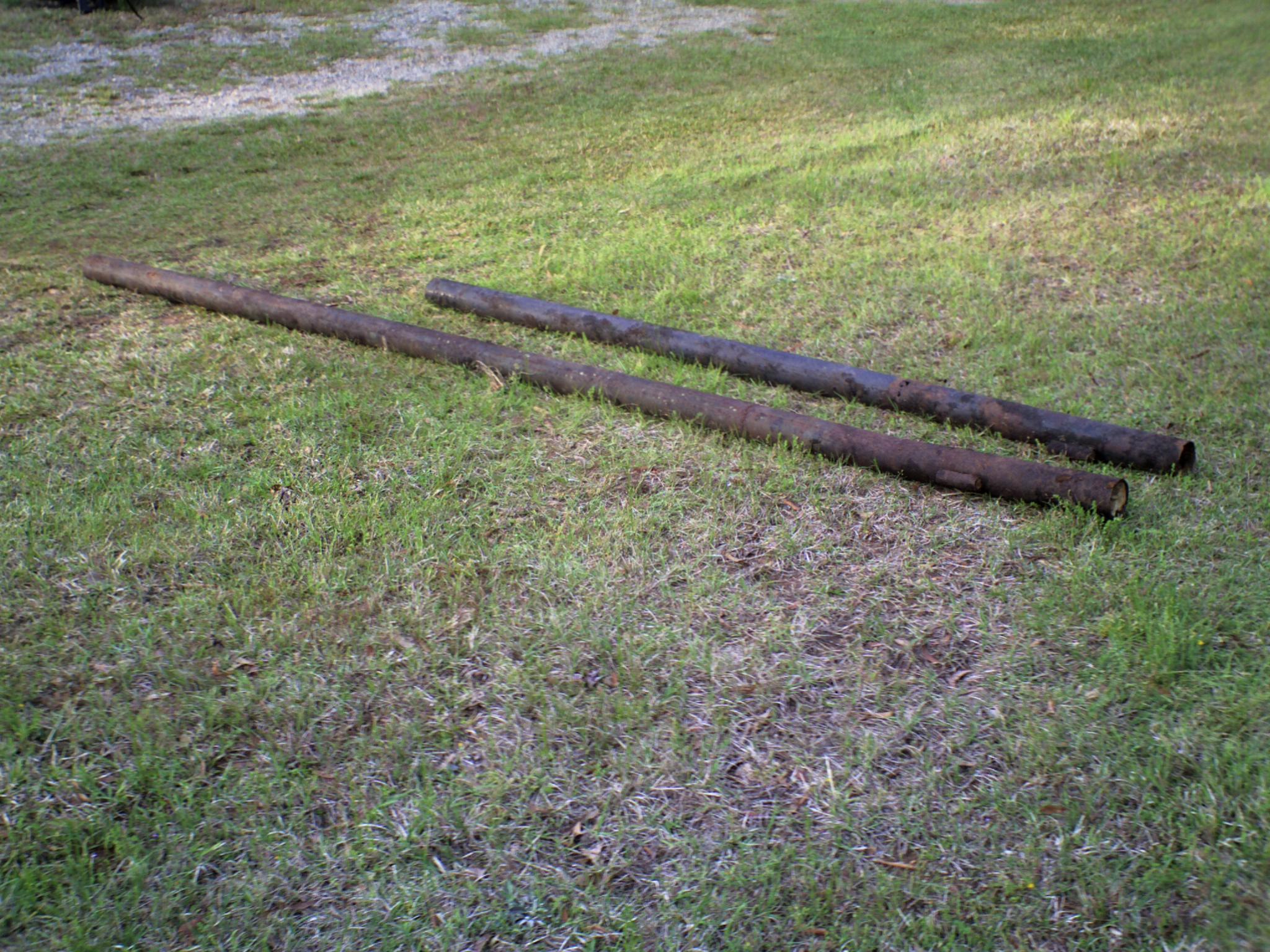

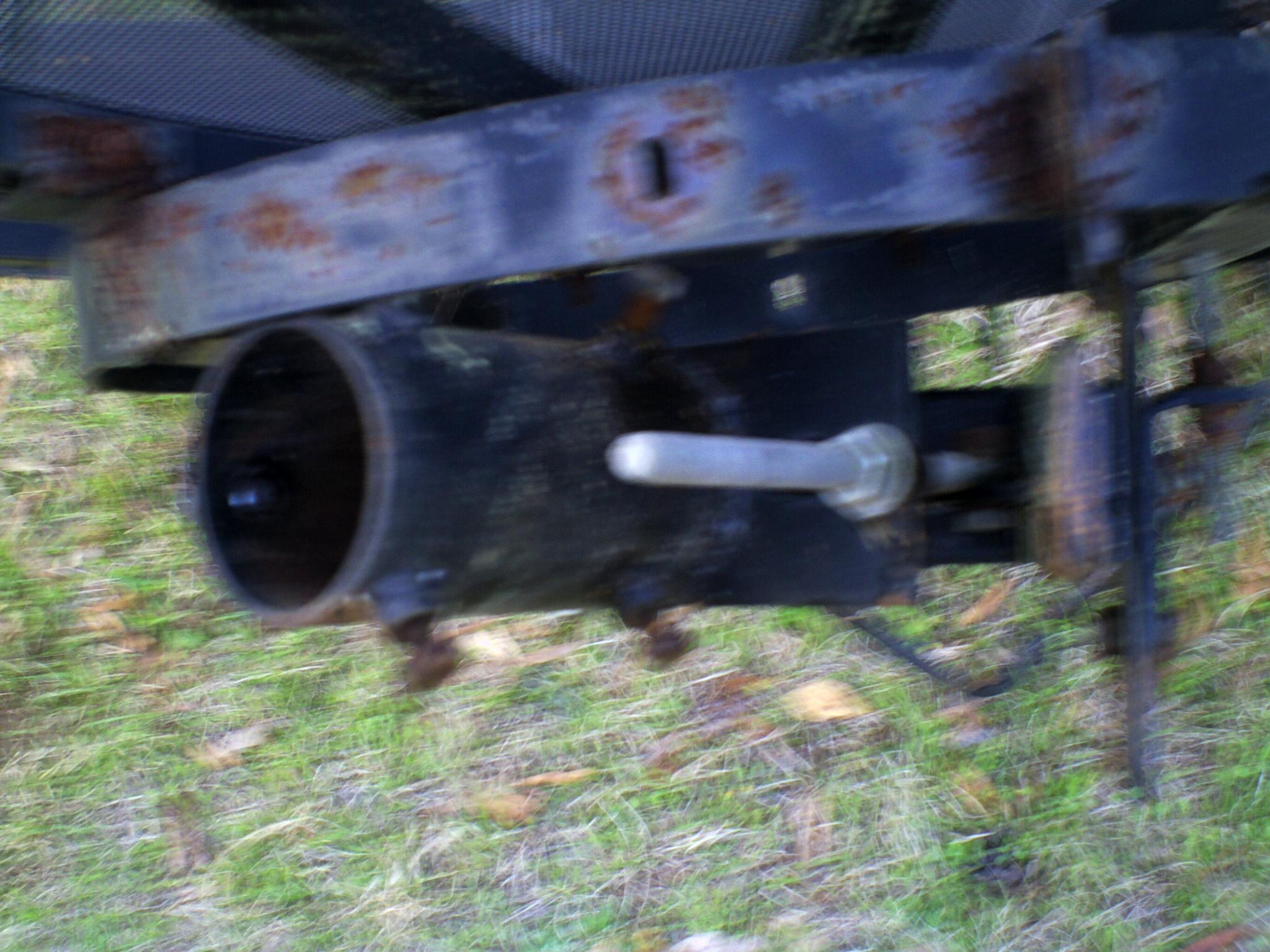

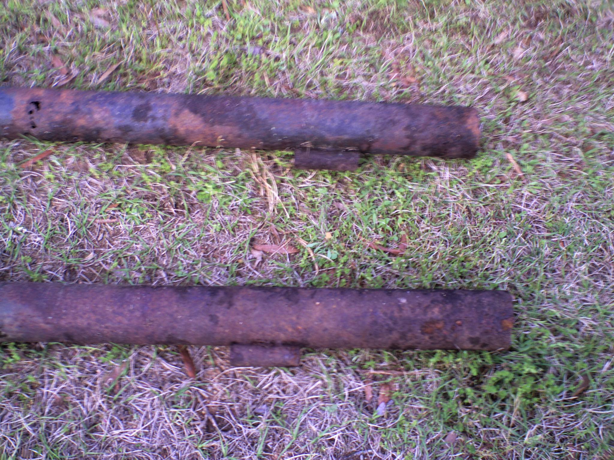

Pole = 11.5 feet by 3.5 inches
Receiver is
Home Cable [tm]
DBS Communication Computer HCC9300
Video Cipher RS
Descrambler Equipped
By Uniden Model No. UST-4400
Renewable Security A040-VC2+,or plus series.

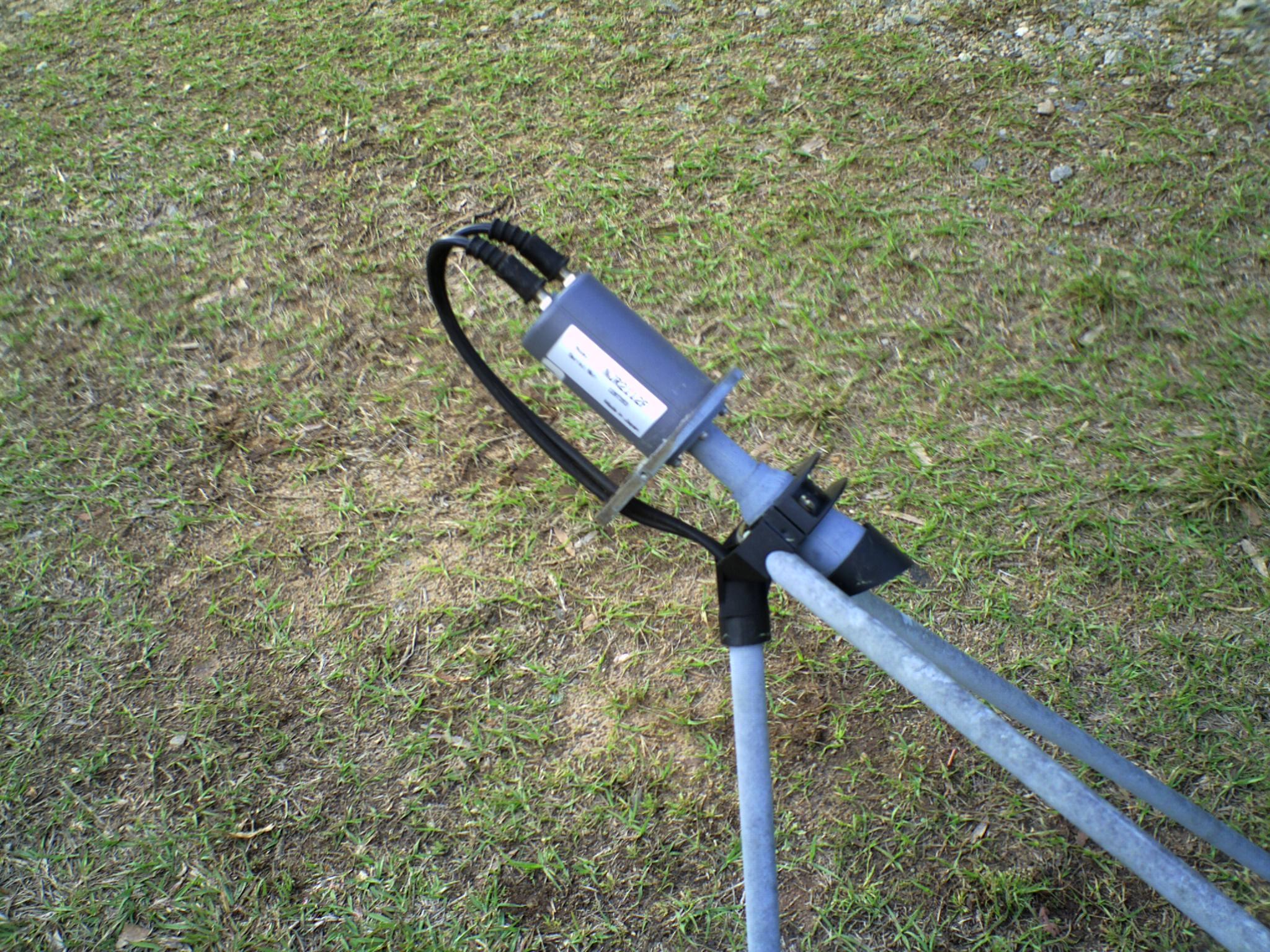

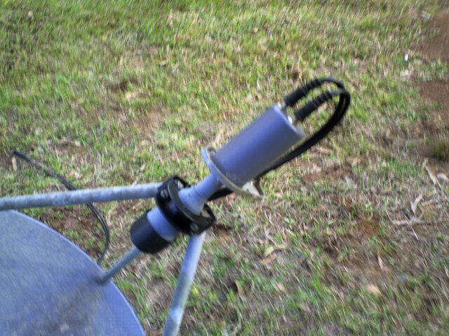

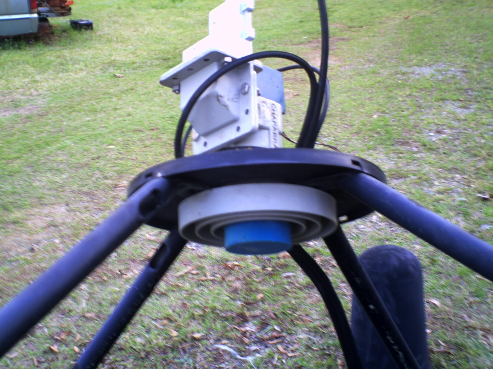

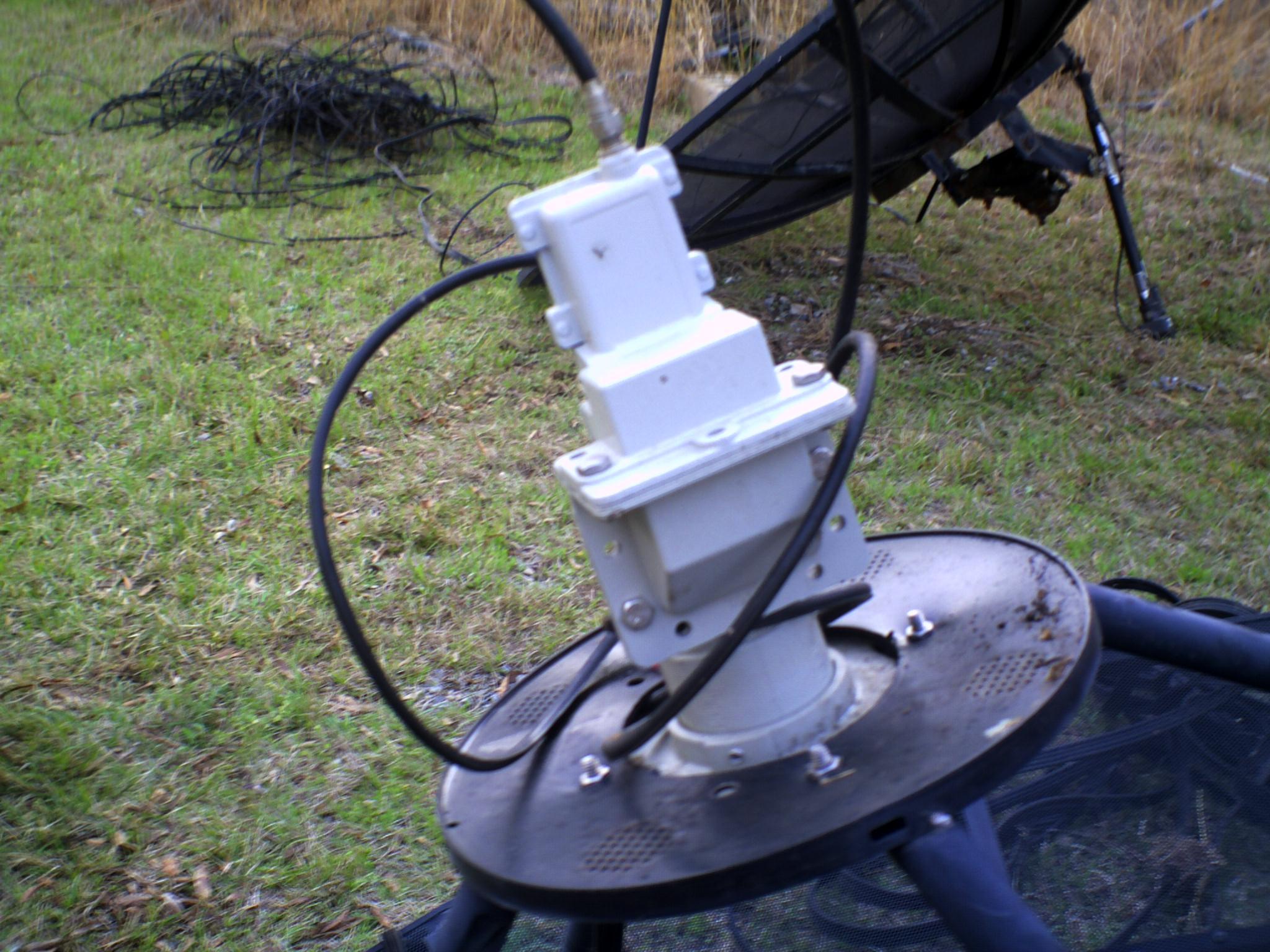

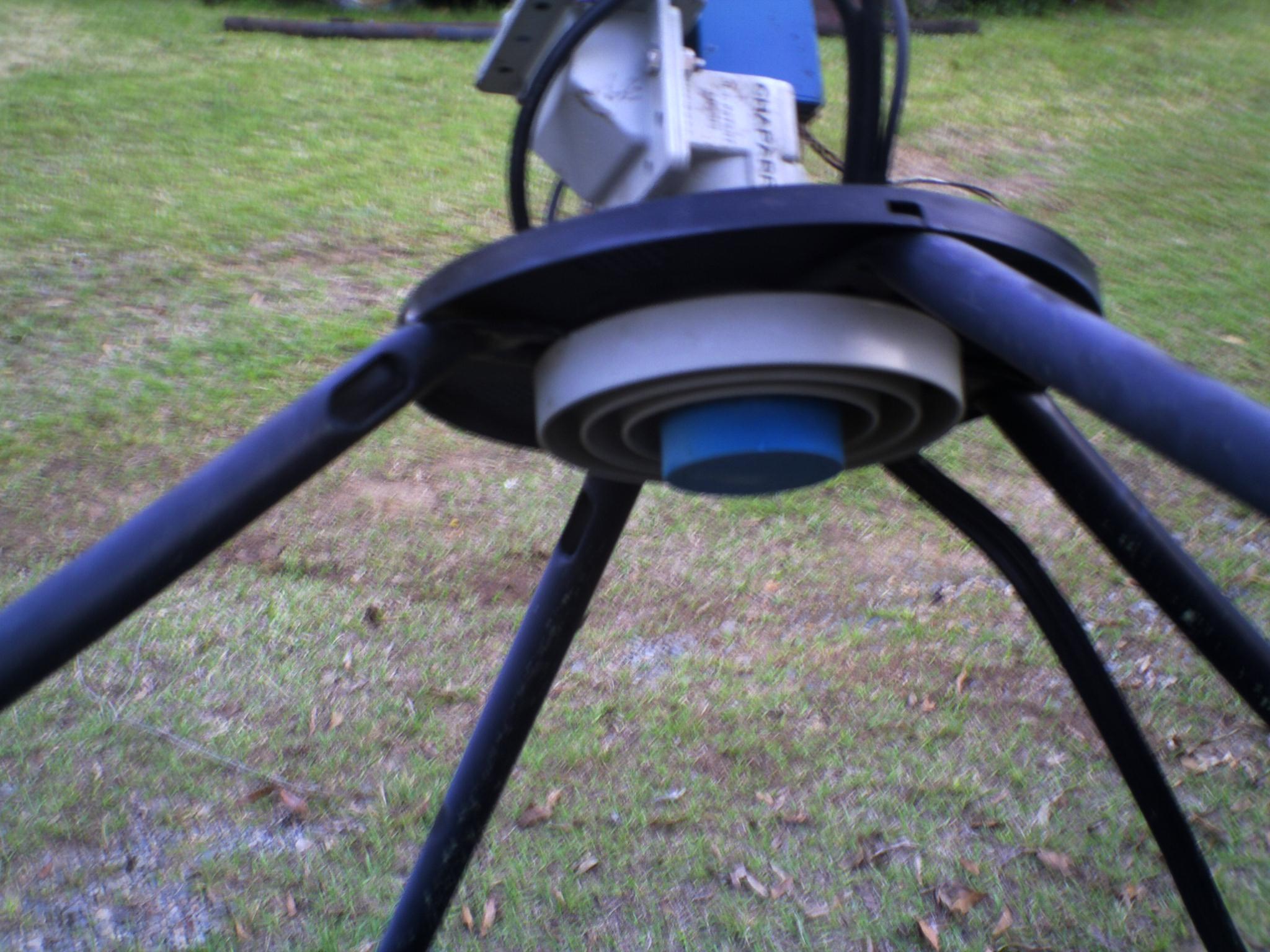

Bud 2
LNB= Chaparral
Mag7
HEMT Low Noise Block Convertor
PartNo.C31244
Input:3.7-4.2 GHz
Output:950-140MHz
Gain:65DB Typical
Pole = 8ft by 3.5 inches
Receiver is
Home Cable [tm]
Video Cipher RS
Videopal
Order Recorder
Video Cipher Scrambling Format
General Instruments Corporation
By Uniden Model No.HCC 9400
Renewable Security A090-VC2+,or plus series.

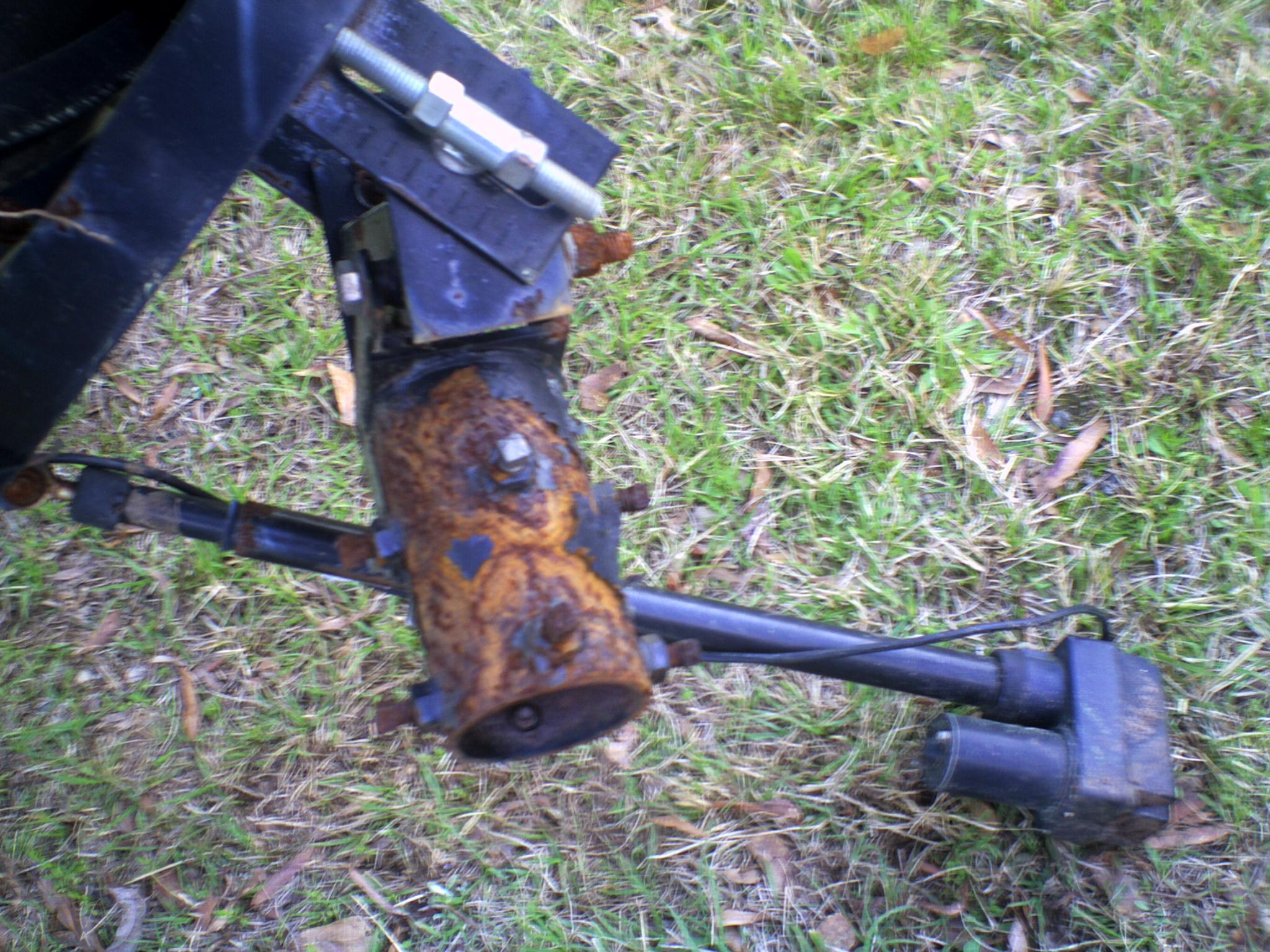

Like to control bud movement?
Will Uniden still repair these? If not worth repairing,
I will have to find another control unit or buy a gbox to control motor right?
The other unit Uniden HCC 9400 powers on ok.
So I can use this one to control bud movement for now?
But I need to replace permanent backup battery as describe in another post on this site,before it goes dead?
Can one unit control bud movement on both bud motors?
Just wondering? Maybe with a switch?

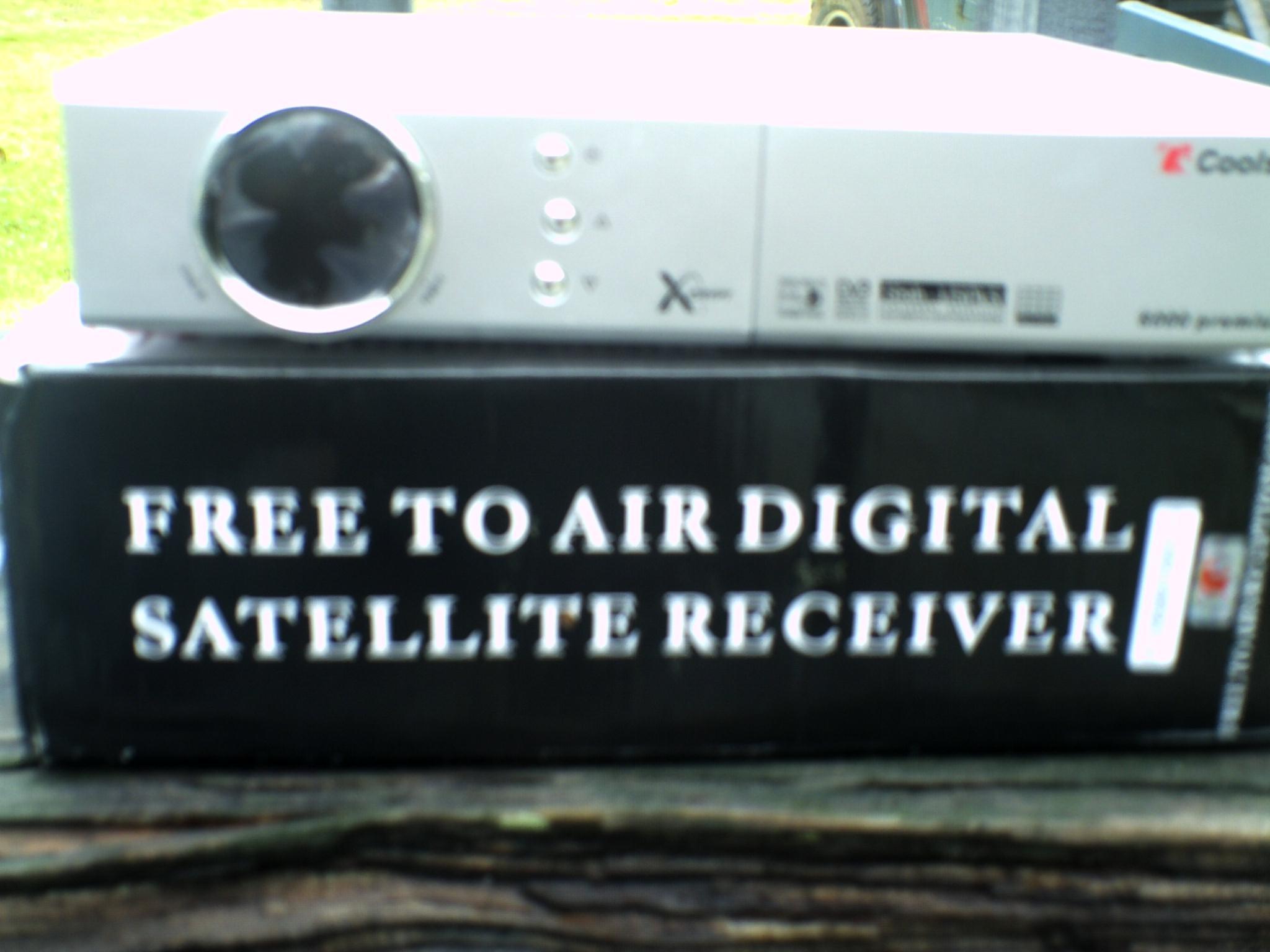

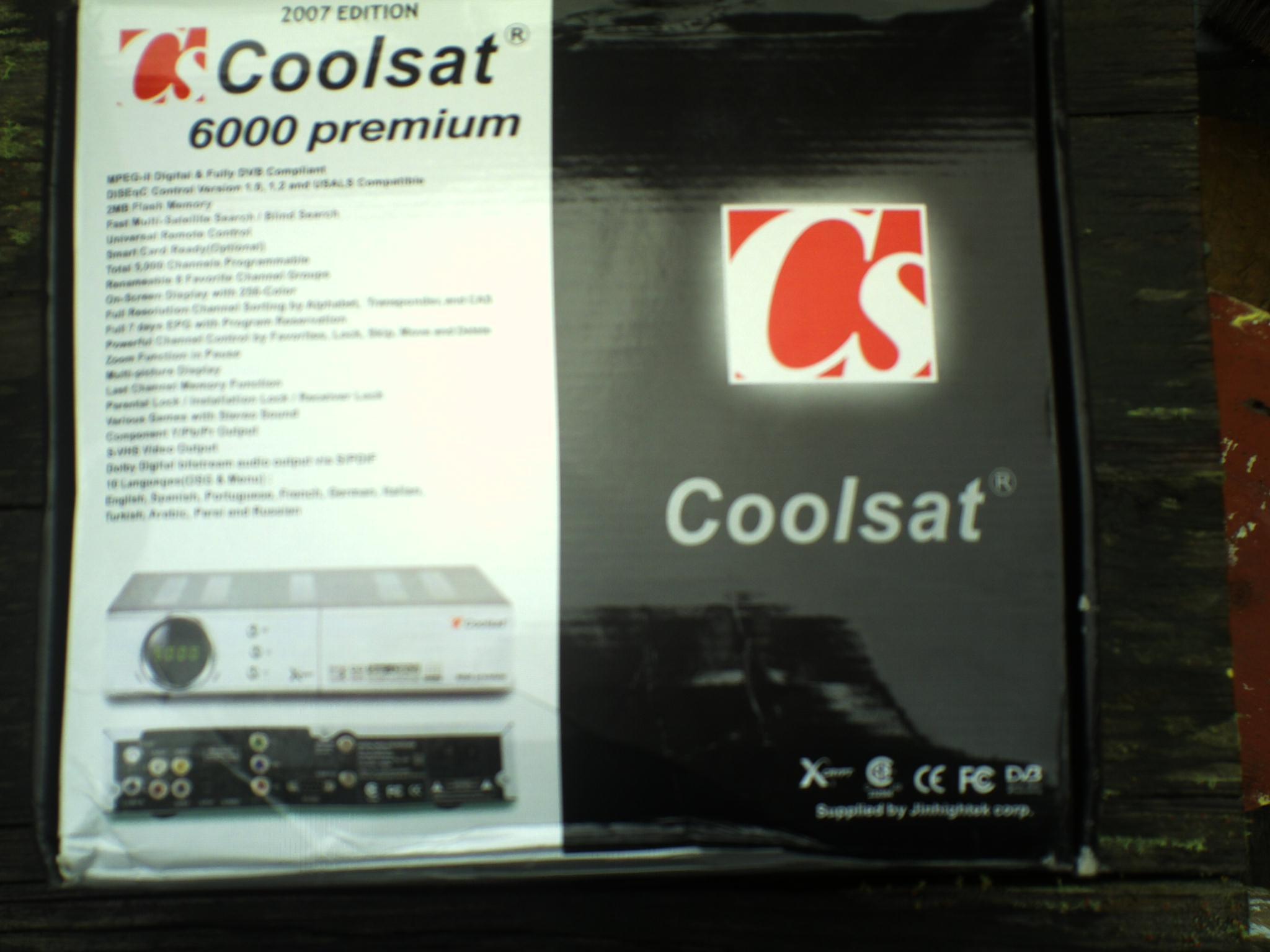

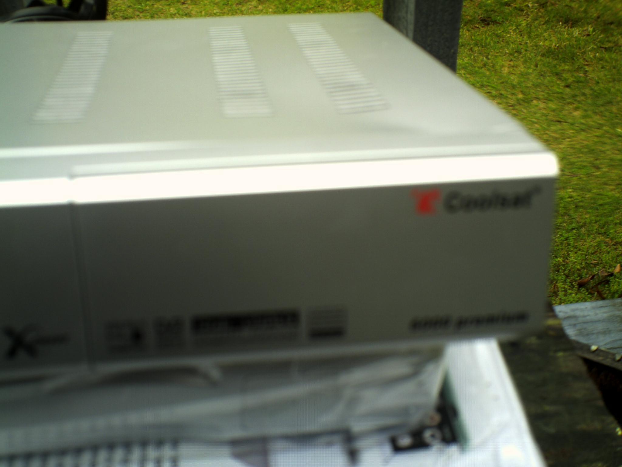

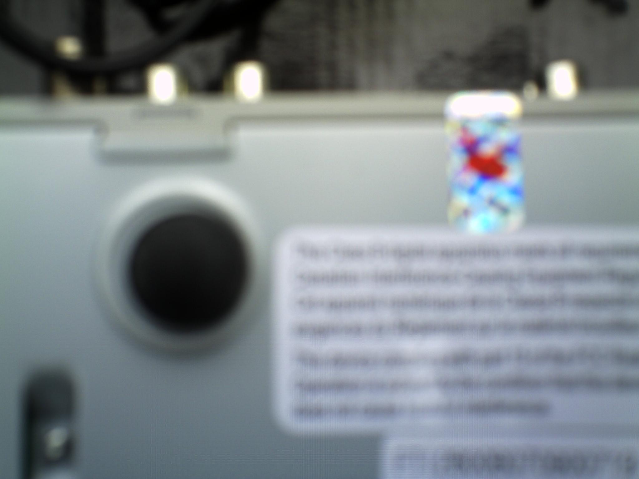

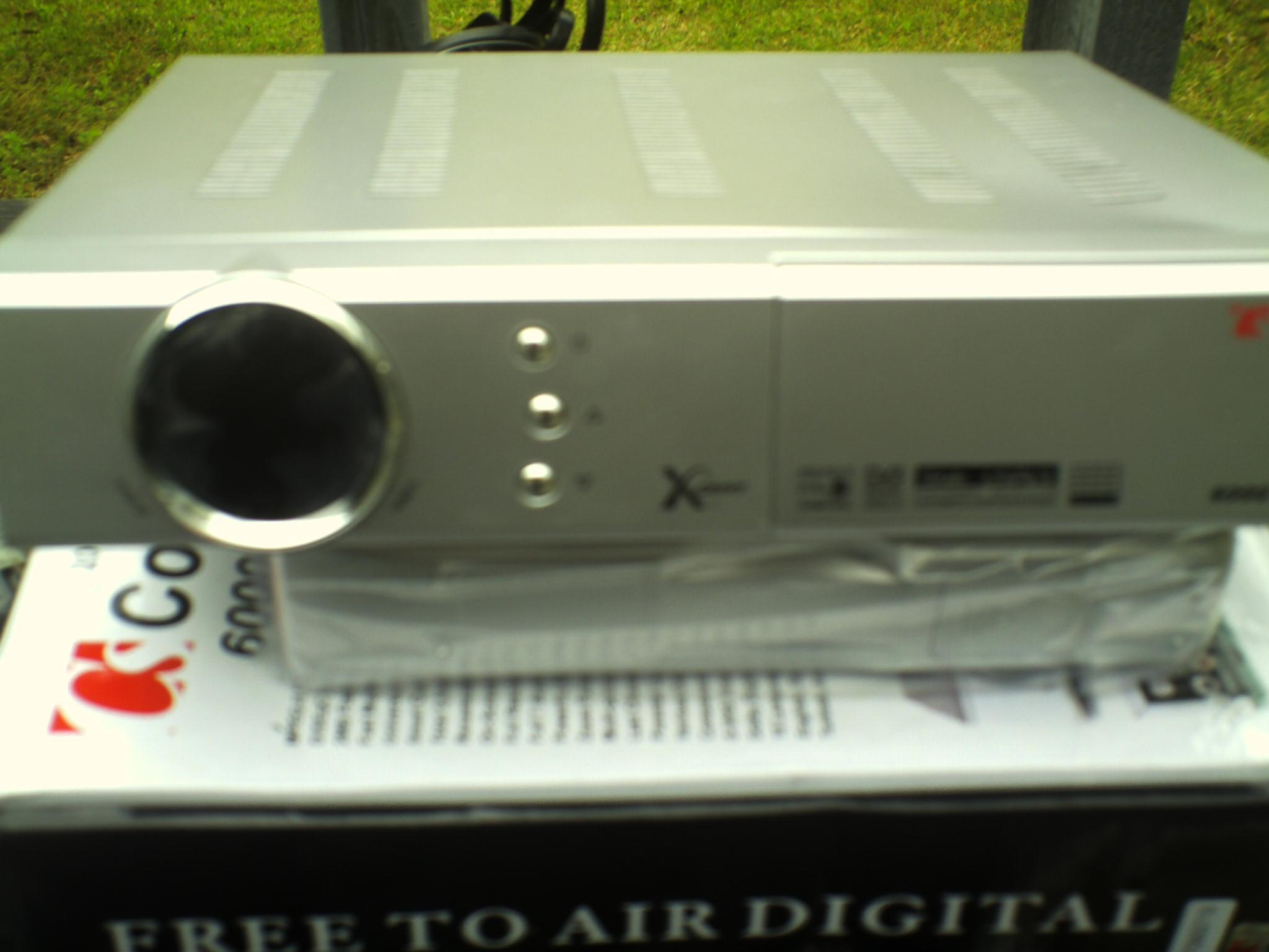

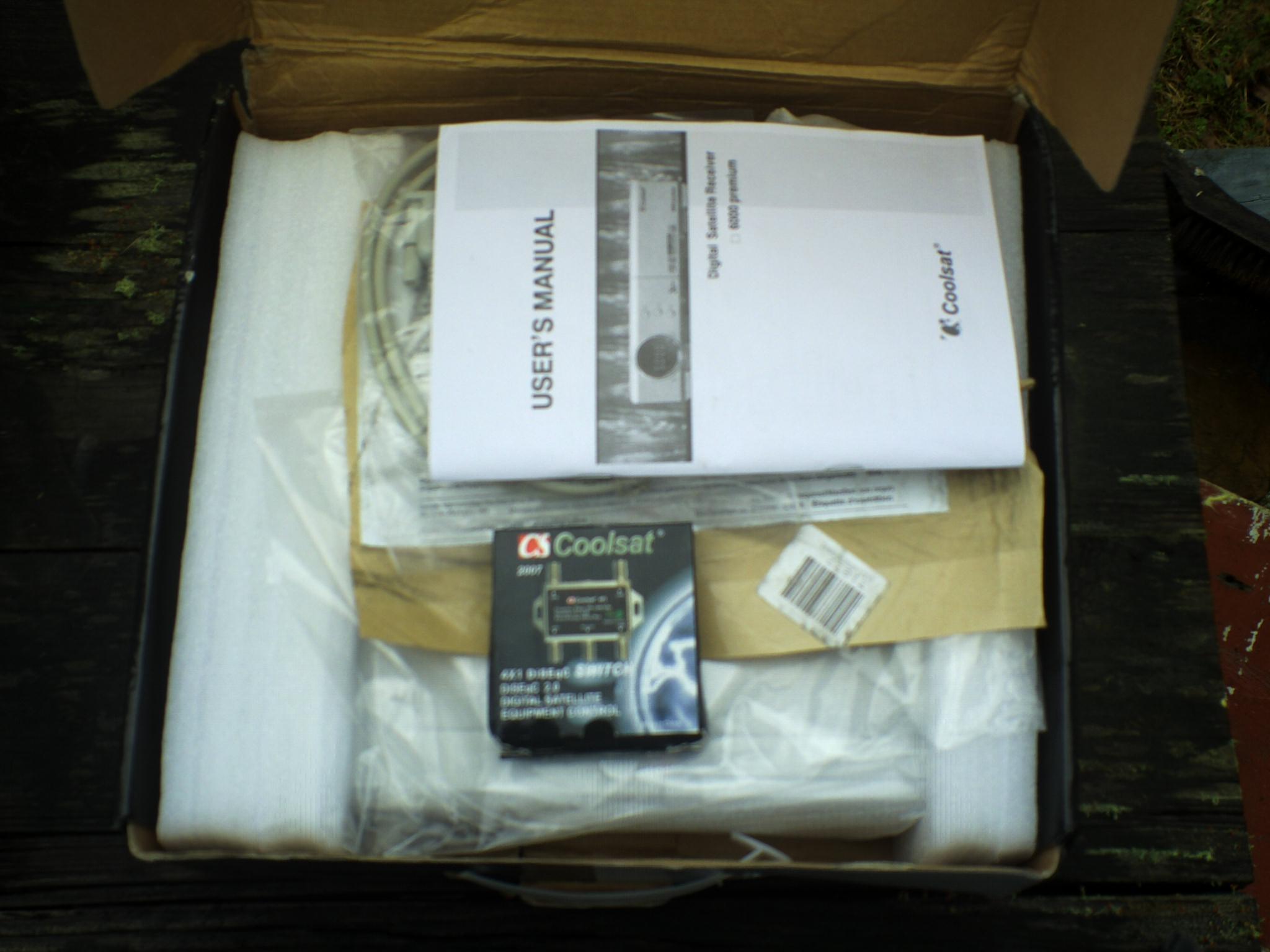

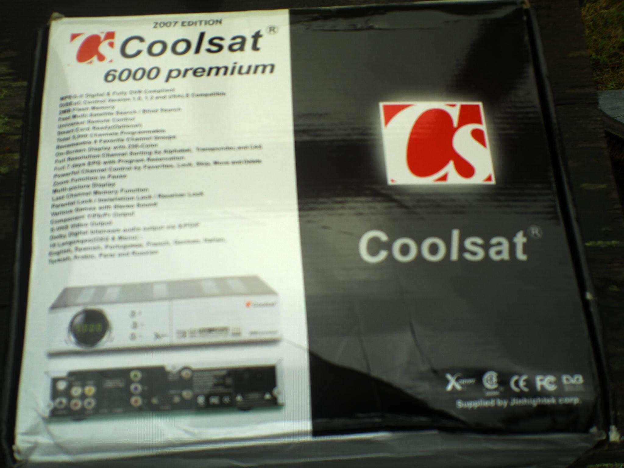

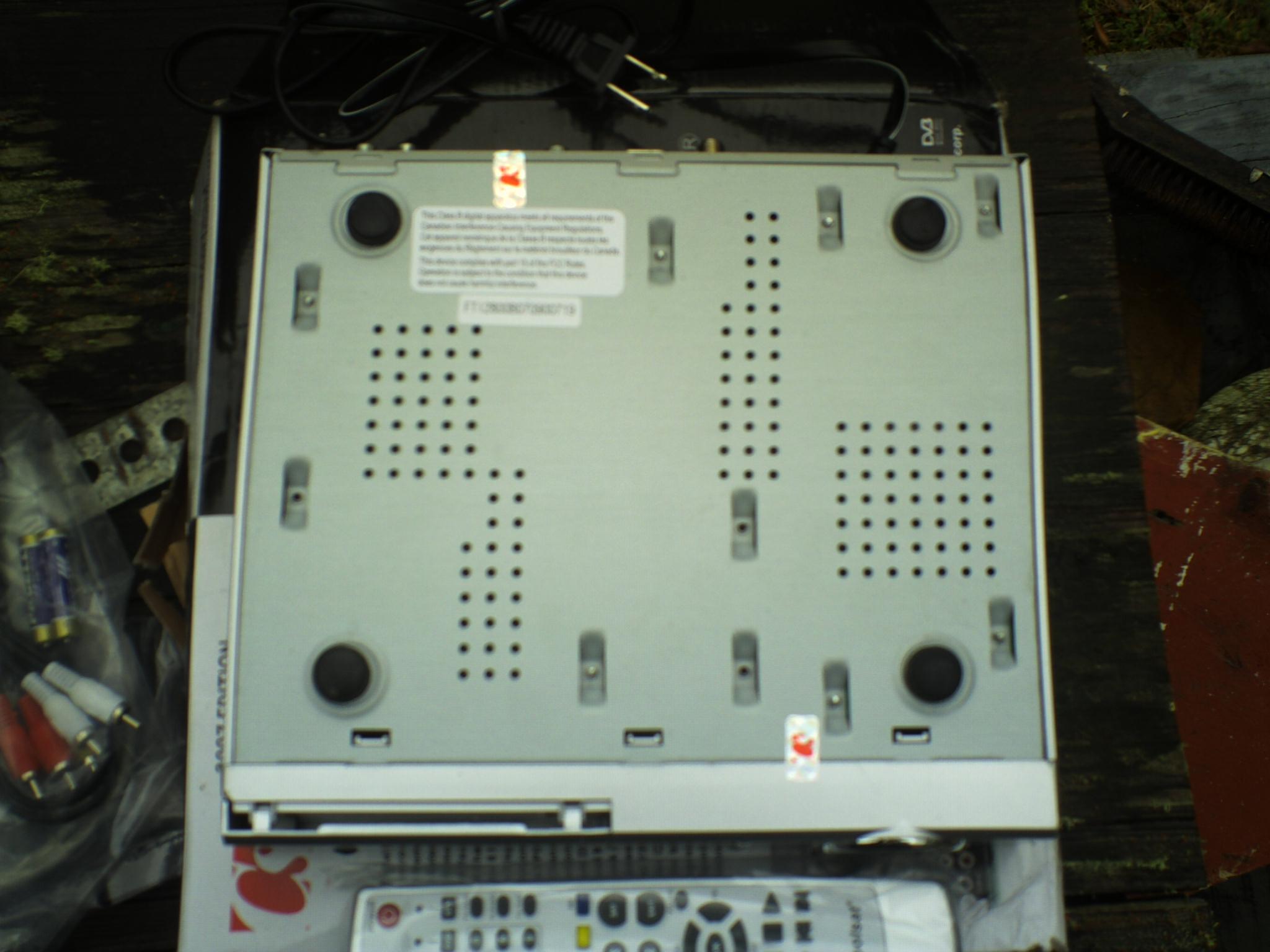

This is what I have ordered so far.

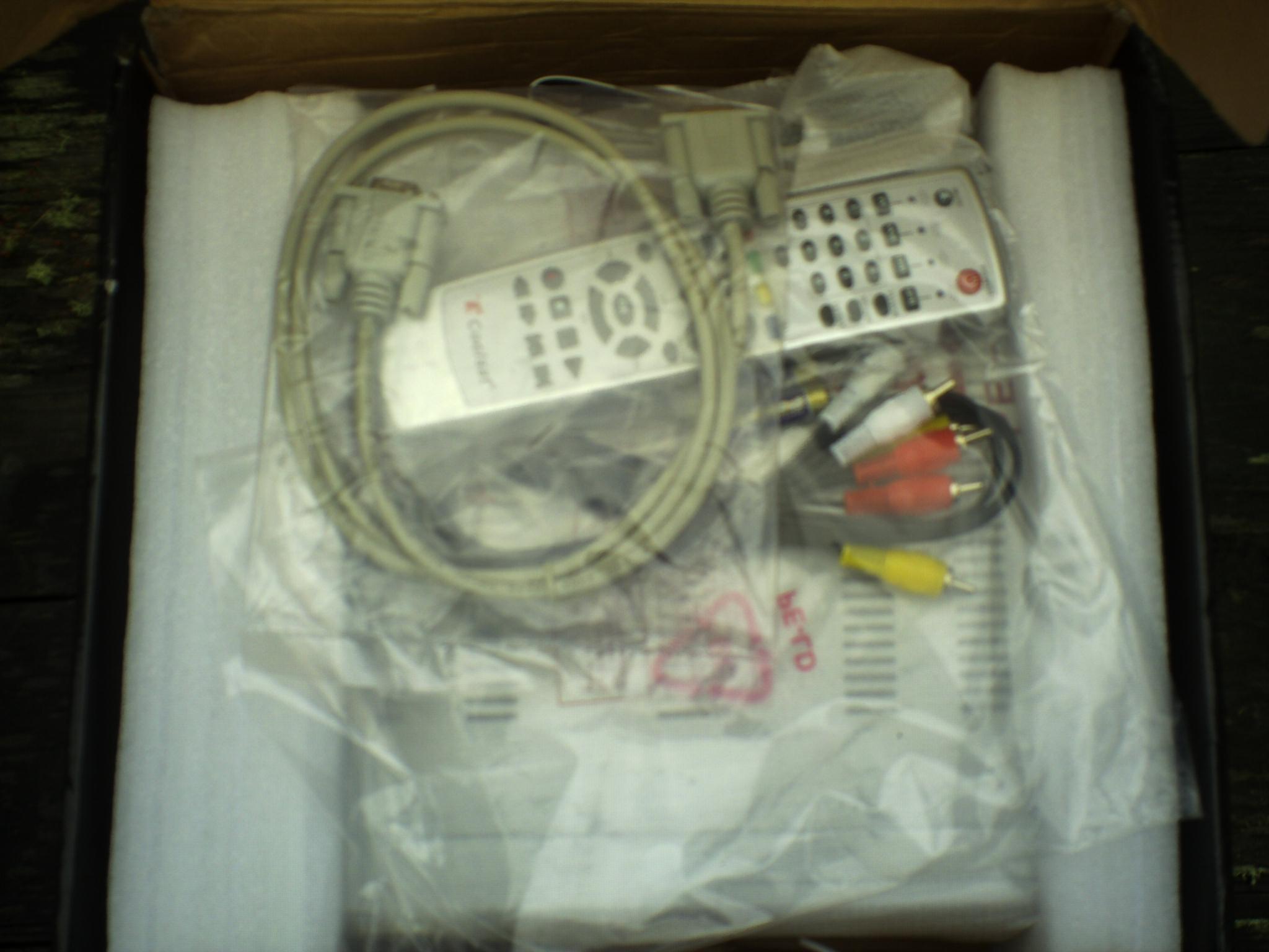

Coolsat 6000 Premium, I tried to win several auctions on fleabay for newer models,they always started under 10 dollars, but soon jumped to 80-150 dollars plus.
I just can not afford that at this time.
I got the coolsat for under 60 with shipping and it was new in the box not refurbished.
Suppose to be a reputable dealer but who knows.
I understand there are a lot of knockoffs being passed around- everywhere these days.
The box and the unit look legit.
It was the best deal I could find at the time.
Maybe it will get me started till I can afford something newer.
I also bought two BSC621-2 C band and KU band LNBFs.
One for each bud- to play around with?
I hope this was a good enough choice-they were really cheap, compared to all the newer ones I looked at.
I also ordered a DIGITAL SIGNAL METER LNB, and some switches- 4x1 DiSEqC and 2x1 Diseqc.

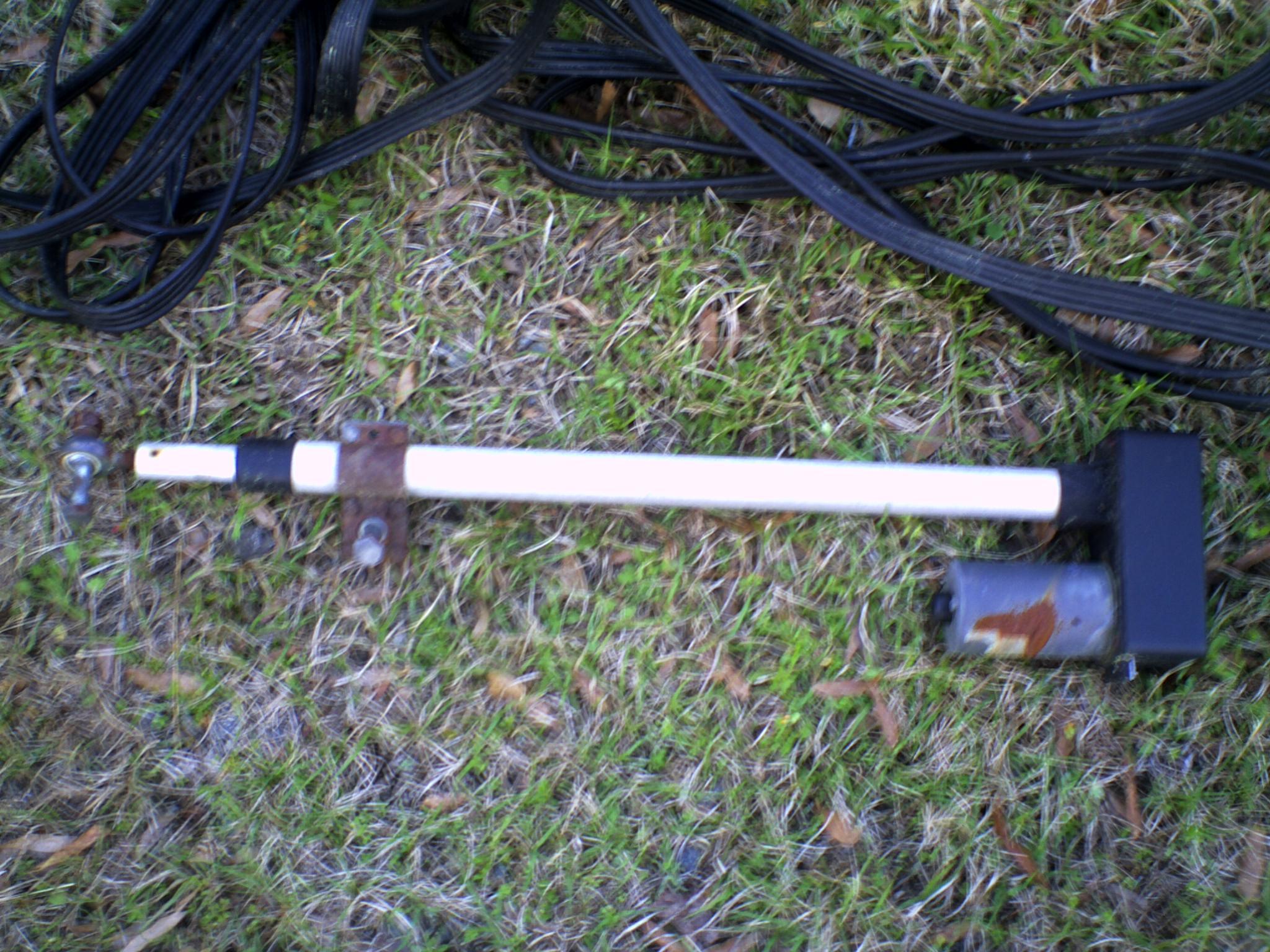

I have to get the motor cables next, any ideas on what to get and where to pick it up cheap?
Not sure if any of the cable on them is any good after all this time,some were cut?
I read something about sprinkler wire cable on here?
Is that any good? For the motor controls?
Suppose to be cheap?
Have any of you tried it?
How far can I run these cables,I read several different answers on a couple of post?
Anywhere from 100-150 feet?

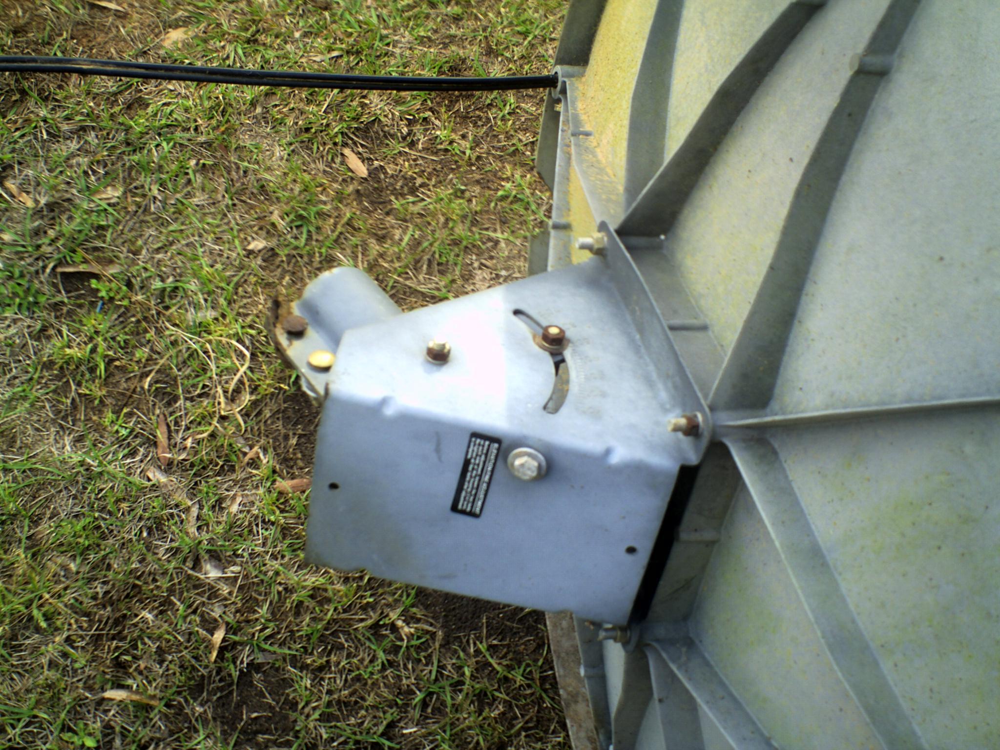

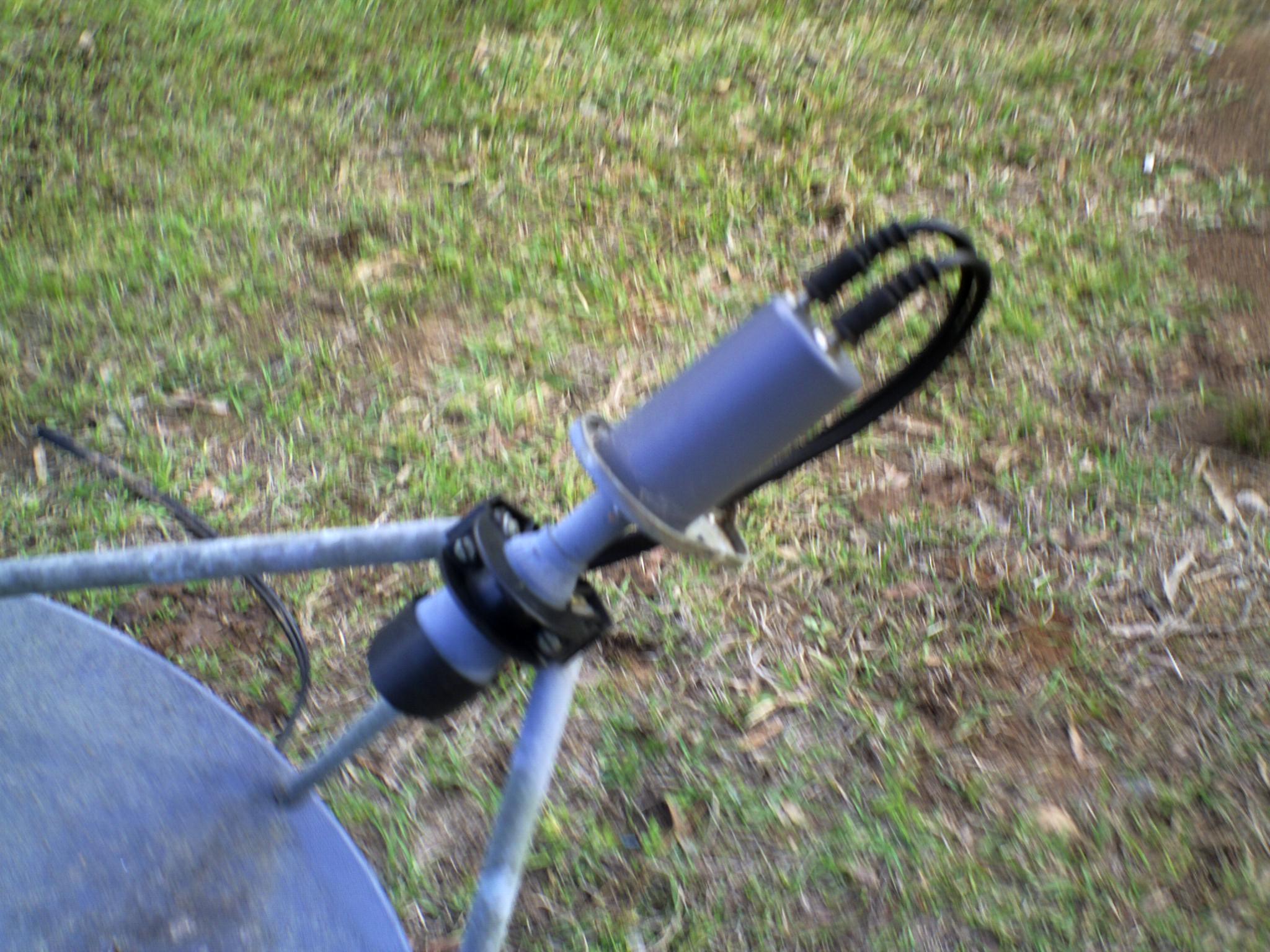

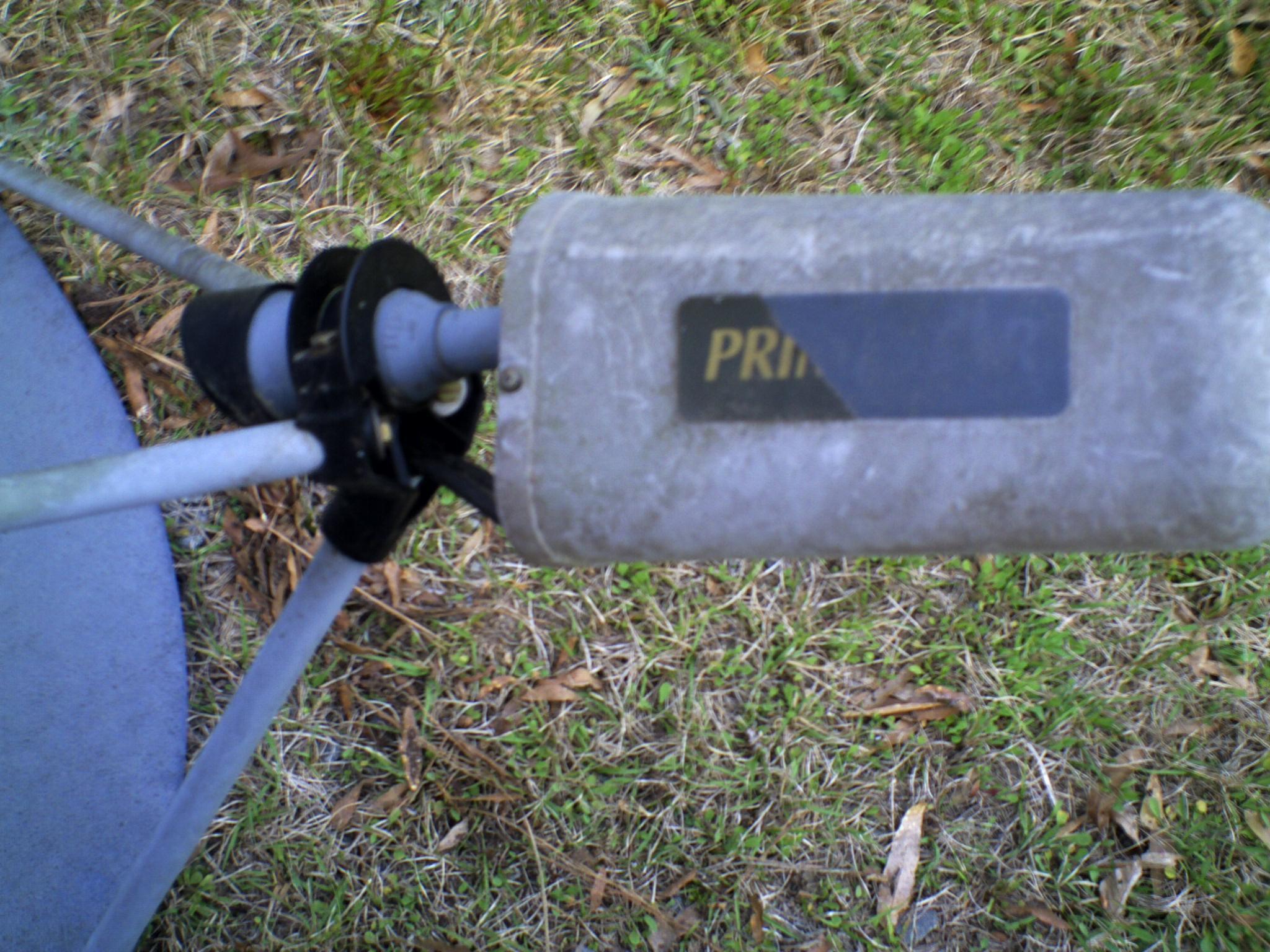

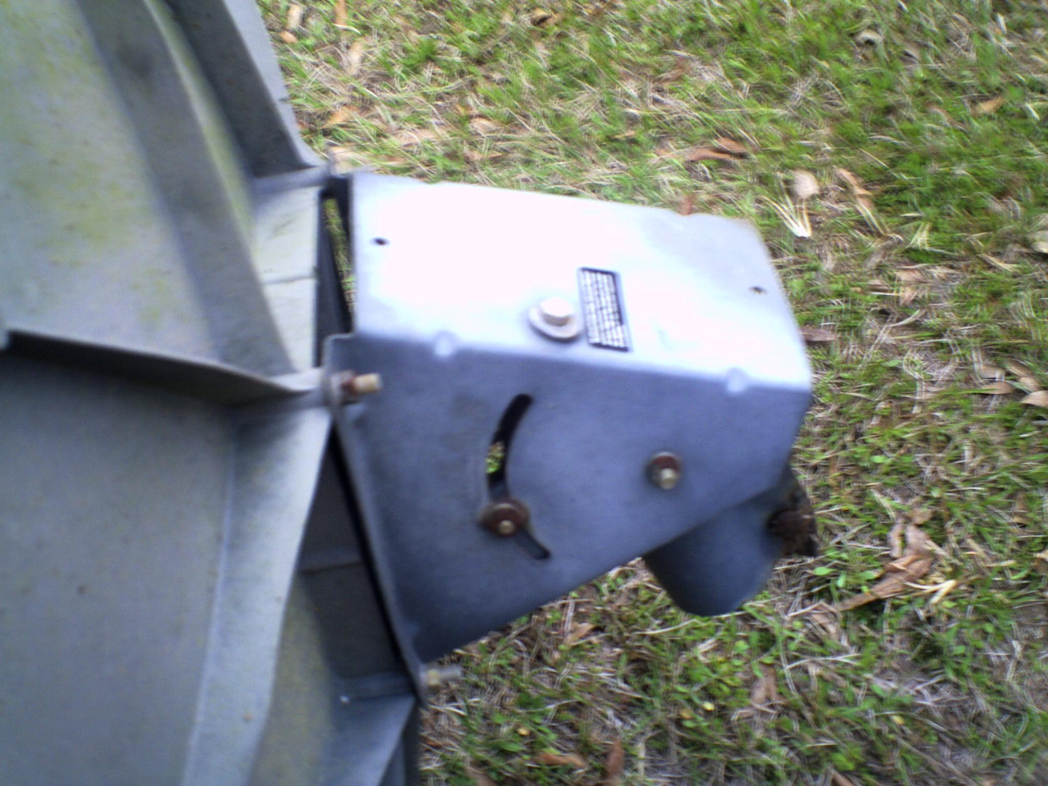

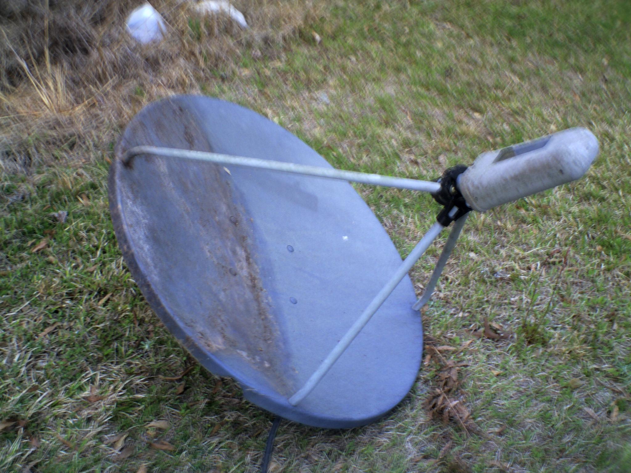

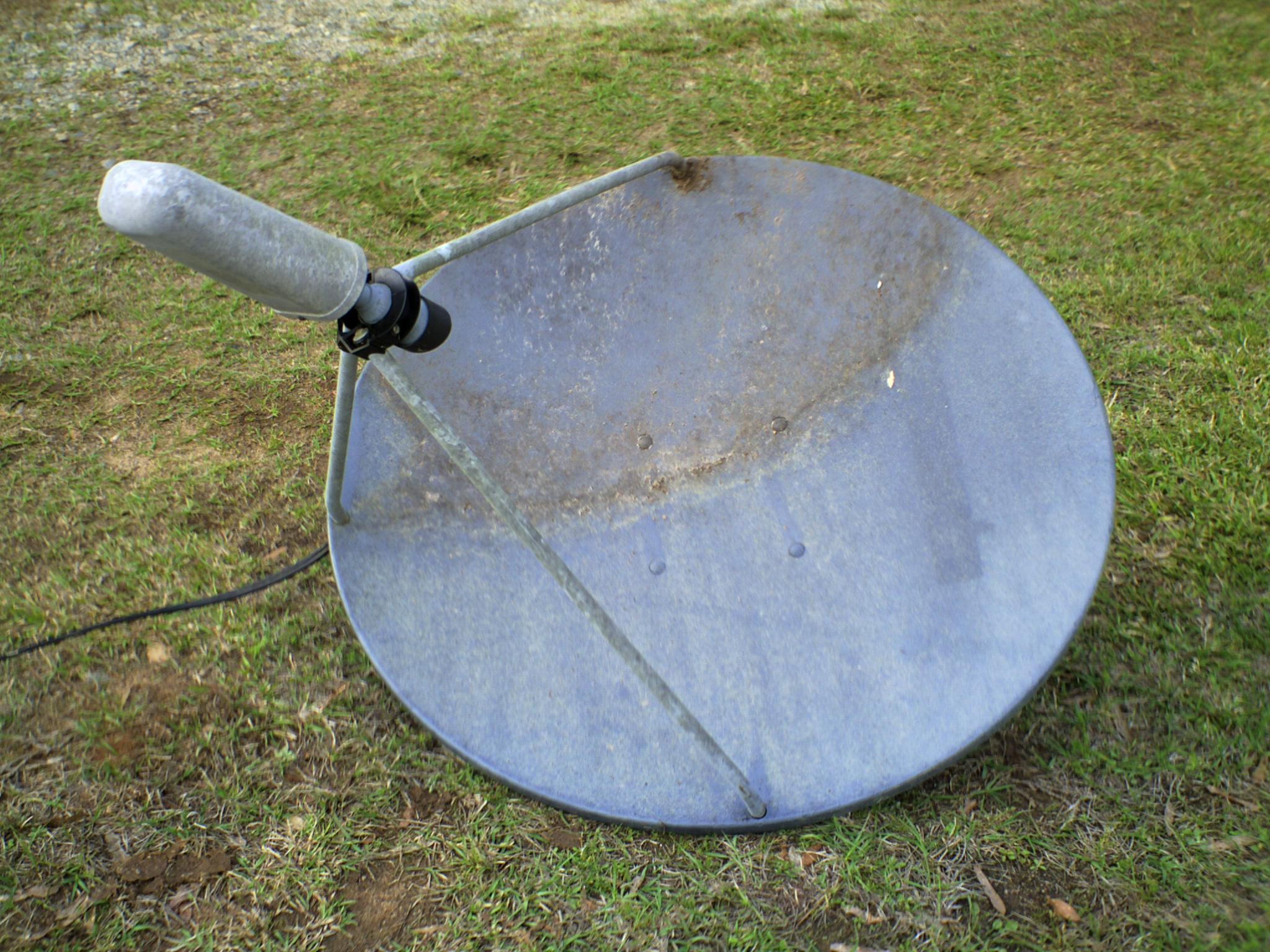

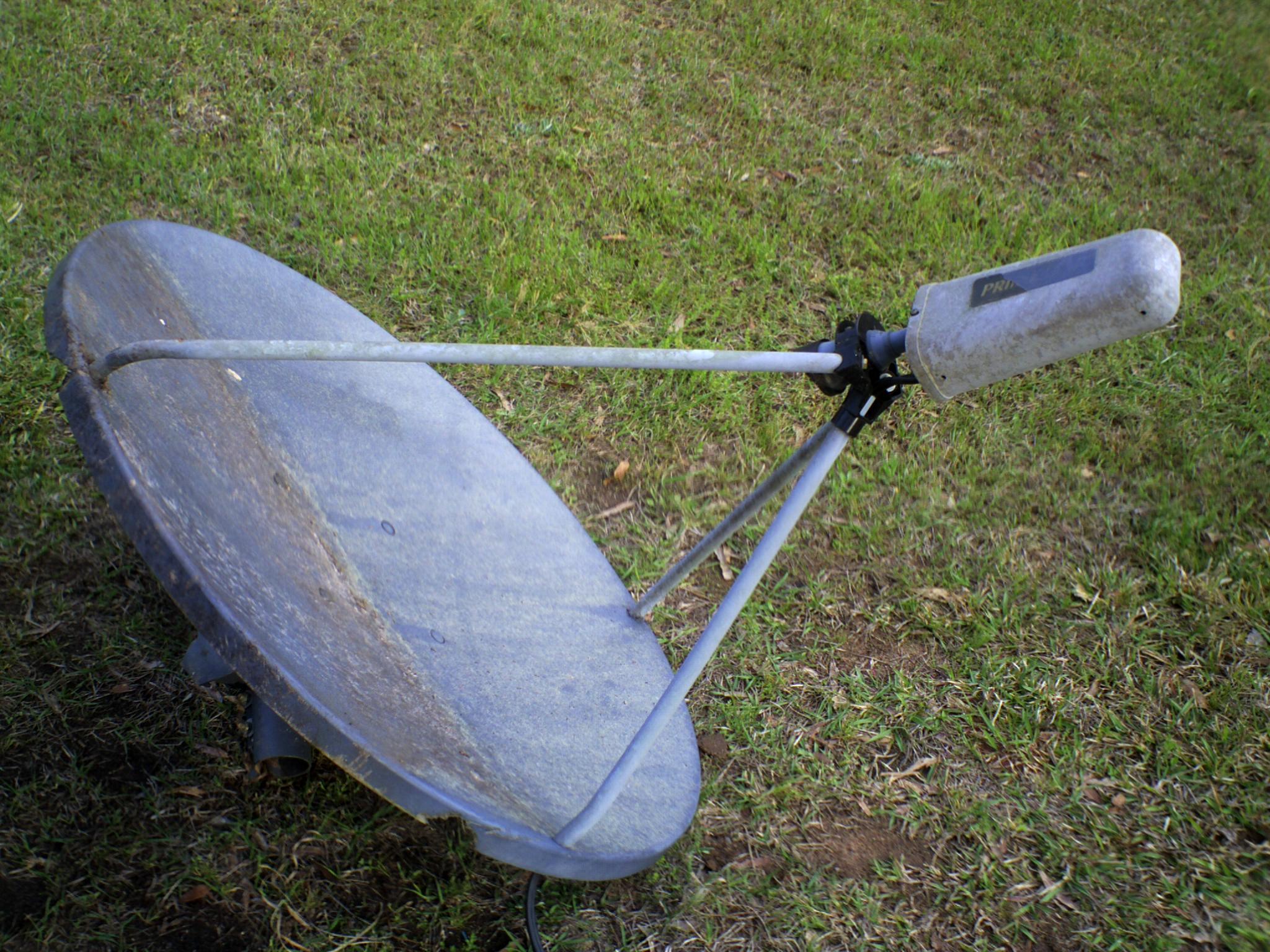

I also found an old primestar dish 39in by 36in fiberglass?
Someone just tossed it by the side of the road.
Picked it up many years ago.
It still has the bracket mounted in back of the dish.
It is solid type dish with -offset focus?

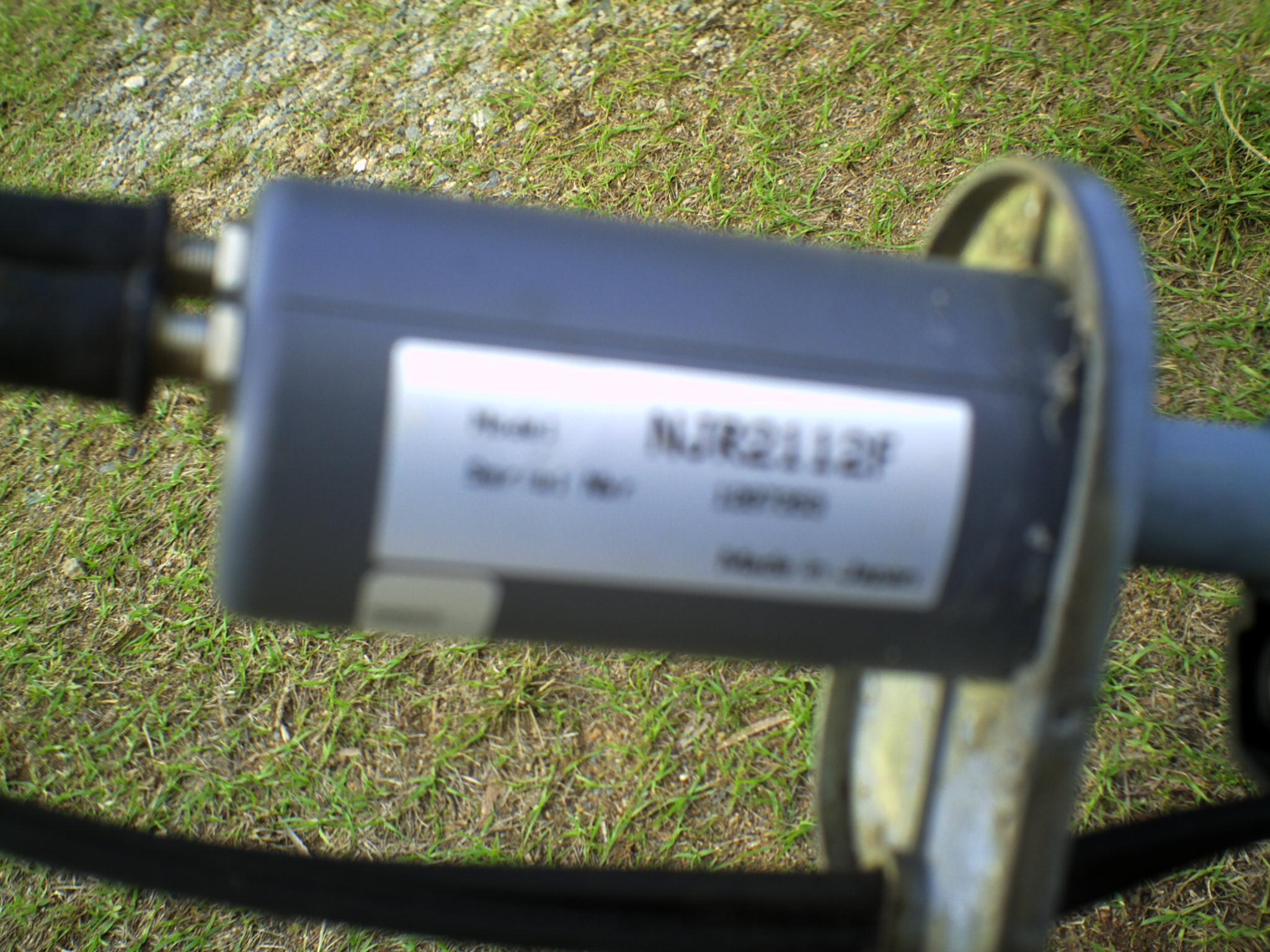

LBN:5082
Model No.NJR2112F
Dish is:Channel Master
Part No.3040681-01
Mold No:90M-1
Made in USA.
What can I do with this one?
I want to motor it up also and use it for C/Ku possibly?
Do I need to change the LNB type for legal FTA?
I do not know yet if this LNB is any good or not?

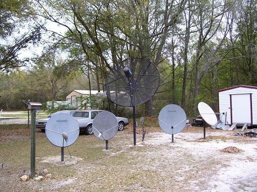

Welcome!
You have the makings of a fine dish farm!
Do a site survey, and place your posts where you have a clear view of the southern sky, place the dishes as close to each other as you can without them obstructing each others view as each one moves. It will make it easier to run cable and add more dishes later. 100' is no big deal, use good RG6 and connectors.
The Coolsat will be ok as a 1st reciever, many prefer the Fortec of Traxis for their excellent blind scanning (a must).
Glad you are reading everything you can, as that will really get you off to a god start.
Thanks I have heard great things about the Fortec units.
I am hoping to find a great deal on a used older model.
I have been trying to get my hands on one for several weeks now. Just a matter of time and money of course.

The motor control cables I will have to replace as some have been damaged over time. They were damaged when someone dug them up and some sun has deteriorated the material over time.They are all original probably the early 90's.
I have heard that the old bud cables are expensive.
So I am looking for a good cheap alternative.
Man that is something else all those dish units.
I guess dish farm is the right description.
I count ten in the picture.
Can one receiver control signal from all those,are do you have to have multiple units?

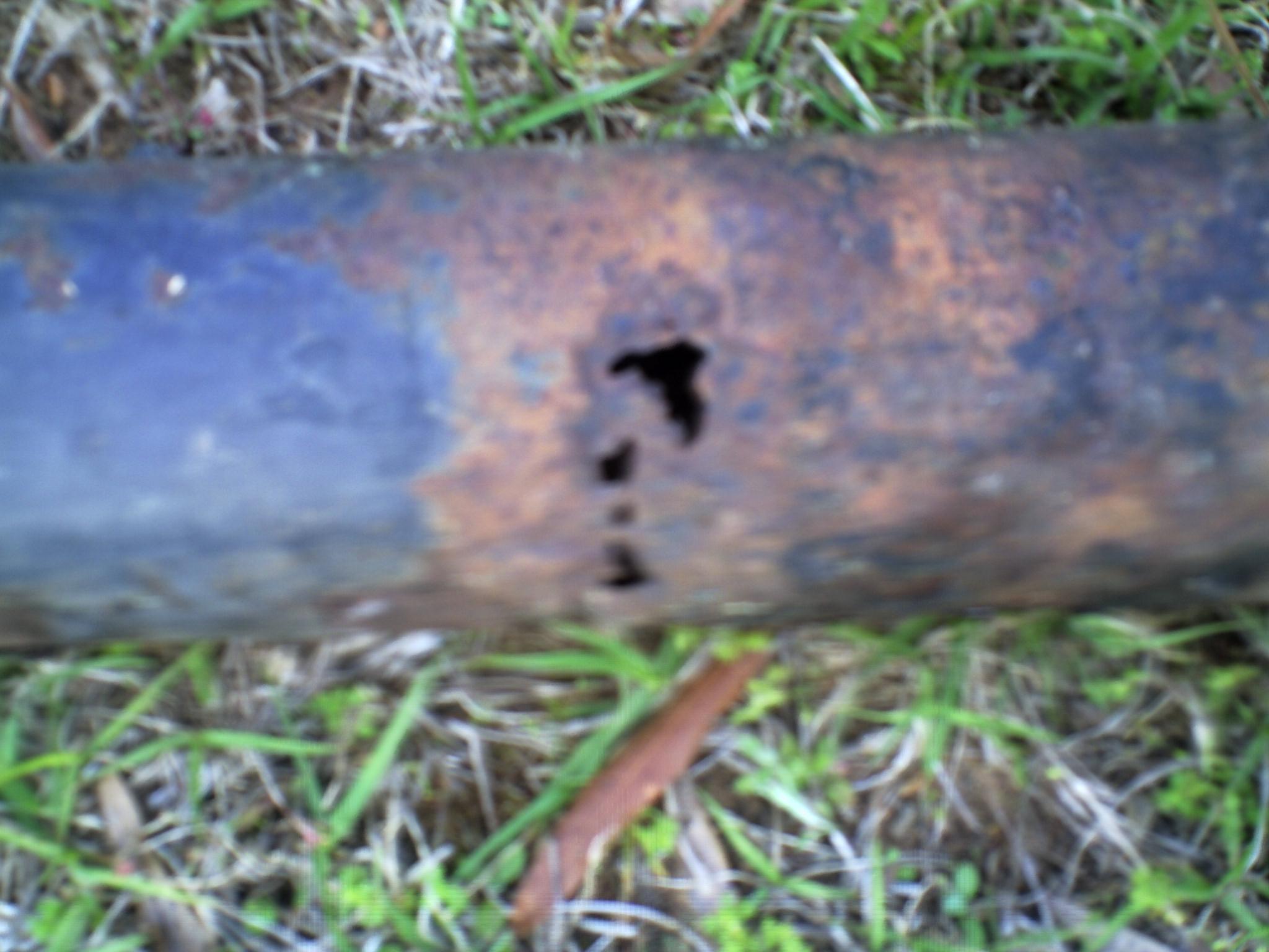

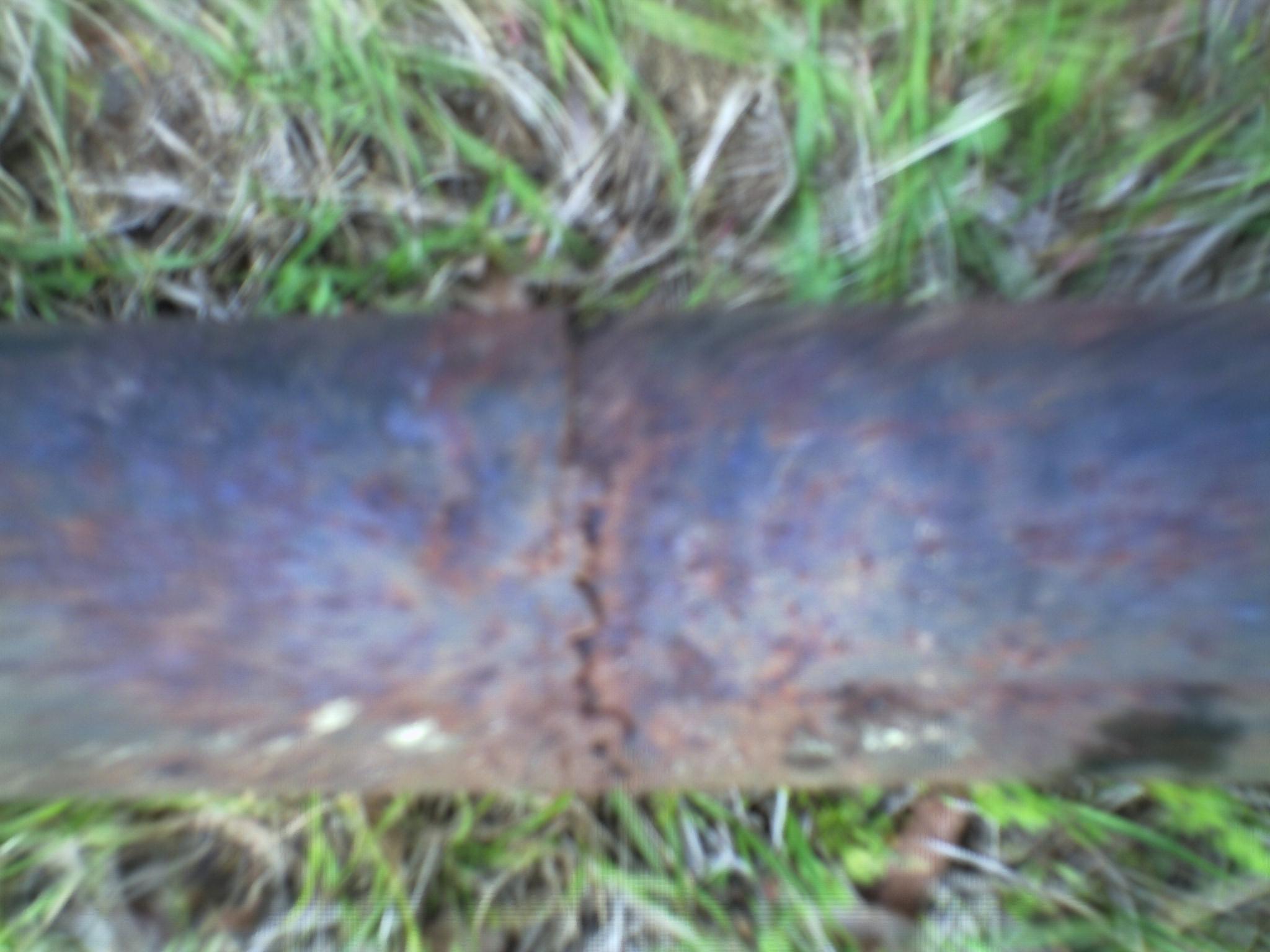

The shorter pole has some severe rust issues I am thinking I can weld a support to the pole to take care of this. The longer pole seems to be two parts and a little curved after the weld?
The part that goes in the ground.
I think I will weld a support to this one also. I have some thick channel iron about 2x3inches.
I think that will do a fine job.
Here are some pictures of the old prime star type dish I found by the side of the road.
Not sure what to do with it yet. I will try and hook it up to the coolsat 6000 as soon as I can and try and find out if the LNB is still working or not. I would like to replace it either way with a newer better one.
It is pouring rain right now and looks like it will last all weekend. Rats.

Here is the receiver I purchased to use with this system.:confused:
I am still trying to get a better unit like the Fortec units, and will get one as soon as I can afford one. This was a good buy for me for the features and the price I guess.
It will get me started at least. It seems to be legit and not a clone, but I have no idea really.
It has the hologram stamps I read about if that means anything.
For the price if it does fail on me and die,I will have to attempt to repair it myself.
It would not be worth the cost to return unit and pay shipping both ways.
It was cheap and I tried to buy one several times over a couple of weeks before I got it.
When it arrived the wrapping was torn in several places and the box was a little crushed also. You can see a dent in the top right side.:eek:
Really worried me at first, but it powered up and seemed ok,best I can tell.:up
I notified the seller and was told I could send it back of course for replacement if I paid the shipping and handling fees etc, but I felt like that was too expensive.
I am still looking for a cheap unit to use for a backup if this one dies and I can not repair it myself. I have never worked on receivers but I am pretty good with pc's.
Of course they are not alike in a lot of ways. PC's are probably easier to repair.
Parts for them are easier to find and usually pretty simple to replace.
Thanks again to everyone who is helping me.
It really is very much appreciated by me, and I hope I can return the favor one day to someone else as new and dumb as I am.

Still have to repair poles and paint them.
The dishes are going to need a little work too.
There are a couple of small tears I need to fix in the mesh. And one is a little dented from a storm before I got it.I think I can straighten it out though.

One thing I can think of, is the Primestar lnb is going to need a multi-switch to work with the Coolsat. Another is, in case you are not aware of it, the Coolsat won't drive an actuator. You will need the analog receivers to do that. Or you can get a Gbox/Vbox, which are devices that will convert diseqc 1.2 commands into signals to run an actuator. But, since you are money strapped, you should use the analog receivers for now.
You could use a different lnb on the Primestar, but the lnb on it is a good one, so why not use it, and it will need a multi-switch. I have some extra multi-switches, and will let you have one, or maybe more, it depends on the direction you head in? There are so many ways you can go in, I hate to give advice on what to get, but I will comment on what I don't like, or what I don't think you would like.
I think a good suggestion for now, would be to set-up the Primestar dish, so you can get used to the Coolsat, and you can take you time on the C-Band dishes, while still enjoying the FTA programming.
For a quick start I would go to the building supply and get a corner post for chain link fencing> and about 3 bags of quickrete. Put the pole in the ground and let the concrete dry overnight, be sure the pole is as perfectly plumb (check with level all around the pipe) as you can get it. Stick the primestar on there once you get your multiswitch (3x4 multiswitch works). Primestar mount will fit right on that type pipe and you'll have a good fixed-dish beginning! Motorizing a primestar can be done sev diff ways, once you get to that point.
Be sure you put the pole where you can see the southern sky-southeast to southwest. The more sky you can see to the south, the more satellites you'll be able to view..
Coolsat came with a multi switch.
See Third pic.
I also ordered couple of different ones off flea bay.

You could use a different lnb on the Primestar, but the lnb on it is a good one.
Right I read that somewhere before and I asked about it in the post above.
I do not know if the LNB is good or bad yet.
I have not checked it out.
But if bad I will replace it.

These are great dishes....warning: You won't stop at one...!
I see from your picture you know what you are talking about.:eek:
I have to agree,I have been looking everywhere I go for satellite stuff like you would not believe.
But it is a lot of fun and I will have lots of room for dishes if I break out the chainsaw and get rid of a few trees.
I been hankering to build me a log barn - now might be a good time to start cutting those logs and freeing up some room for a dish farm.:eureka

I'll bet that your old P* LNB will work, those things are tough, don't think I have heard of many gong bad....I use mine to drive tent stakes. ;)
See Third pic.
what came with your receiver and what you ordered were diseqc switches, a multi-switch is not a diseqc switch, it works entirely different
you need a multi-switch for the Primestar lnb
I seriously doubt that it is bad, these lnb's were well built, and last

putting a motor on the Primestar is no easy task, but it is do-able. the problem is the weight of the Primestar, and most motors don't handle that much weight, or are not recommended for that much weight. so, you have to modify the Primestar by cutting away parts that you think might be needed (or not needed?) to get a decent weight. It's easier said than done, but it is do-able.
