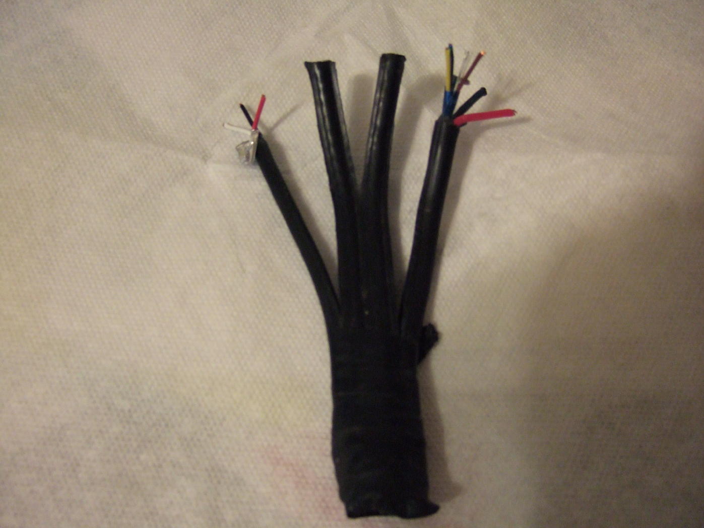

when i found a deal on ebay , i searched & found the cable listed as tvro or 8136 both apply to the ribbon cable. also a web site that has some listed ribbon cable
also you can make your own a cat 5 type cable would work for the corotor ( and sensor) and rat shack should have some 18 awg pair cheap then add coax....
usually a ribbon cable includes 2 coax , one cable of three wrapped 20 awg wires and one cable with 2 wrapped 18 awg wires and three wrapped 22 awg wires and one unwrapped 22 awg wire.
