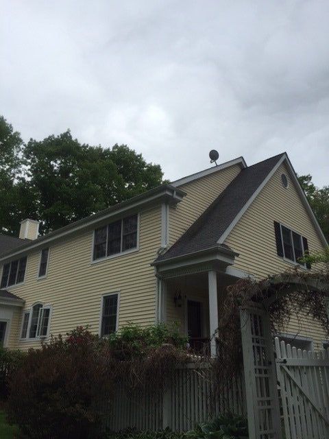

The installer is coming out on Friday. I had a buddy with a meter take a look today and I only have 2 spots on my property where I can get a line of sight:
1) On the roof, near the location of a 15 year old dish left by the former owner that is not in use. Photo of this is attached. It is my understanding that an installer won't go up there. Is this correct or might they re-use the existing mount with the new dish???

I can't be 100% certain, but the dish in the picture looks like the older type dish, not the Slimline, which is necessary to receive hd signals. The mast for the older dish is too small for the Slimline dish. There is also the issue of accessibility. Many installers aren't allowed to get off the ladder to install a dish, which seems to be the case with your existing dish. It looks like they may be able to install the dish on the smaller roof to the right, assuming they have a long enough ladder.
How many installers will have a free standing ladder 10'+ tall? They'll want to avoid overhead work, so a shorter one and a stretch ain't gonna do it.

I was referring to using the ladder to install a dish on the smaller roof to the right of where the existing dish is.
Hard to say for certain, but it looks like it will. It seems only a matter of having a long enough ladder.
