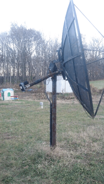

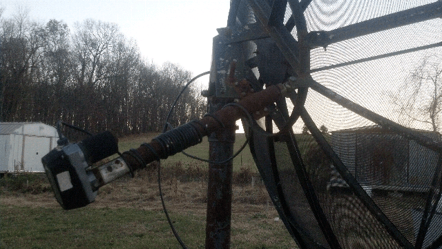

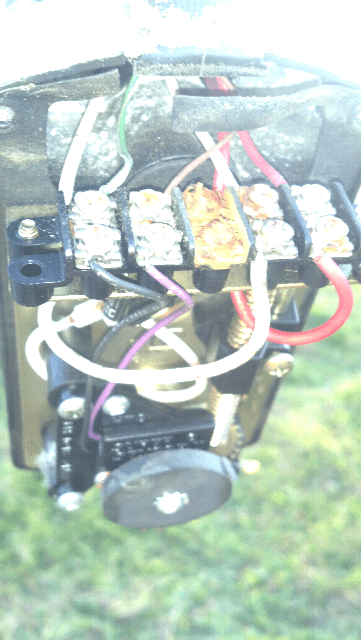

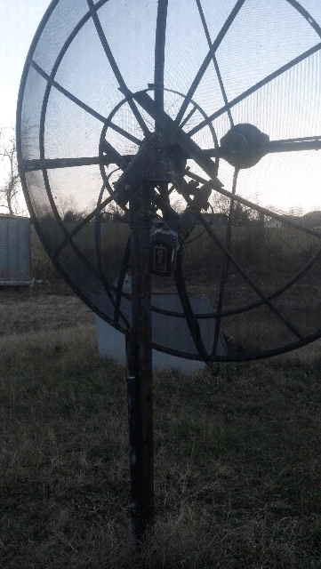

Here are some pics I took figure out how to hook up receiver. Been trying to figure out how to load pics on site. Found the android app! Will take more in next few days. Its dark when I get home from work.

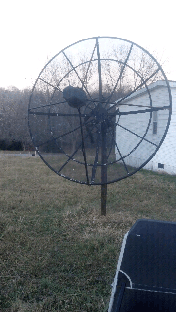

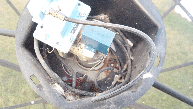

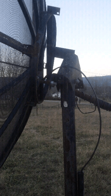

More pics.

Yep, looks like a BUD!
And a fine one.
I particularly like that hex LNB cover.
Was it a waste basket , a flower pot , etc.?
Some of us have used buckets. ;)
No I think its original. Has 3 clips that go thru holes, then turns to lock on. Surprisingly, and luckily, they didn't break when I took it off.
This bud looks exactly like my 7 1/2 foot k tronic bud I started this hobby with
So one more question for now guys. If I get the c/ku lnbf as johann mentioned. Will the current three low voltage wires work or will it require new wiring?
Before getting a C/KU LNBF you have to check the size of the holes on the screen.
On my dish the holes are about or little less than 2 toothpicks, any screen with holes bigger than a pencil will not work and will not able to pick up KU signals.
The new LNBF will change polarity with a 13 volt or a 18 volt signal that is send via coax cable, but your receiver need to be able to do so.
The newer receivers can do this and there is no extra wiring required and those 3 old low voltage wires are not used.
I do not know if your old analog receiver can switch polarities with 13v and 18v, but someone here may be able to answer this.
But, as far as I know you still would be able to use your old receiver for moving the dish wile using a newer receiver. Can anyone confirm this?

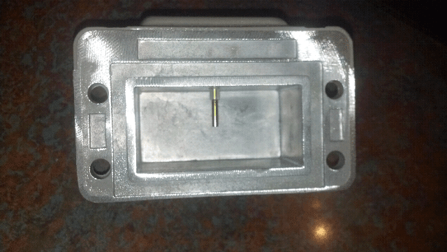

New c band lnb came yesterday, (USPS). Still waiting on receiver, (FedEx). There are 4 bolts on old lnb. So all I need to do is take the old one off and bolt new on, then connect to receiver, correct? Theres nothing connected inside that I need to be careful w/? And another thing I still haven't figured out. If I connect coax to new receiver, how am I going to see the menu on old receiver to change polarity and move? Can I connect old receiver to a different tv to see menu?
The LNBF you just got came with a scalar .
Instead of removing your old scalar, I'd see if I could slip my new LNBF into the old one.
You will also need to rotate the new LNBF within the scalar for proper alignment.
Likewise, how far the LNBF sticks through the scalar is a necessary adjustment.

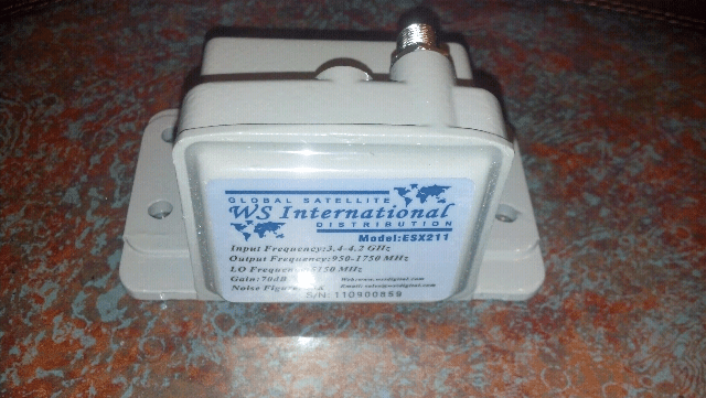

What do u mean by scalar? This is all that was in the box, and a rubber looking gasket.

This actually isn't the lnb I ordered. But its the same price as other. Haven't had a chance to call the company and let them know. But was planning on prob jus keeping it, if it worked. Had about the same specs. Sooo, is it gonna work?
picture worth 1,000 words
I see you got an actual C-band LNB .
That does bolt right onto your existing feed horn (round tube about 3" dia & 8" long).
The scalar I mentioned is the dinner plate with raised rings on the dish-side.
The feedhorn is held in the scalar by a couple of screws (which you probably should leave as is for now).
I was under the impression you'd ordered an LNBF, which has LNBs built into a feedhorn.
Your picture cleared that uP.
