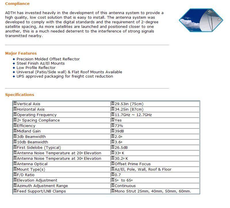

I wonder if messing with my dish would help or hurt. I squeezed every little bit out of it a couple months ago.
My dish is suppose to be 2 degree compliant the literature on it is attached. I wonder sometimes though.

If I could redesign my ADTH antenna I would rotate the reflector 90 degrees. By being taller vs wider that would work better at 2 degree spacing. That's how my Primestar 90 cm is designed. I originally put that up for HITS on G-16 for my 4DTV. It worked extremity well on 99 with 97 next door. When that moved to C band that dish became an orphan. I didn't know what I would point it at. (its currently on AMC-4 for, well you know...starts with a H ends with a N) It would be a great candidate for G-18 but I made a bad judgment when I planted the pole in the concrete. I was really only interested in 99 w and should have put the pole further south. Then it would have had a better sweep of the western arc. Currently my house blocks 70% of G-18. I could add an extension to the pole but don't really want to get involved with that this year, maybe down the road.
