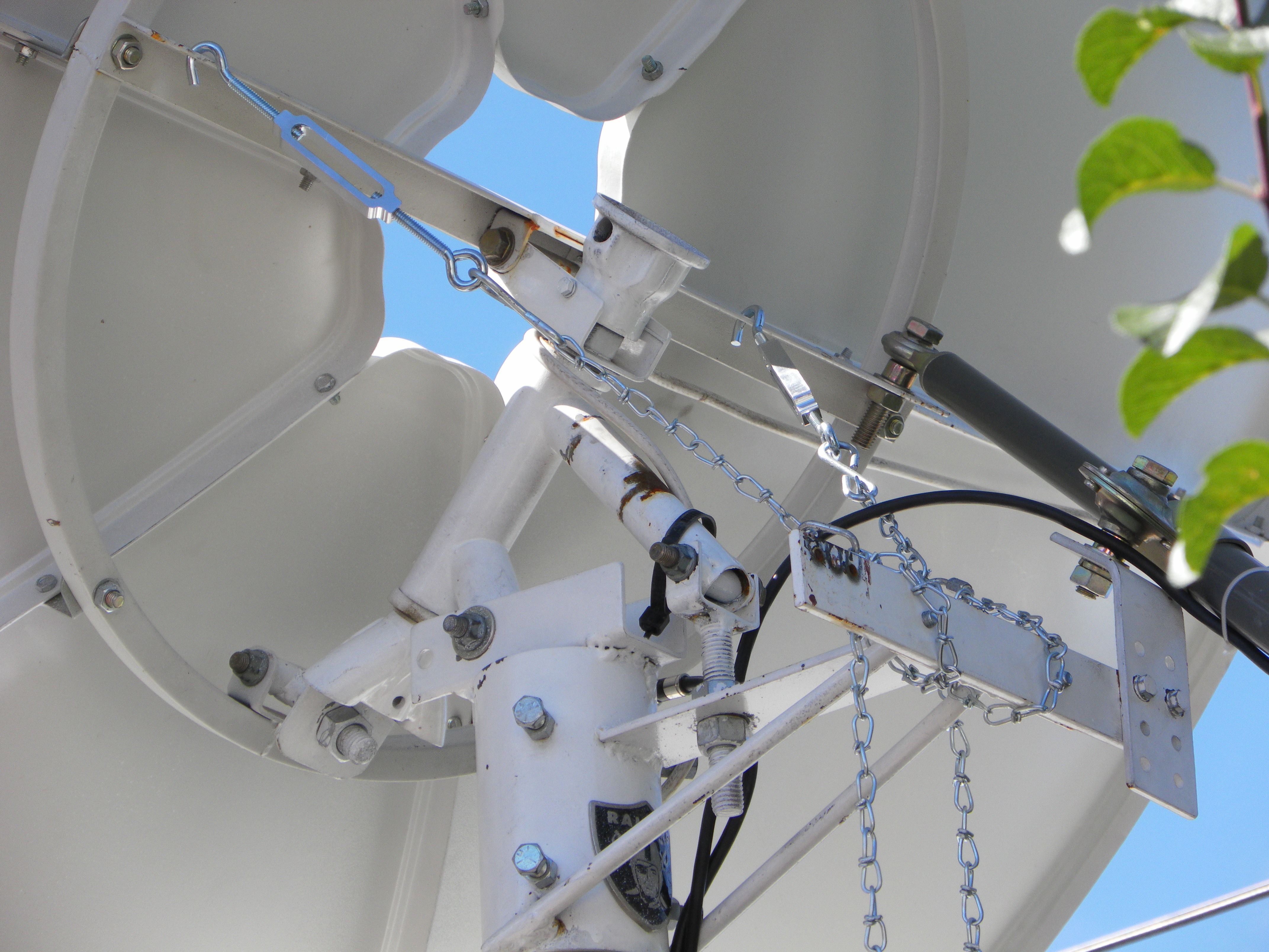

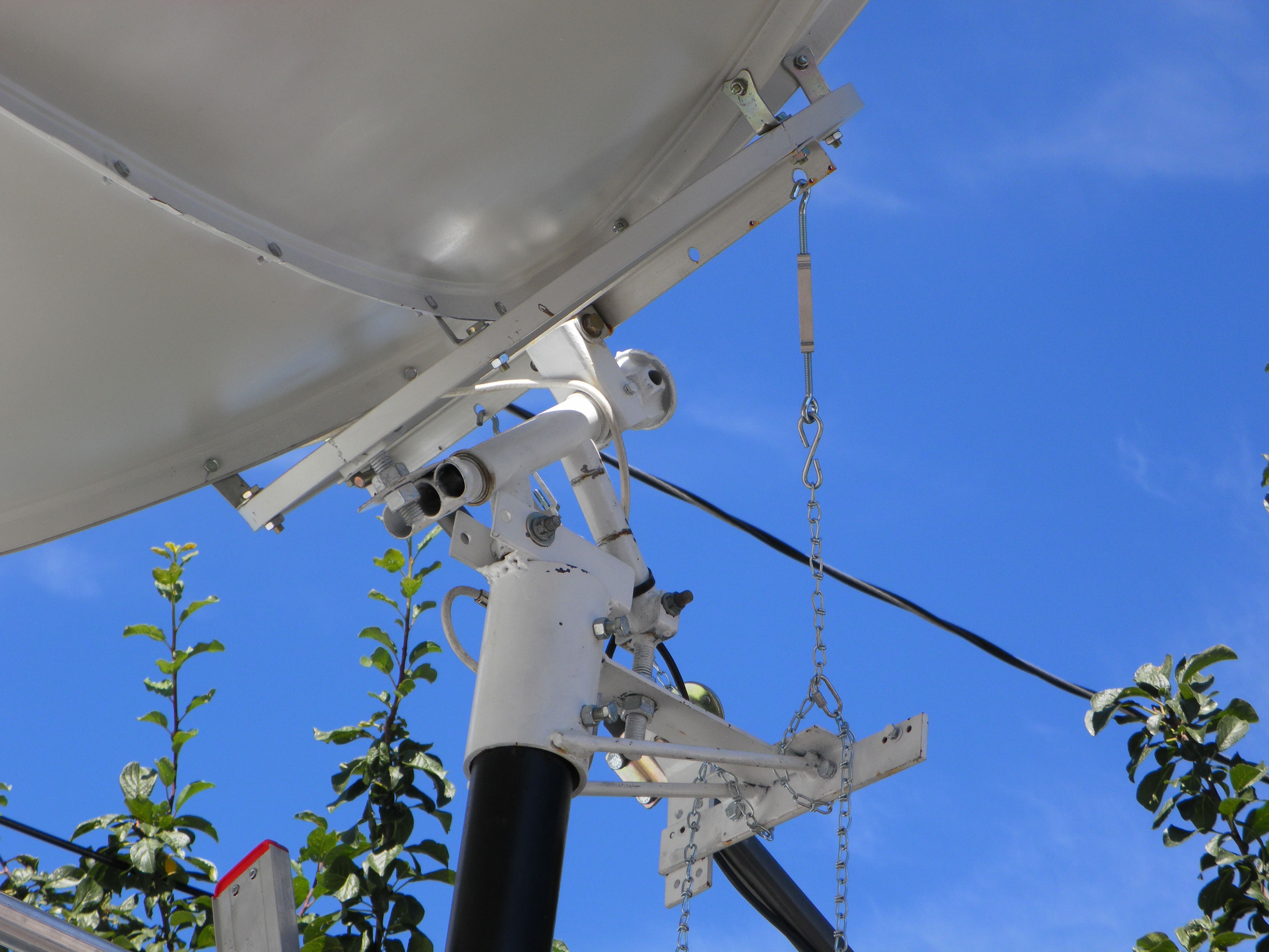

I chain down the dish to the mount with turn-buckles to take the stress off the dish mover during wind storms.

Removing the actuator from the dish side. Letting the dish down all the way in the direction that will hopefully minimize the wind catching it "face on", and then fastening the ring or what the dish attaches to, securely to the pole. May also have to "spin" the mount on the pole to accomplish this. I would not attach anything to the lip of the dish, I think you'd be asking for trouble, a warped dish. I think this is about all one could do. Short of taking it down and storing it away somewhere. Hopefully it misses you.

A couple of pictures shows application of the idea. This is a home-made mount, so it won't look familiar

If another hurricane appears to be a risk, I think I would try to take the dish off the mount altogether, leaving all of the adjustments in place. I would roll that thing into my garage.
Of course you have the advantage in Florida of impending hurricanes being all over the news. Even if Irene misses, I am expecting a crazy season, and you will have to be ready. I don't care what way you aim that dish, if the winds get to 120, it will rip the thing off the pole and embed it in someone's house, or car, or skull, God forbid.
If your flying dish ended up hurting someone, you will think yourself foolish not to have planned to pull it down for the duration of the hurricane.
