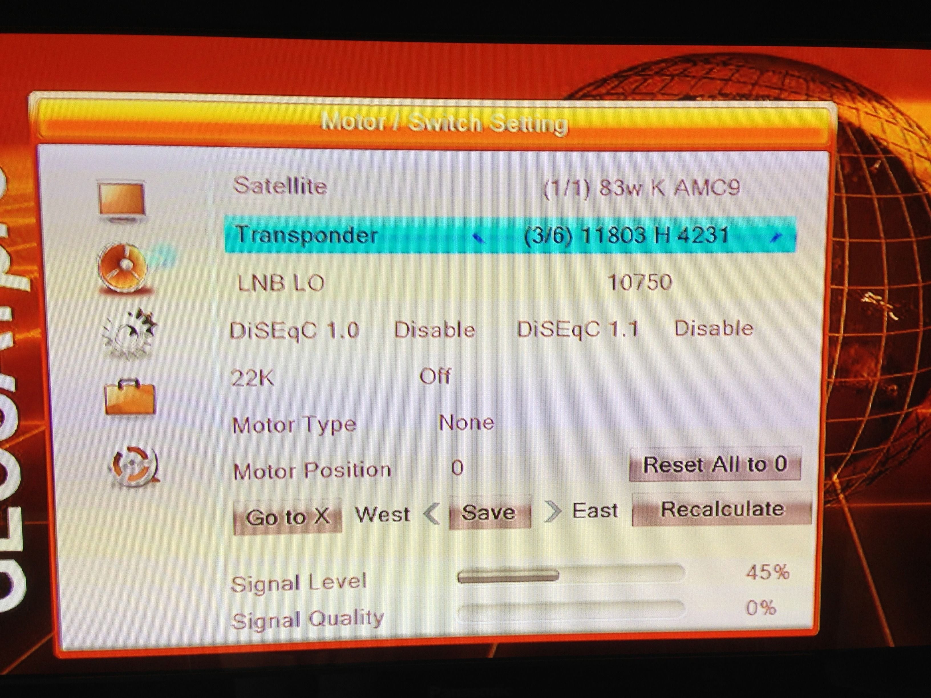

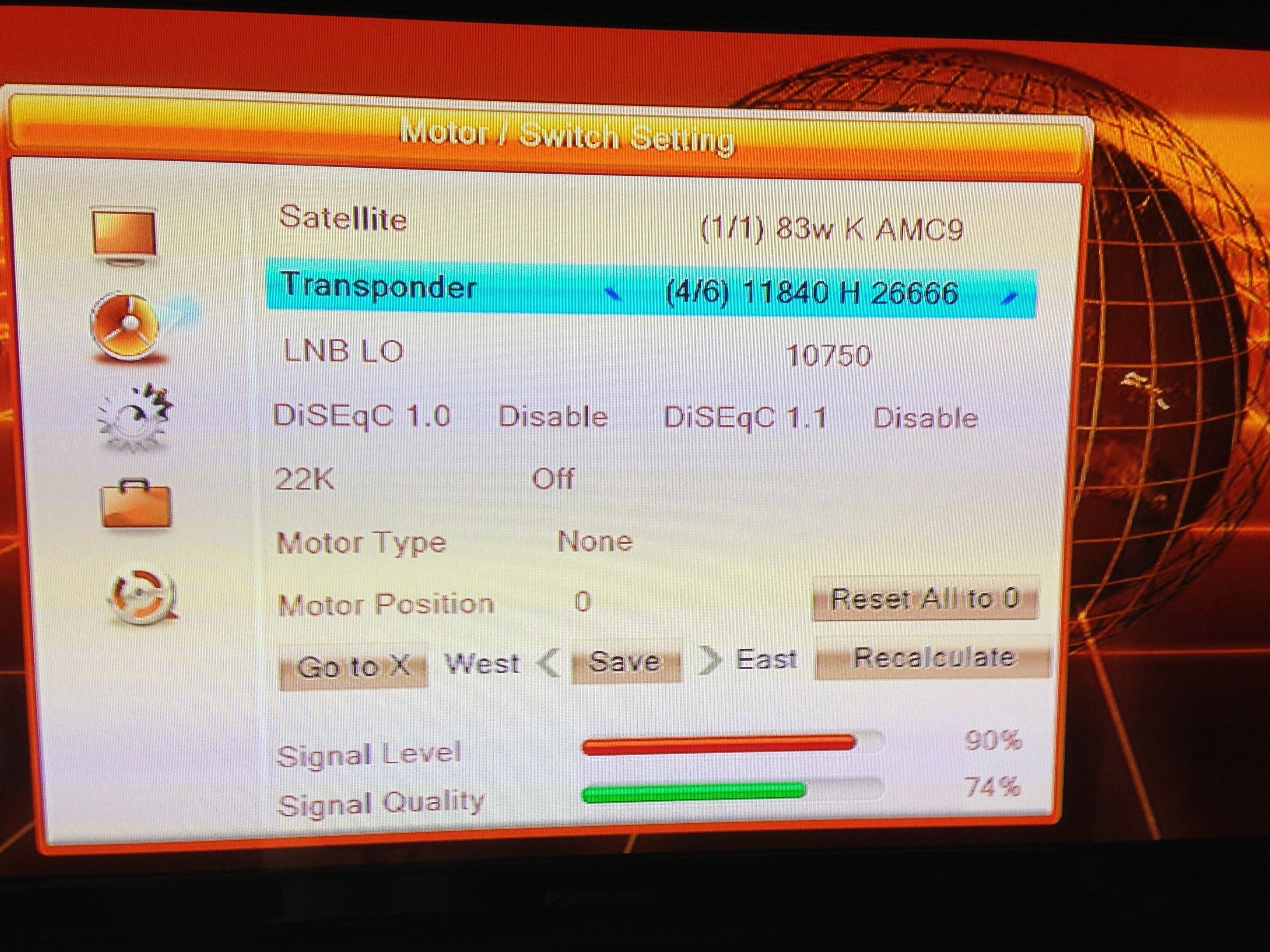

ok look at these 2 pics, why would this happen? shouldnt i have 90% S on all TPs but i get 45 and no Q on some... what am i missing?
I should be on 83 with 73% Q on my Birdog.
Either i been out of the game too long and am messing something up or im having some kind of issue talking to the LNB.

First, is something wrong with your TV? Looks like a bad component cable is connected. Since the microHD only has composite or HDMI, has a primary color failed?
Photo 1: Shows an active DVB transponder locked with correct parameters.
Photo 2: Shows either an inactive transponder or a transponder with incorrect parameter such as symbol rate or polarity.
45% SIgnal Level reading shows connection to a working LNBF that is generating noise or signal. The SL will move above 45% when on active DVB transponder with correct parameters.
no the tvs not broken, its hooked up HDMI and i just did the software update and hadnt put it back on 720p yet, its blue here now
ok so 45% is ok, only thing is i must be on the wrong bird haha i'll move it later
I believe the first tp transmits data and is always on while the second one looks like one of the tp's used for sng and not active at the time you did your test.
:facepalm
ok now i understand why 45% is showing but why is it doing this.... this is how i was seeing russia today this morning on 97, that feed i found on what i thought was 83 was stable but then i moved to 103 and got this same thing on a golf feed.... 105 was getting steady on macys radio. WHAT THE HECK IS GOING ON? microhd, ppl lnb and 36" all from satav so the setup is pretty damn simple.

Unfortunately, with a Birdog you have no idea what transponder you are measuring, but you can be sure that it isn't the DVBS2 8psk transponder displayed on the microHD. The Birdog connection is out at the dish and on a vertical DVBS transponder. The microHD is inside with another length of coax cable and tuned to another polarity and signal type. The S2 8PSK signal requires a much better signal quality to display high bandwidth programming (but this would not explain the problem with RT news). We would be unable to trouble shoot much with this test.
