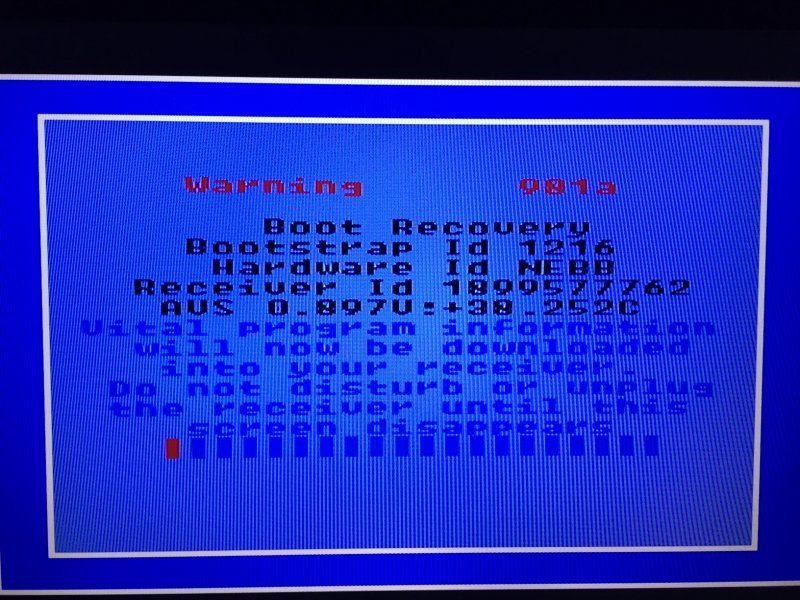

Had this message this morning on one of my HWSs that I believe was updating to S541. My other HWS updated last week.
Receiver has been stuck in this state for 4 hours alternating between 1 red bar and 0 red bars.
Called Dish and replacement receiver is on its way,
I guess that it is just my HWS that was broken by this update. I'll do the power cord reboot when I get home tonight and take it from there. I'll also have to check the other HWS I have.
