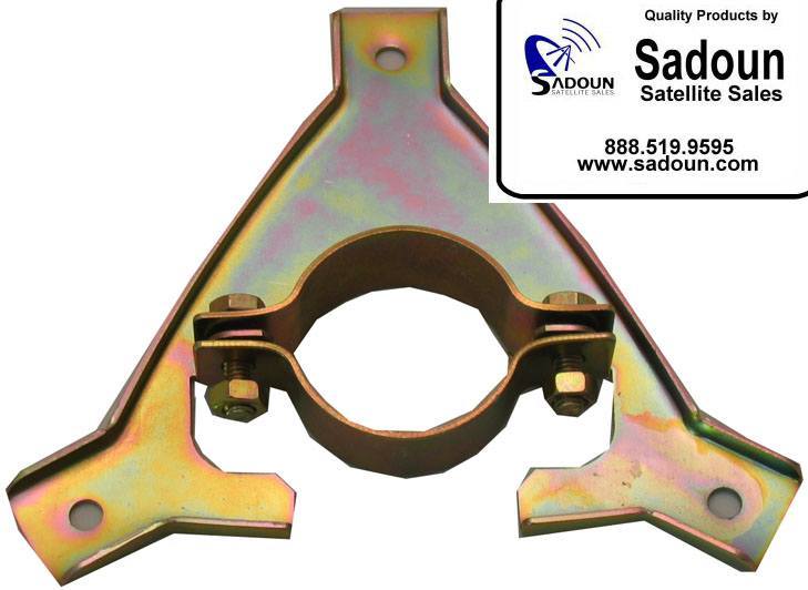

So it would be unrealistc to use the LNBF Collar II and a DP LNB. On a 180CM C/Ku Price Focus Dish Antenna.

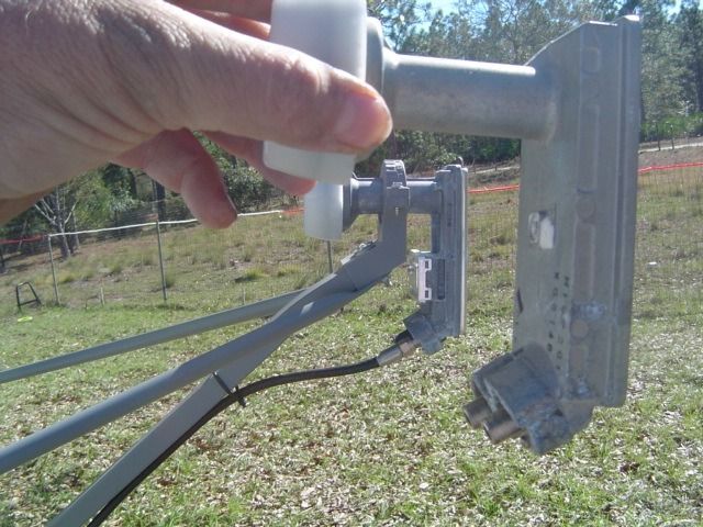

It will likely work, but you will probably have the performance of a smaller dish, such as a 1 meter dish. To get the full performance of the 6 footer, since it is a prime focus dish, you will need to use a separate prime focus feedhorn and flanged DP LNB. The one piece DP LNBFs like the one in your picture have a built-in feedhorn designed for an offset dish.

The flanged DP LNBs are easy to find... Superdishes are being phased out, so there are plenty of parts out there for cheap or even for free if you look around. The LNBF Collar is available from Sadoun for $15. The only part that seems like it might be a bit hard to locate is the ADF-120. Does someone have a line on a supplier of these? I might be interested in a couple myself, since I have the SD180G...
