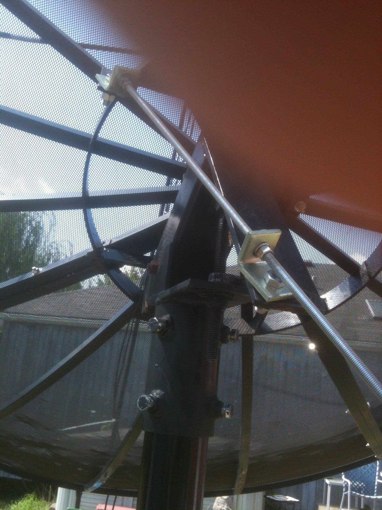

I just got a SAMI 10' dish and I am hoping to aim it at 139w for some audio reception. The elevation for my area is 12 degrees, but the adjusting bolt is too short to allow it to elevate less than around 20 to 30 degrees. Does that sound right for a SAMI dish? The bolt is an integral part of the mount with an eye welded onto the end of it where it attaches to the ring. I think I can extend the bolt by putting a nut 1/2 way on it and using another bolt. A rod coupler would be better but I don't know if I have one that big.
Another question is, if this dish is going to be fixed at 139 degrees, does this mean that the dish itself should be elevated 12 degrees or the mouting ring? I was going to leave the declination setting where it was from the previous owner but he had a dish mover on it, so I'm not sure if the dish or the mounting ring itself should be at 12 degrees? I'm thinking that the declination is only needed when a mover is used. If that's the case I might be able to get enough adjustment out of the declination setting to set the dish at 12 degrees.

This is a sub $10 from home depot. The dish is a 10 foot sami.
