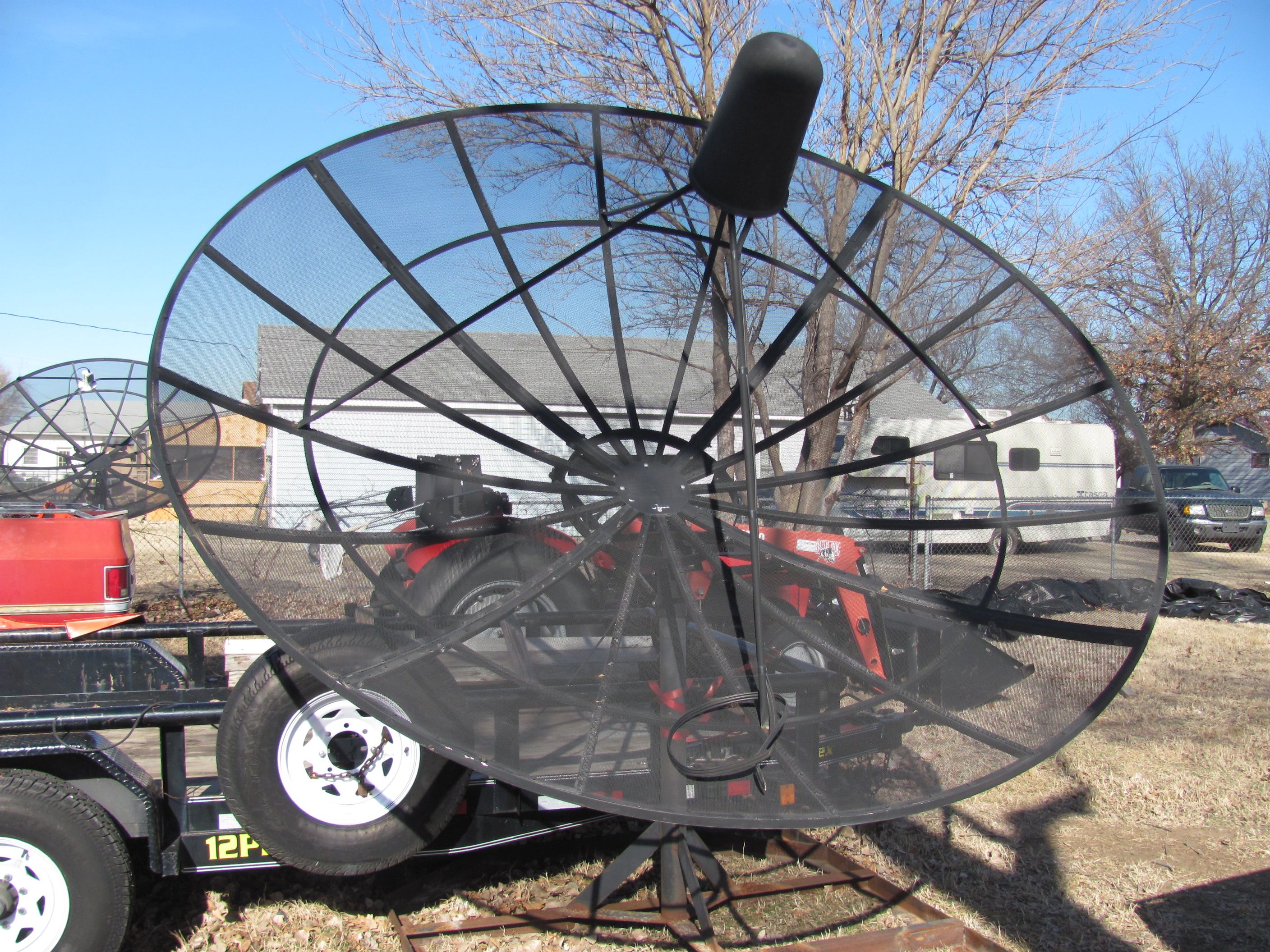

When I stopped at the square to see what exactly I needed to move the dish, I was a bit shocked... The dish looked smaller when it was up on the roof... Compared to the Echostar, the SAMI looked considerably larger! So I got my small trailer and a helper to get the thing moved.
We removed the dish and mount from the non-penetrating roof mount and set it on the trailer. Being that I only had to go a couple of blocks, I drove slowly to keep things from bouncing. Got the dish home and unloaded to the ground.
Went back to the square to retrieve the NPRM. If the NPRM would've been any heavier, I'm not sure we could've loaded it. Got the NPRM home, shoved it up to the 18' trailer and put the dish/mount back on the pole.
Measurement across the dish (lip to lip) is just over 10'... Overall, I think everything looks to be in good condition. Now just have to see how much it cost to take this thing down...

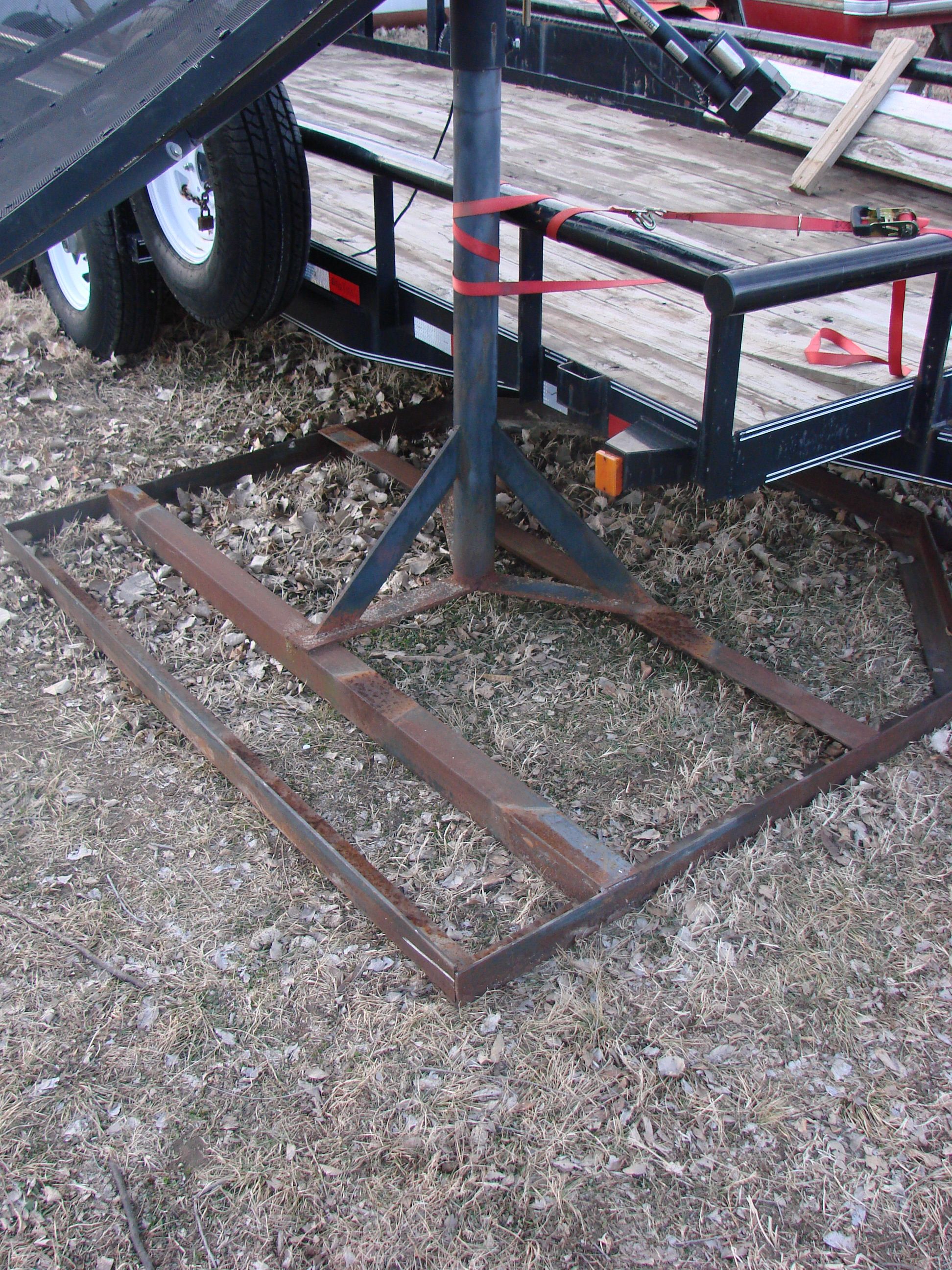

View of NPRM. It's all 1/4" angle and quite heavy.

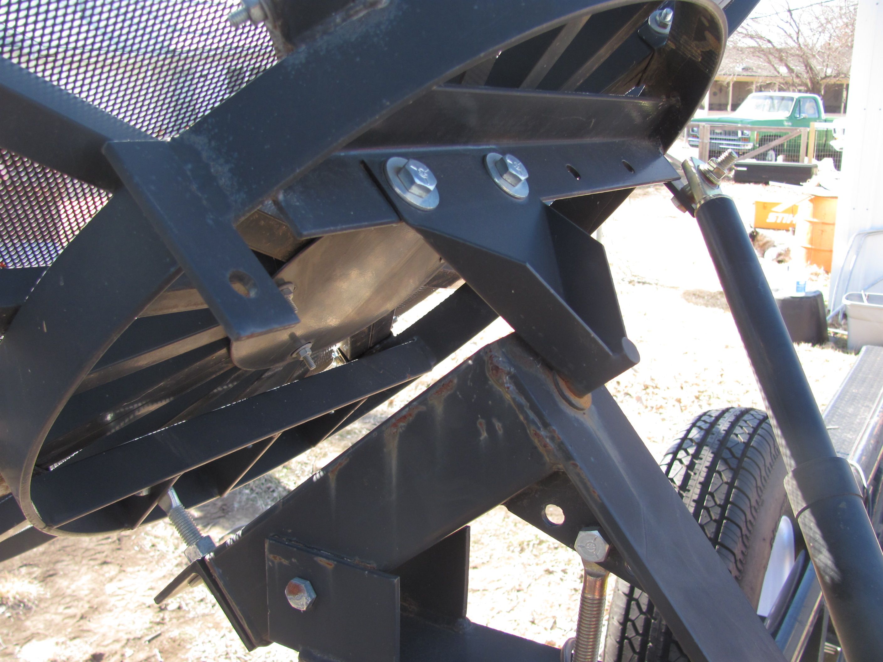

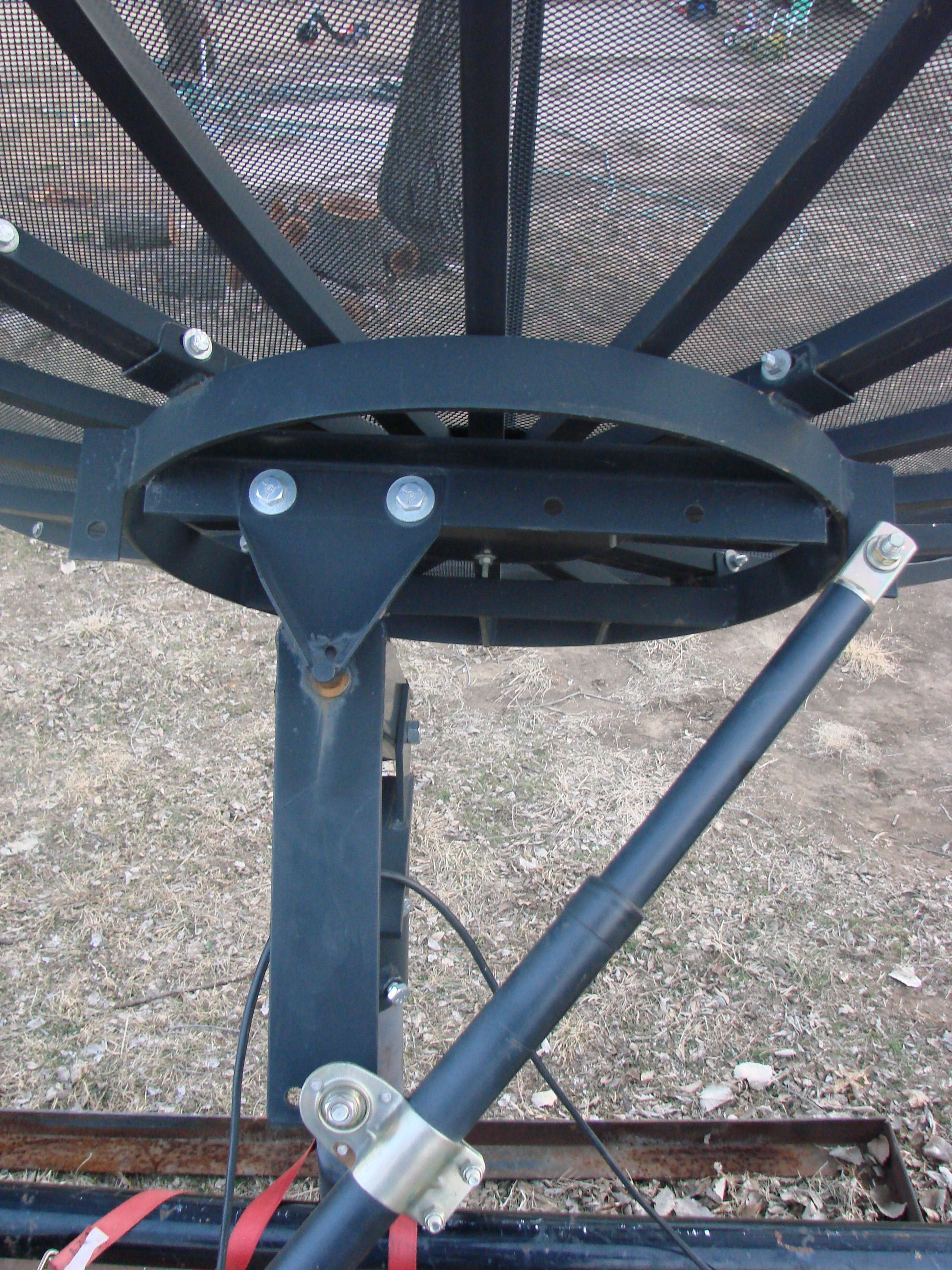

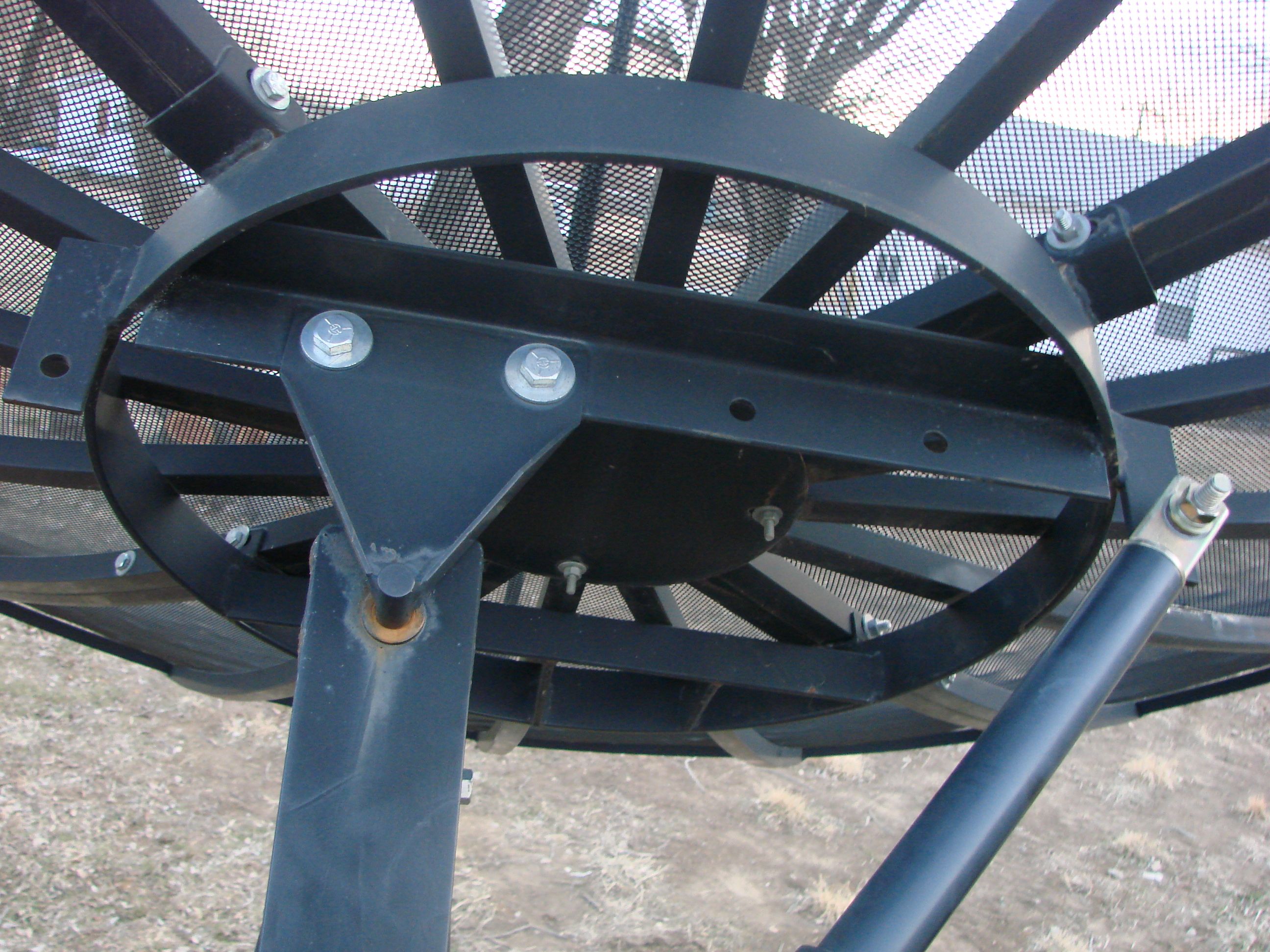

Views of the polar mount. The mount is offset to the east side of the dish. Is this because the actuator is mounted on the west side? Overall, the mount just isn't as beefy as the Echostar mount.

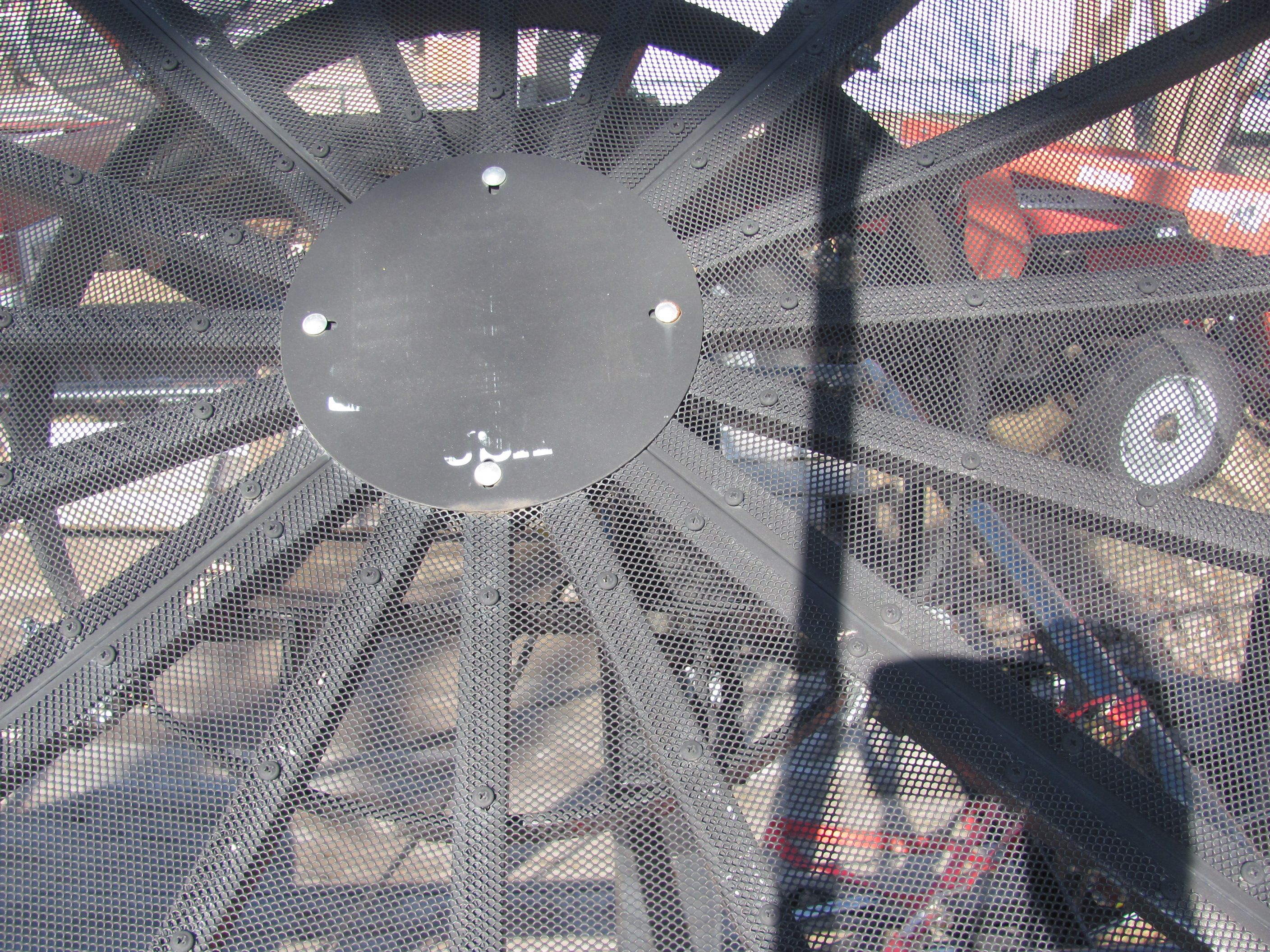

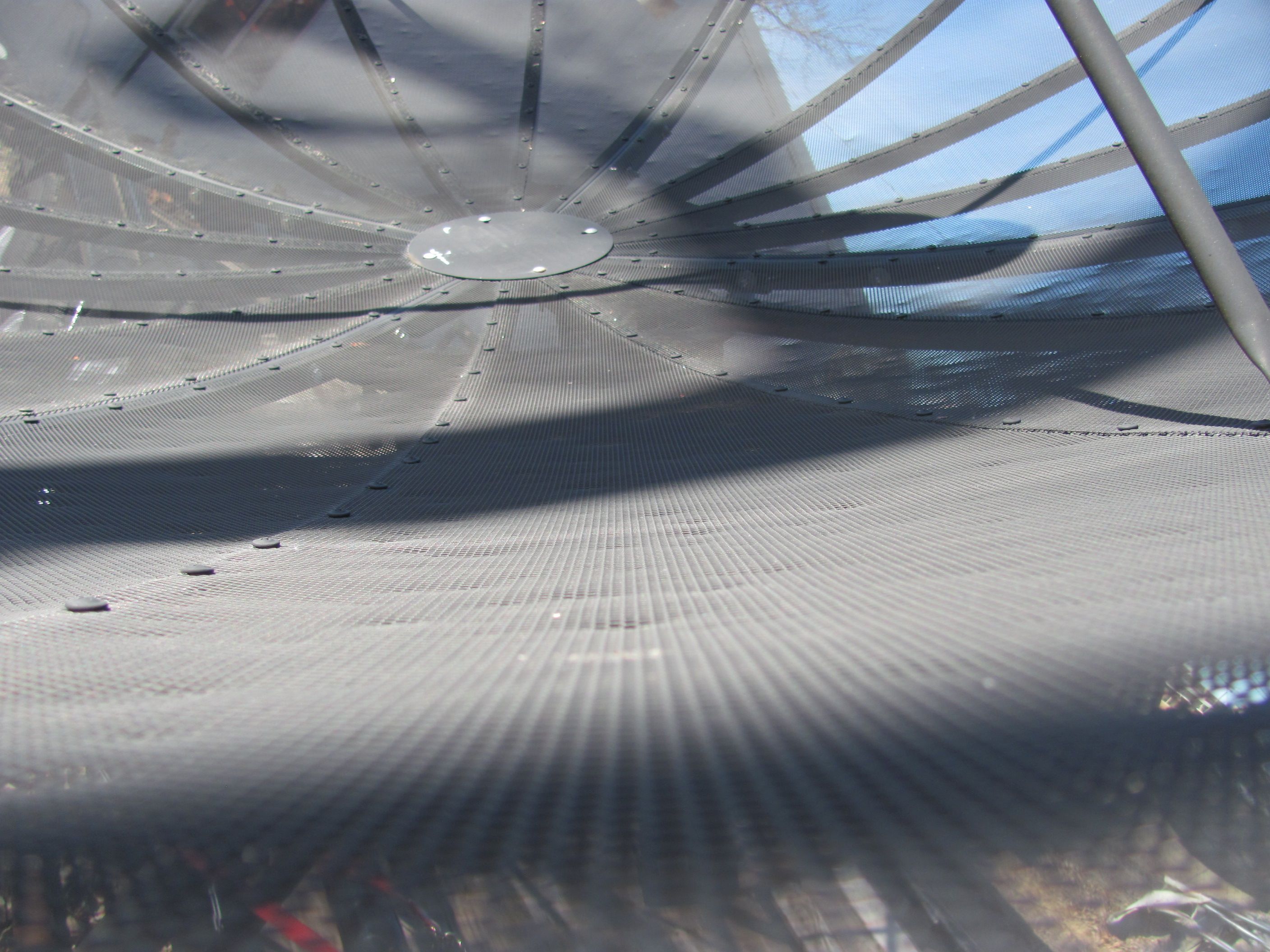

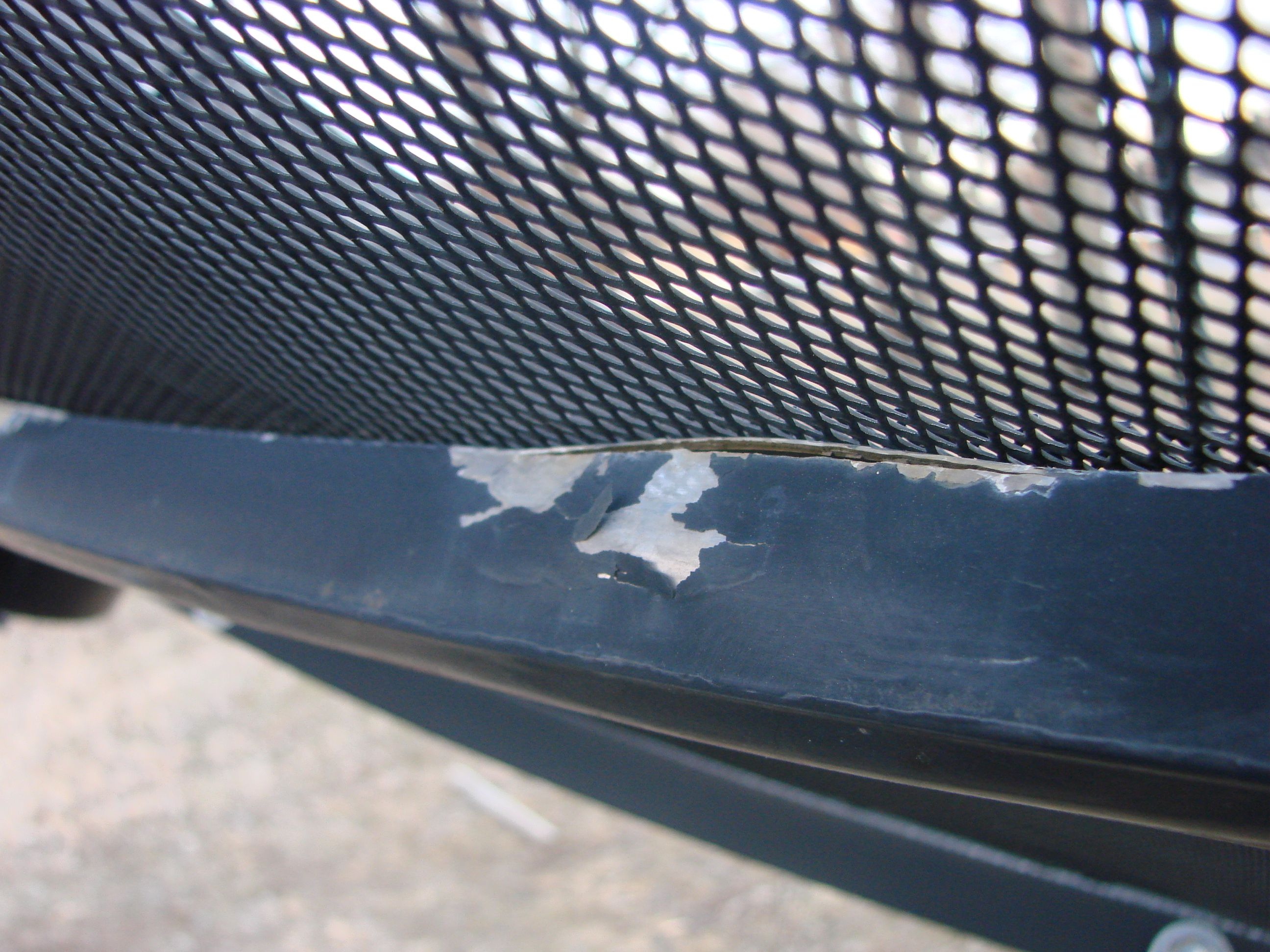

Looking over the dish today, it looks like 'it split a rib'. I presume water got into the rib and froze.

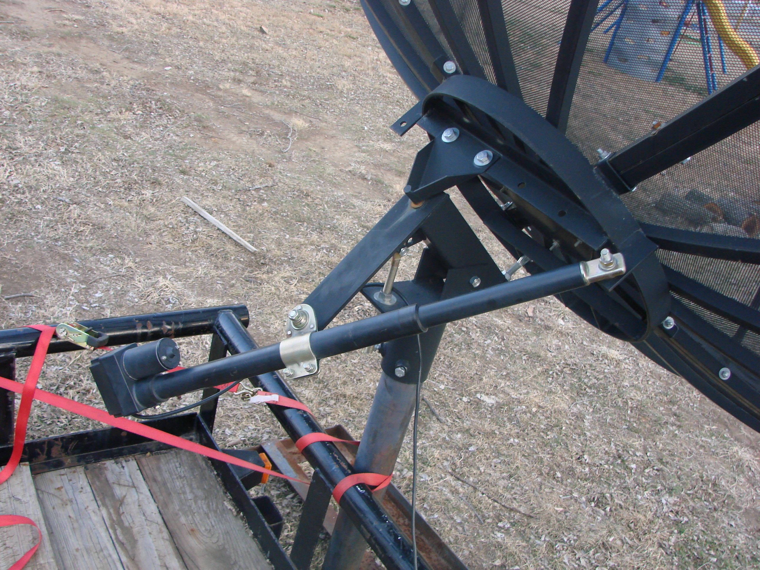

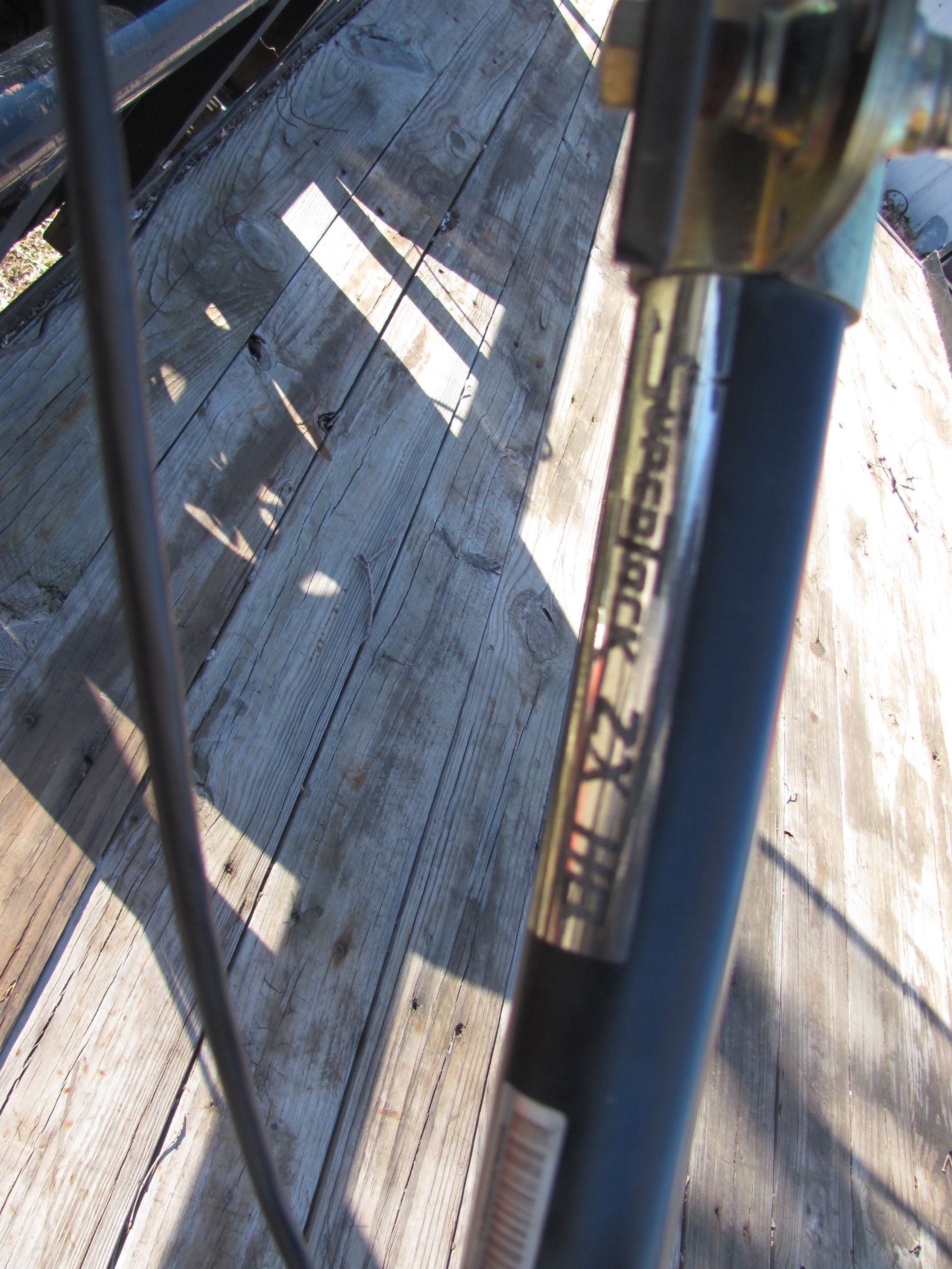

Does anyone have information or advice on the Superjack actuator?

Nothing wrong with a Super Jack mover. That SAMI I had had one on it and it worked fine. Only problem I saw with it was the rubber seal between the inner and outer tube horked up and I had to "improvise" a new seal out of a piece of radiator hose with clamps on it to try to keep the water out. They have a grease fitting on them and it should have instructions on it as to how to lube it.
RE: The offset pivot. I'm going to assume that since it already has been in use in your area that it's mounted on the correct side. If you were to move the actuator to the opposite side then you'd also have to move that pivot mount to the other side as well. The look odd but they work fine.
Lets just hope that the cost to take it down turns out to be "reasonable". :oldwink
Grease it up and it should be ready to go!
Connect the actuator arm on the side of the dish that will have the lowest elevation satellite. Don't assume that an installer knew what he was doing. I have seen some pretty wonky stuff while out on service calls. :)

nice parts Jason. I also hope the bill is reasonable. I rescued an 8 foot dish a few months ago up here in Canada with that exact same style polar mount & superjack actuator. the seller said it was an echostar dish. the superjack was a ball screw type with magnetic sensor so if your is the same it should work just fine with a v/g-box/asc1. I think those early vintage superjacks were made in the usa not like todays made in china. it seemed real heavy duty. heres a link to todays superjack http://www.superjack-solar.com/
