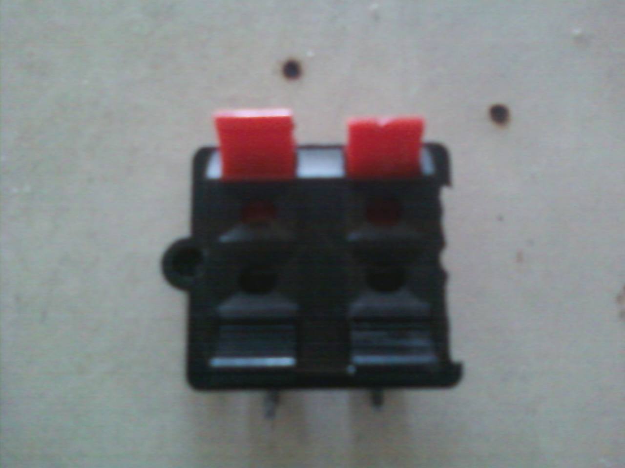

some free advice if you want to learn from from my experience. i've owned and used both the g-box and the v-box. g-box is better than v-box due to 2 reasons. more accuracy due to higher counts and better build quality. v-box and g-box both use motor wire terminal attachments that are spring loaded not screwed down like your 920. however on the g-box the wire terminals are made differently than on the v-box. on the v-box the terminals are in a square pattern two on top and two on bottom. on the g-box the terminals are in a line left to right. look at the back of your v-box and you'll see what i mean. when i inserted the heavy guage motor wires on my v-box 10 the spring popped out and the red plastic terminal popped out also. so once i found them on the floor and put them back in carefully they were still loose and didn't hold the wire snug. the terminals can be pulled out by hand and this you shouldn't be able to do. loose terminals means loose wire connections and that is never a good thing. so when i took the v-box apart i found out the manufacturer had cut off the right side screw attachment part for the whole wire terminal assembly block. here's a pic of what i mean
so stupidly now the whole block is only attached by one screw. look at the back of your v-box and you'll see what i mean. there was no good reason to do this other than it saves the chinese the cost of drilling another hole and another screw. so after ditchin that cheaply made piece of crap in the garbage i got a gbox. the wire terminal connection block is made differently so the wires are held snugly. also the terminals and springs cannot be pulled out like the v-box and trust me i tried.
Appreciate the info but to date I haven't had any issues with the Vbox X. Don't know how your wire connector was fastened in but mine is soldered to the PC board and doesn't even have a screw in it. Having read about this potential problem before I bought mine, I did exercise caution when inserting the wires in those terminals though. Since this isn't something that is done daily I really don't see it as a problem for me at this point and if it does mess up then I'll just take those wires running down to that PC board loose and connect them to a regular screw type terminal strip I'll mount on the back, which is how both brands should have been made in the first place.
Counts per inch hasn't been a problem yet either and if it does come to that then that junk SuperJack actuator that came with that SAMI will come off and I'll put on one of the VonWeise setups I modified with 60 counts per inch. That should be enough for most anything I'd ever do. To date the 21 sat locations I've recorded are still the same as I've "peaked" a couple since I originally found them and they are still right on the same number.
I guess the bottom line for me is that I'm retired, on a fixed income and have too many expensive hobbies so I do cut corners where I can and for the price of this Vbox X, I can almost buy two of them for what one of the other brand costs. So sometimes cheaper is better, at least it is at my house. ;)
Here is a pic of how my Vbox X is made and there is no screw on the outside of the case coming into that one location one might be inserted.
