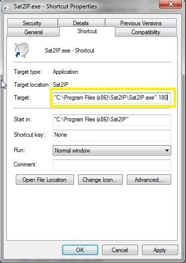

1. You can set the sleep timer in two ways. #1, you can select the sleep timer option from the menu and choose your time.
2. You can create a new shortcut to the program, modify the properties and after the Sat2IP.exe add a space and then the number of minutes until you want the shutdown to occur. Then, all you need to do is launch that shortcut, and it will default to that time specified.
