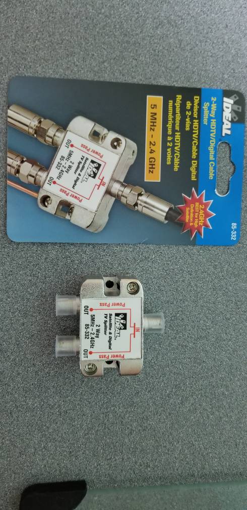

I have this satellite splitter. It passes voltage to an LNB if a receiver is connected to the OUT port and LNB to the IN port. It doesn't pass voltage if connected the opposite way.
I discovered when I tried to connect two LNBs to one receiver and it didn't work. So it seems to be for connecting two receivers to one LNB.
But if two receivers are connected, won't this pass voltage from each receiver to the LNB and fry something? If it will work, I just want to have two receivers both working beside each to compare performance.

Correct. Diode protected only allows power to pass in one direction. The diagram on the switch will often show the power pass direction and/or the passing leg.
Combining two LNBs to one STB is HIGHLY unusual and without proper phasing and reference from a single timing source, this would not provide a useable signal.
you probably want to stay away from splitters and combiners in the context of satellite reception. Because receivers typically use voltage to control the LNB, they would conflict and you could indeed risk frying something. And like Brian just mentionned, combining 2 LNBs would not be so easy. And combining 2 LNBs pointing at 2 different satellites or 2 different bands would just end up mixing signals into an unuseable mess.
Edit: now after reading the other thread I realize that this is maybe about the attempt at running parallel switches as A33 described. So the comments above might no be so relevant.

3. Parallel receivers need indeed protection in the splitter: the positive current of the one receiver must not reach the F-connection of the other receiver.
The diodes in your power pass in one direction splitter do exactly that.
The receiver with the highest voltage 'wins' (so 18 volt wins over 13 volt), and 22kHz ON wins over 22kHz OFF.
Theoretically if both supply 22kHz, there could be interference of the two 22kHz signals, causing the 22kHz to extinct. But in practice, I don't believe that happens (or very very very rarely), I've never seen it reported in a forum.
For running two receivers parallel simultaneously, you could also use a splitter/tap with power pass on one port, and power block (capacitor) on the other port. They are also available (see internet).
In that case you have one fixed 'master' receiver, and one fixed 'slave'.
A sat priority switch (master/slave switch) is also available, for running two receivers NOT simultaneously.
Usually they will work also when the two receivers are both ON simultaneously, but then the slave port will have relevant dB-loss (as there really is diseqc-like signal switching going on inside, with PIN-diodes, it seems). You can also find those on the internet.
Alas on many simple splitters, there's no clear indication or decription if they are power pass or power blocked.
Usually splitters with indication '5-1000 MHz' are power blocked here in Europe, but not all! With other splitters meant for several purposes, it isn't clearly indicated either.
So I need to measure them with a ohmmeter, to know what I've got...
