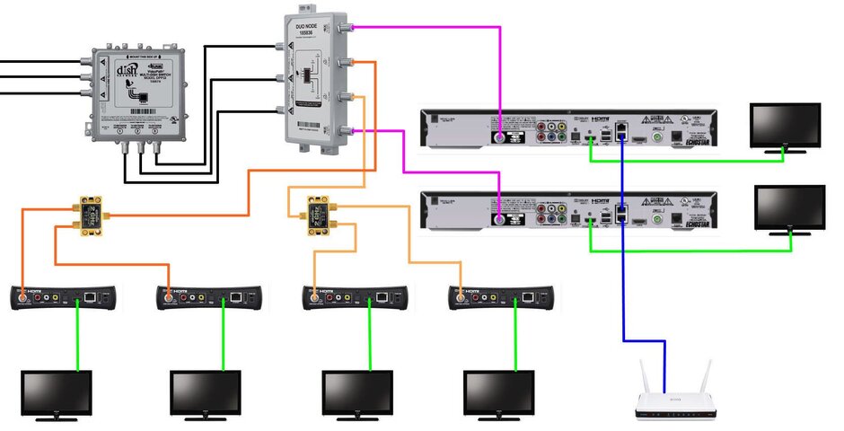

--- a friend pass me this diagram, since he doesn't have any of the hoppers/joeys, i need to be sure this is correct ---
Looks good, but I would get rid of the switch, no reason to keep it in there (that I can think of) it just gives you another point of failure. :)
--- you meant the DPP33 switch? - i got 3 separate dishes in PR with DP lnbs, since we can't use the same lnbs as continental USA - can i connect those lnbs directly to the node? ---
Sorry I didn't realize you had 3 separate dishes. In that case I would keep the DPP33 switch. :)
