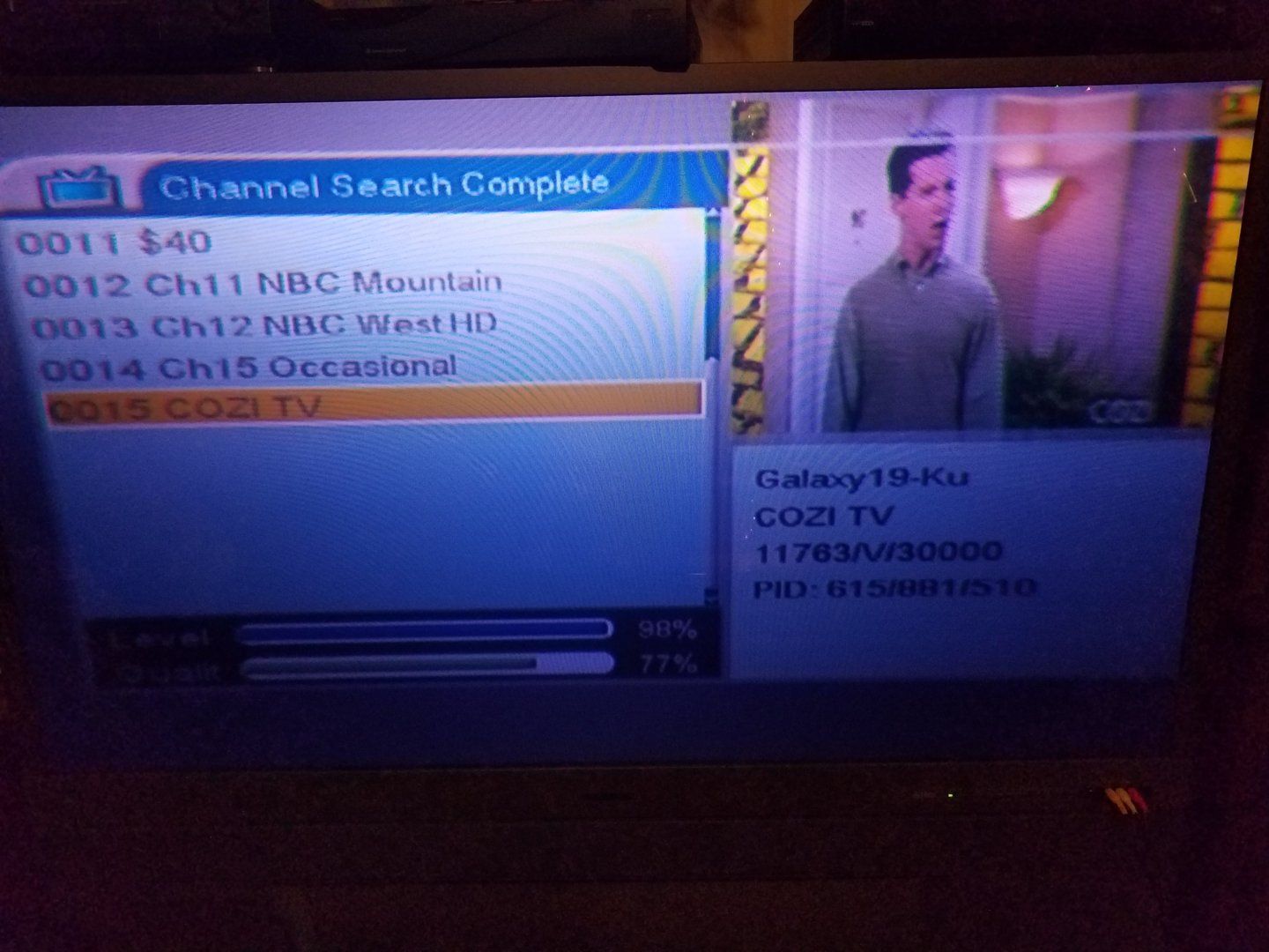

After setting up the Invacom Quad QPH-031 I got a few channels. Look at the picture below. It is pretty obvious what I need to do, but it's raining. (The dish is pointing at SES 3 at 103.0°W instead of Galaxy 19 at 97.0°W ) I need to turn the dish a little to the east and slightly raise the elevation.
Reactions: raydio and FTA4PA

Everything is pretty much back to normal, although I am not getting as many channels on Galaxy 19 as I did before. This is confusing. With my old LNBF blocked by trees, I was pulling in over 200. Now after clearing the trees, the channel count is around 160. Maybe just a more sensitive LNBF? Or maybe the LNBF that I am using (Invacom QPH-031) is the reason. No big deal though, as my wife can watch all her Thai channels again.

Doorguru, on 97W I scan in about 159 TV channels. So your 160 channels may be fine. When you scanned in 200, I'm wondering:
1) Are there duplicate channels? Sometimes channels can get re-scanned with slightly different frequency or symbol rate. The receiver thinks they are different channels.
On a good weather day when signal is strong, delete all transponders on 97W then blind scan.
2) Is it possible you are also picking up the very strong transponder from 99W at the same time? It is on 11800 and contains JBS and many scrambled Russian channels. With my offset LNB, I pickup both 97W and this strong tp from 99W without moving my dish.

Thanks! I never thought of that! Just because I detected that many channels, doesn't mean that I can view them. Happy to hear that 160 channels is about right for Galaxy 19. Just cut down 10 more bamboo trees anyway. Who knows? I might get motivated and clear the horizon for my 12' dish!
