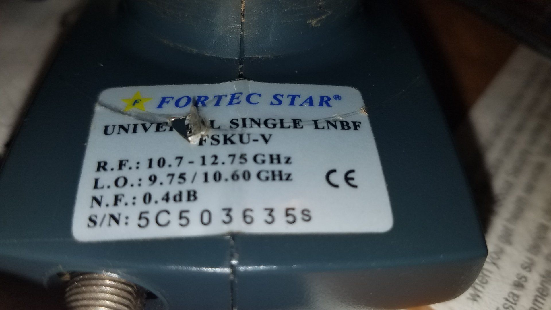

Let me back up a little. I have given up on my old LNBF.
I am trying to use a Fortec Star Model FSKU-V
Here is the label on the LNBF:

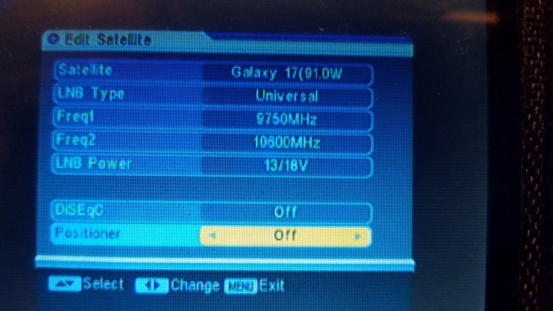

Here is how I set up my Tuner to try and find a signal:
Are my settings correct?

Yes, those are the correct settings.
Except for the fact you are on 91W. You need to set up as universal on 97W. I will add I suggest you use 12152 H 20000 as the transponder info to align the dish.

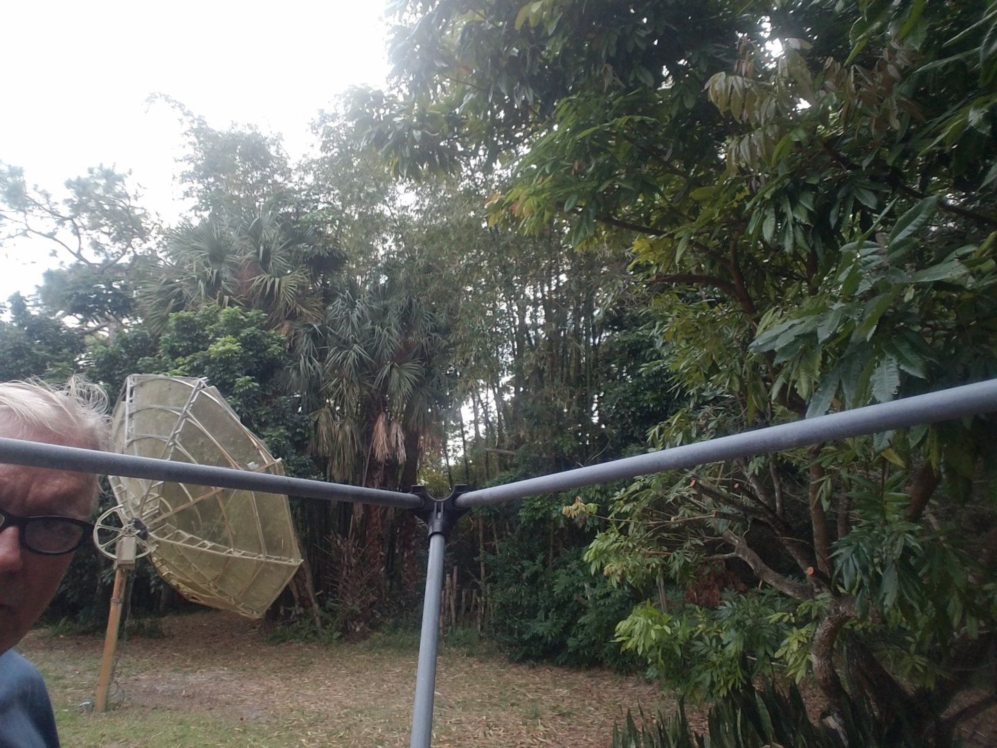

It may be time to drag the receiver and a small TV out to the dish and and double check the dish is still on as well. The way you speak though you may very well have to have some trees removed or move the dish. No matter what LNBF you use, none will work with a LOS issue. :)

Yes my example was on the wrong satellite. :oops:
You have given me some good info! Thanks!

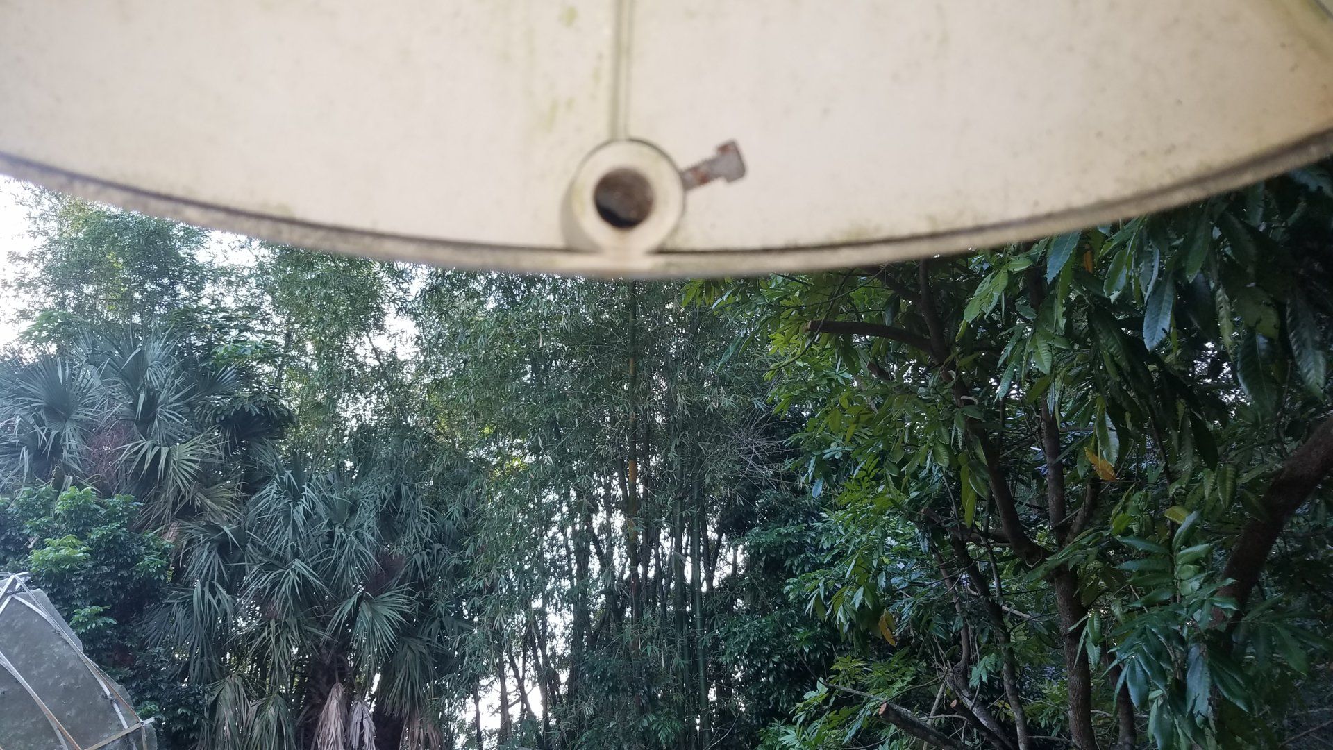

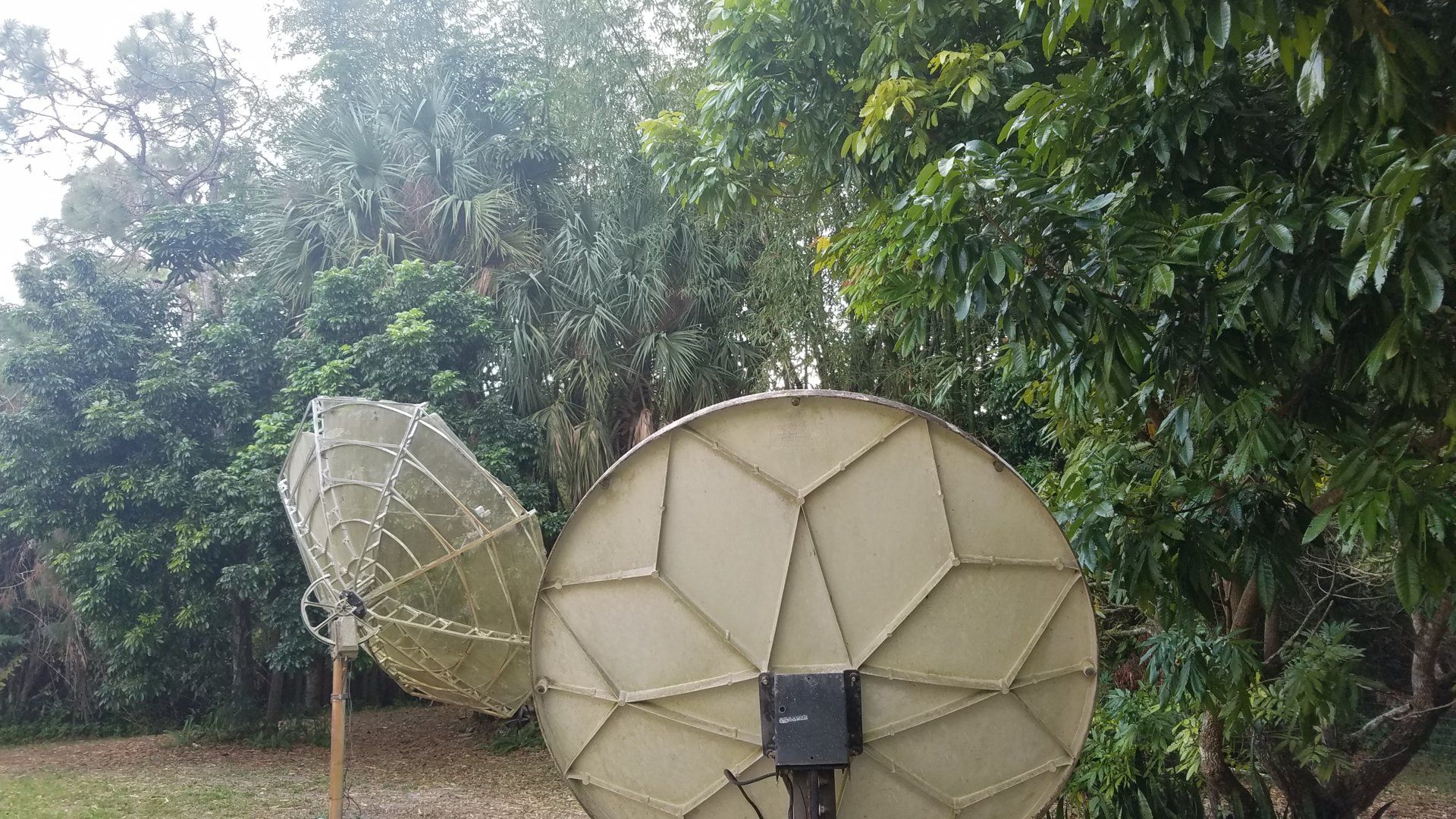

I know what you are going to say, but until a few days ago, I had a strong signal.
There is no hope for the 12' dish, but I think I can clear a path for the 1.2M dish.
30 years ago, the horizon was clear. The bamboo started with one tiny sprout.
No where else in the yard can I relocate the dish.

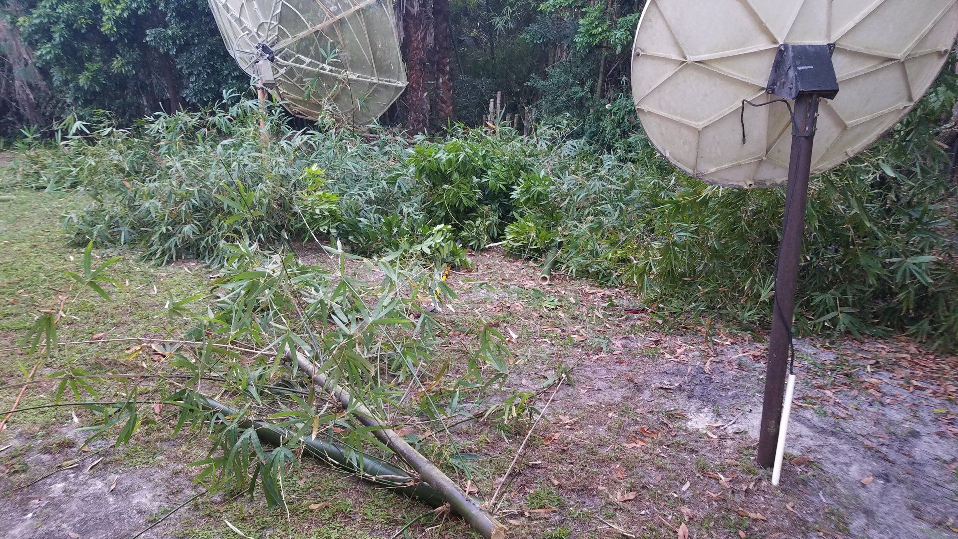

The cutting has begun !

That bamboo is so aggressive. I remember a thread here where one of the members had a horrible battle with that stuff. I will post the link if I can find it. Good luck on clearing things out enough to 'see' the satellites.
Reactions: raydio
Thanks! I will keep at it and post my progress.
