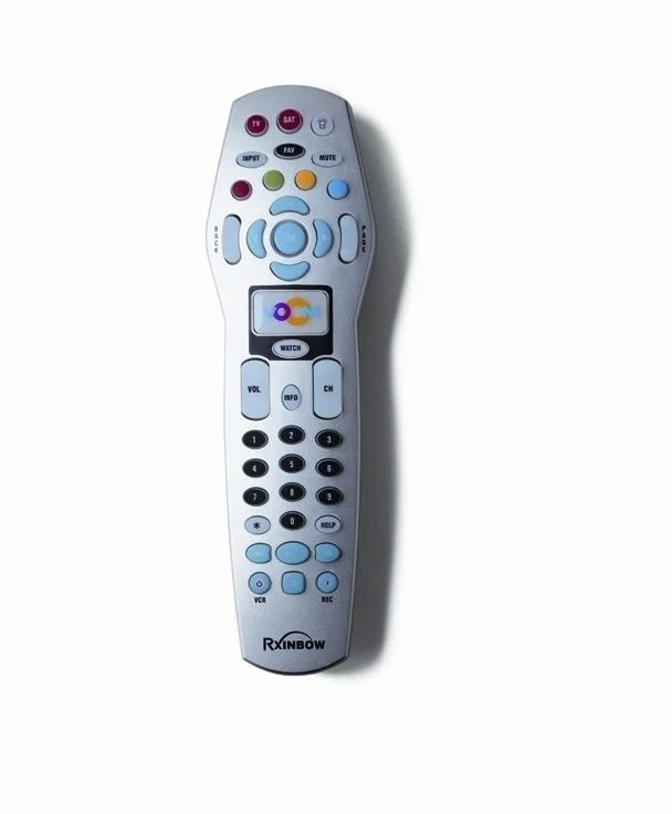

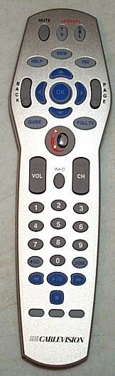

The reason the VOOM remote sucks is because it is the identical remote Cablevision uses for its Digital cable service (named iO). Here are two pictures of the remotes one from VOOM and one from iO. You can tell these were done on the cheap.
If there is one thing Motorola can build; it is remote controls. Star Choice uses Motorola remote controls for its service for practically the same set top VOOM uses. Why VOOM chose to not use a good Motorola remote is beyond me.
