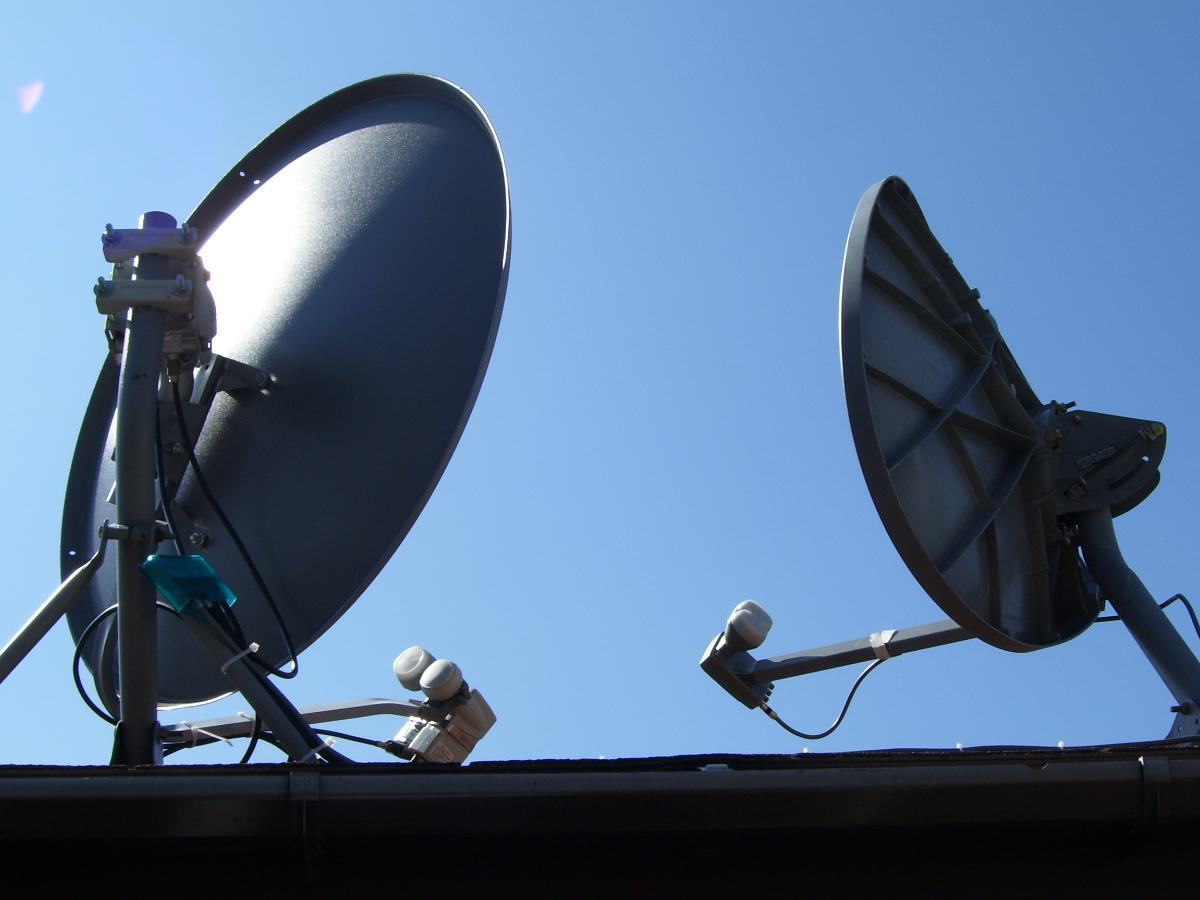

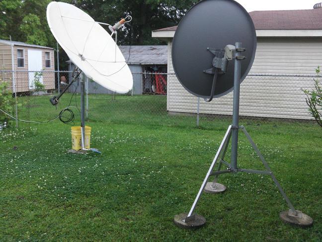

A couple different setups when I had 30W in Minneapolis
1st batch is a Channelmaster 75e dish (normally for Shaw Direct)
2nd batch (because the trees grew) was a 36" dish on the TV aerial mast :)

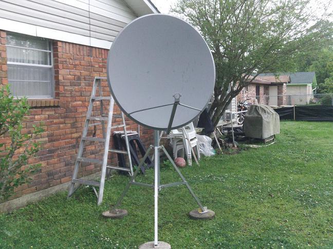

Anole,...I have just finished assembling the freeby dish and motor, mounted it on a home made tripod, need to weight it down with some sand bags or bricks....Right now it is pouring rain again, when will these April showers stop?...Took some pictures of the setup, will send/show them later on today.
I hope the dish is pointed high enough to clear the tree top leaves and capture the 30W satellite, and I will get a chance to point the dish toward the 30W satellite soon and find out one way or another if this is worth all this effort. LOL!!.

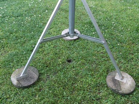

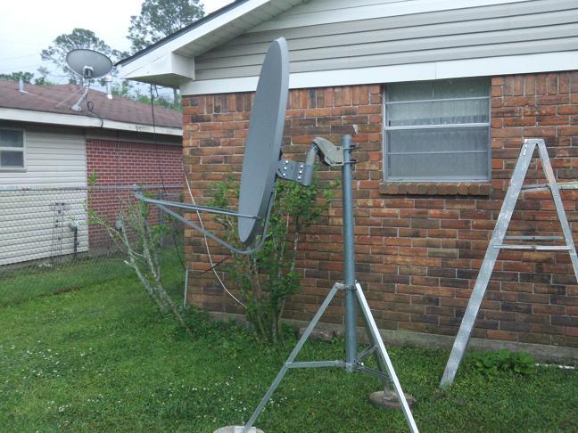

Here are the pictures as promised, notice that the tripod needs a whole lot of weight on the feet area to keep the dish from tumbling forward....As soon as the rain lets up, and the ground dries a bit, I will give it a try to look/find the satellite.

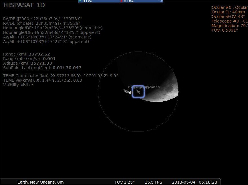

If you're an early riser and the sky is clear this saturday hispasat will eclipse the moon at your location at 5:18am(according to Stellarium)hispa slidell.jpg
